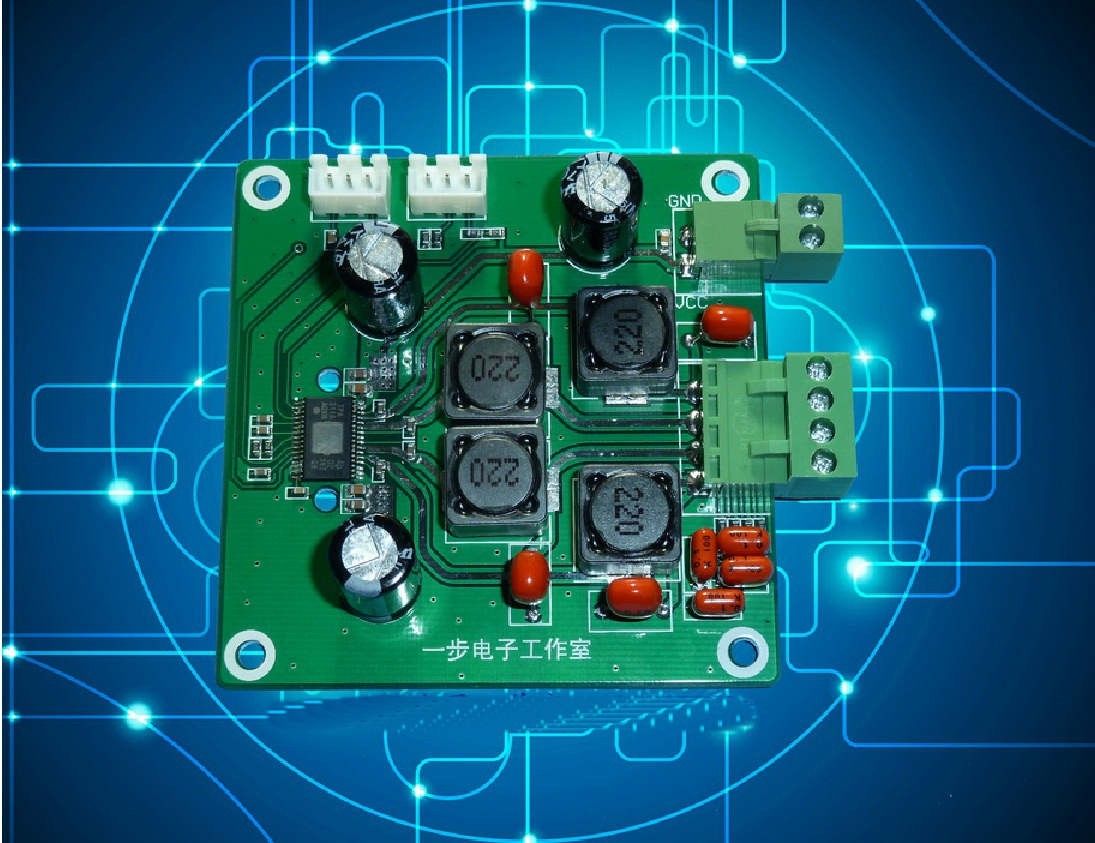

I have made MODSEL.AM(2:0) selectable using jumpers.
Please clarify what you mean by different designs?
You can have one pcb and try all sorts of different components to do your evaluations.
Some designers go for the smallest board they can come up with. Some think it is not necessary
Some like ferrite bead in the output instead of the typical inductors
Some prefer shield sm inductors, some like regular coil on a core
Some said big caps are essential for good sound while others are happy to use smaller size caps.
Different components would affect the layout of the board.
The board does not have to provide flexibility for different configurations, just the "most optimal design" as perceived by the designer
performance?
Sorry. I mean performance of the board/amp, not the chip.
Hum, so how would that work out? The only costs that I would have, out of pocket would be pcb fab and comp costs, the same as everyone else, wanting to build one. Where the savings can be realized, are in the one time (NRE) pcb setup fees.
That is the idea. Since in the beginning, someone come up with a design but could not afford the initial investment on making the first PCBs. So if there are resources that will cover the expense (including set up fee and the first lot), the designer can move forward and build the amp with his designed board. Mind you the designer still has to pay for the parts and build the amp. But he owns the amp. His contribution will be circulating within the group of the funding member.
I will clarify, that I will give my implementation away for free, for none commercial use or profit.
I do not think anyone on this thread is interested in taking any designs and make money out of it. We all have day jobs and this DIY thing is just for fun. However, it would be difficult to stop anyone outside of our community to exploit it.
