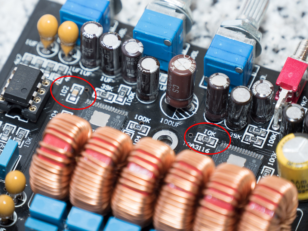

Hi, today I’ve got my first TPA3116 board, the dual chip XH-M190 v.3; it was configured in the master/slave mode, with 26 dB gain for each channel.
The SYNC pins of the two chips were connected via a R-C with the wrong values (10 Kohm and, I suppose, 1 nF) so the sync signal at the slave side was near to zero.
The master chip was switching at a frequency of about 400 KHz and the slave frequency was just above 100KHz, so the two was not synchronized.
I’ve got synchronization (both the chips at 400KHz) simply removing the 1nF capacitor (C41 in TI datasheet, fig. 37), and leaving the resistor at 10 Kohm.
(note that removing a component is easier than replace two SMD components).

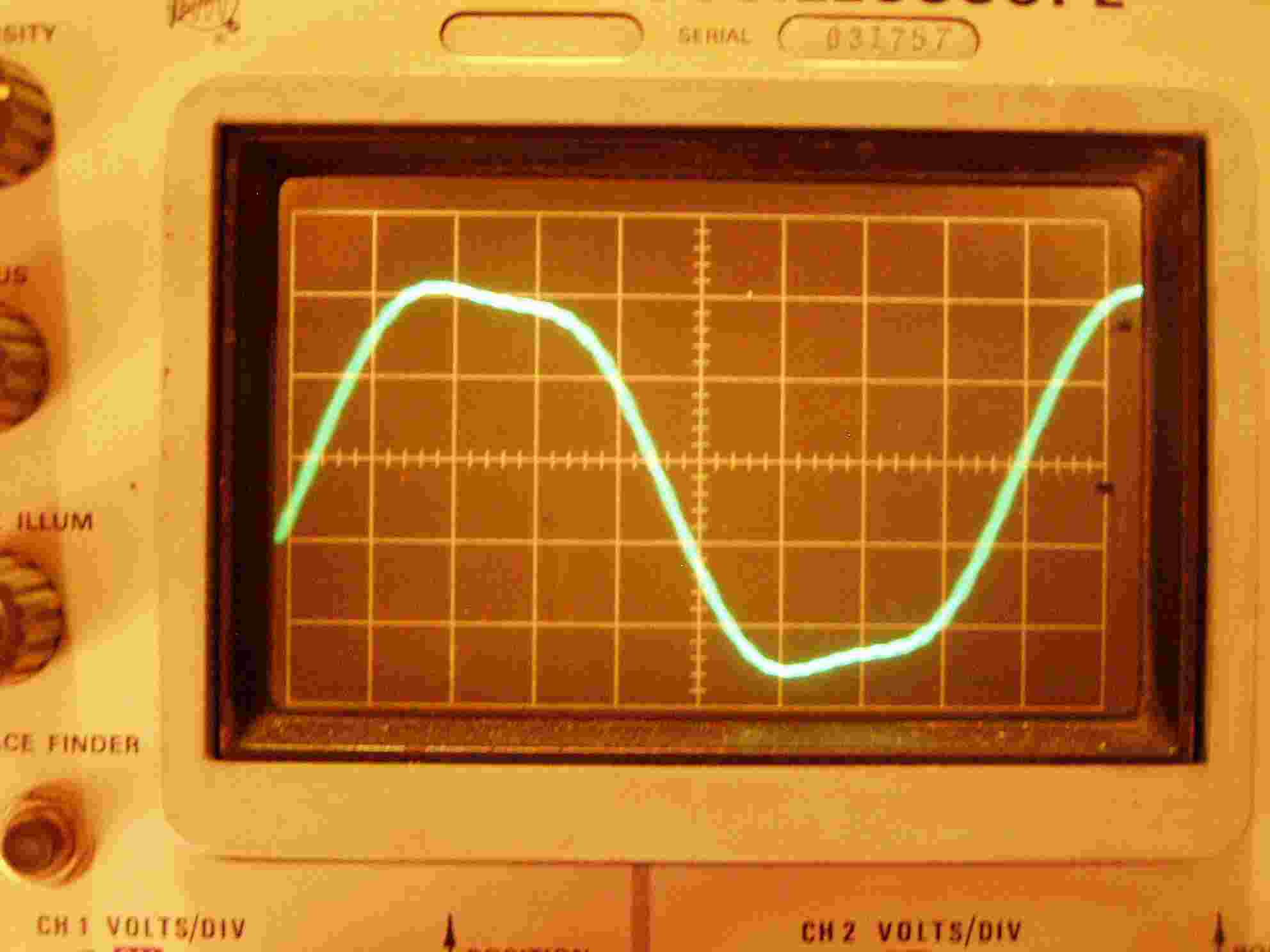

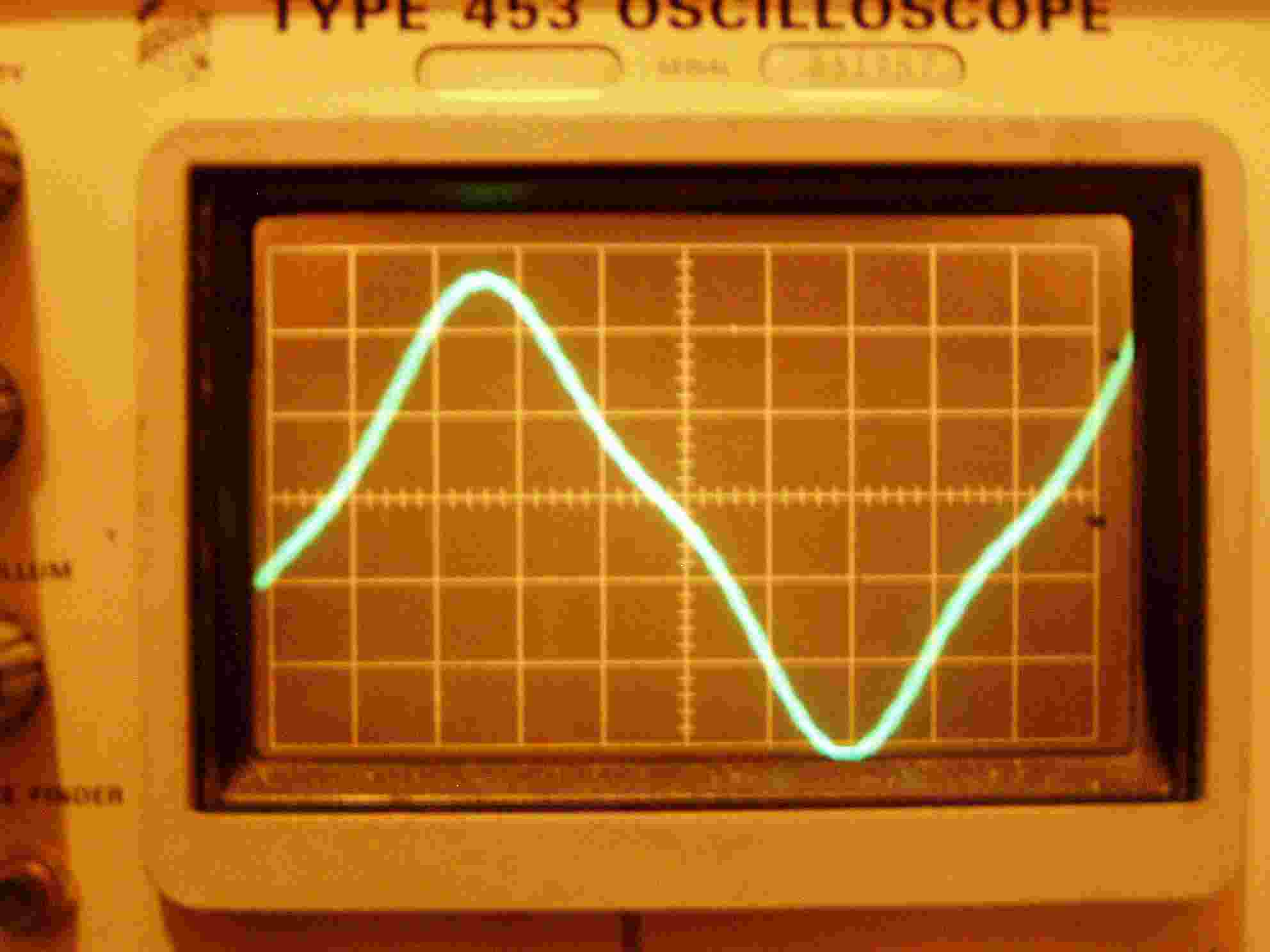

Then I started to test the two channels of the board, using a sine wave generator and an oscilloscope, connecting the probe between ground and one of the BTL output.
The slave channel was regular, but the master was not, showing a strong distortion when the signal frequency was between 9 and 12 KHz (see the attached pictures, showing the two BTL outputs); outside this frequency interval the waveform was good; power supply was 20V, load was 8 ohm for each channel, output power was about 10 W.
Moreover, the master channel frequency response showed a peak of about 8-9 dB at 33KHz, that is the resonant frequency of the output filter (33uH and 0.68uF); the peak of the slave channel, approximately at the same frequency, was much smaller (1-2 dB).
Can anybody explain this behavior?

I don't know what's going on, but I doubt connecting scope ground to one of the outputs is the right way to go. Connect it to power ground, probe one of the outputs.
It's what I've done; the two pictures are the voltage of each output referred to ground.
The voltage across the load is the difference between these voltages; I wonder if this difference could be a sine wave; later I'll try with two probes and using CH1-CH2 on the scope.

Exactly like mine; one chip is set as master and the other as slave; but to get the slave synchronized with the master, a clock signal has to be transmitted to the slave and this is made through R13 and C33.
Unfortunately, the values of these components (10K and 1nF) are wrong, so the slave doesn't receive a valid synchronization signal and works completely out of specification (switching frequency of about 100KHz), with a very high ripple at the output.
As stated by TI, the correct values should be R13= 4.7K and C33= 47pF, but in my board I got synchronization simply removing C33 and leaving R13 at 10K (a very simple operation).
I really don't know if synchronization can improve the audio quality, but for sure one chip of your board is working now in a non-standard mode and the output filter is suffering for this.

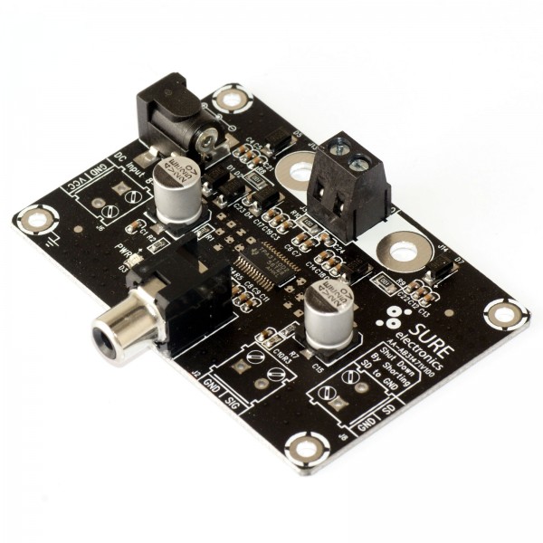

TPA310 1x30W Amp
Does anyone have any experience with Sure's TPA3110 1x30W mono amps? A link to Sure's site is given below:
Sure Electronics' webstore 1 x 30 Watt Class D Audio Amplifier Board - TPA3110
What I actually want to do is use two of these as monoblocks to power a pair of FE126EN speakers. Would replacing the power caps be a good idea? I know that on the TPA3110 2x8W board, many suggesting replacing the caps with Panasonic or Elna 470uF/25V caps.
Any suggestion, including other mods would be greatly appreciated.

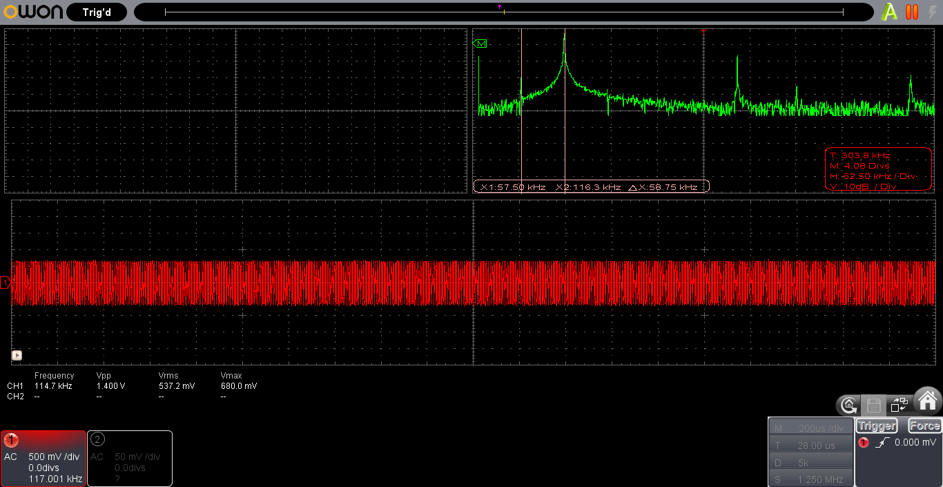

I had the opportunity to do a FFT on my sub channel and, while not audible in my subwoofer, there was a lot of noise past the audible frequencies.Exactly like mine; one chip is set as master and the other as slave; but to get the slave synchronized with the master, a clock signal has to be transmitted to the slave and this is made through R13 and C33.

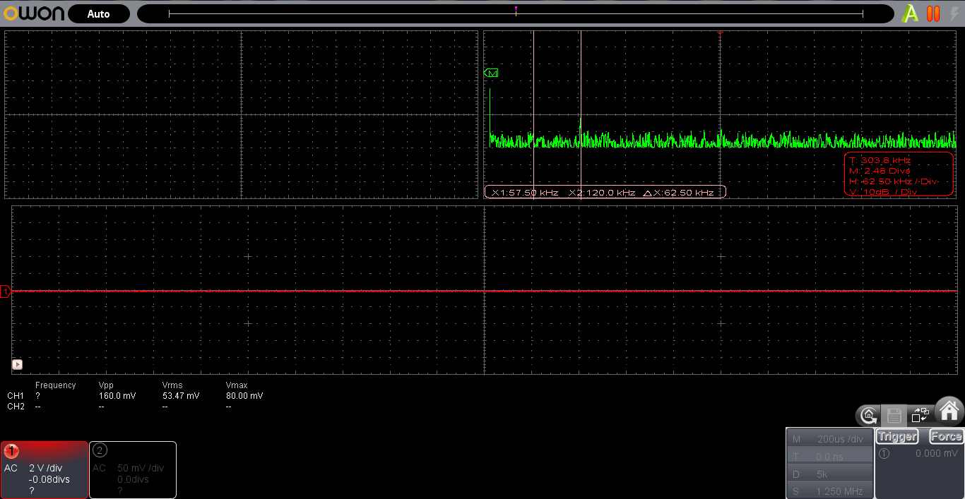

Here are some images (before/after).
BTW, 10K+1nF is what datasheet says.
The values in datasheet are wrong; look at the TI answer in post 3440 of this thread.
In the first picture you posted, I can see a strong line at 116KHz that should be the switching frequency of the slave not synchronized; after modification, I should expect this line move to 400 KHz, but I can't see it; maybe it is under the noise floor, thanks to the greater attenuation of the output filter at 400 KHz.
Since you are able to perform FFT analysis, did you ever try to measure distorsion of the output signal?
I'm trying to do this using an old analogic selective voltmeter, but first results are showing a distortion higher than 1% , at 10W output power.
If somebody is interested, I can post the results of the measure.

Yes, the filter does a great job (@400KHz, not tuned to 100KHz...).
In another TDA3116 stereo amp I have, the 400KHz line is much more visible.
No, I haven't tried to measure distortion.
