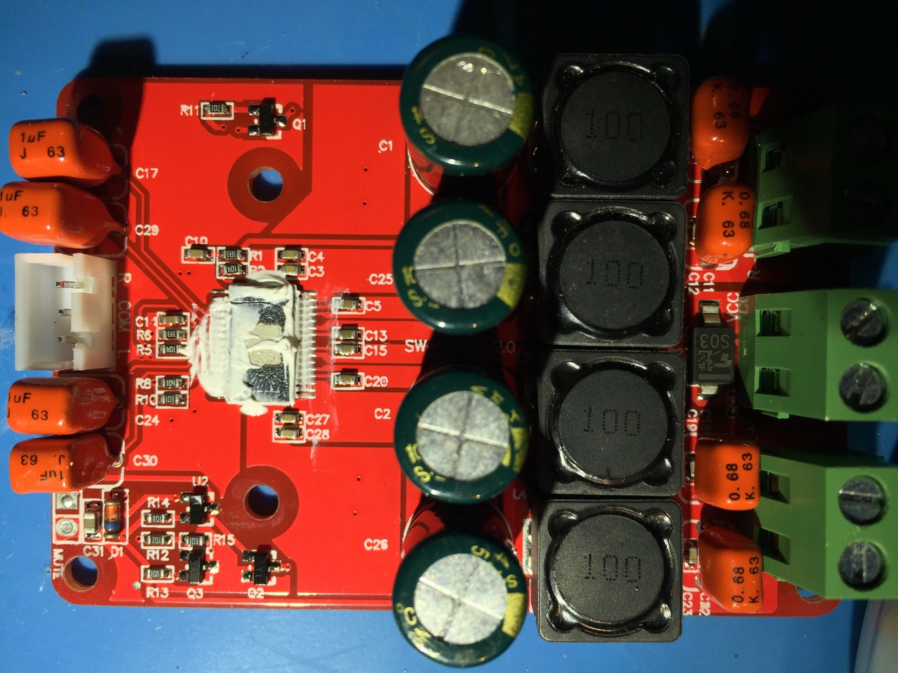

Hi Easp, most of the boards listed on this page (newer boards) do not appear to have the bootstrap snubber in place.
The sun might also be setting on the mass produced 3116 boards with the 3251 becoming available.

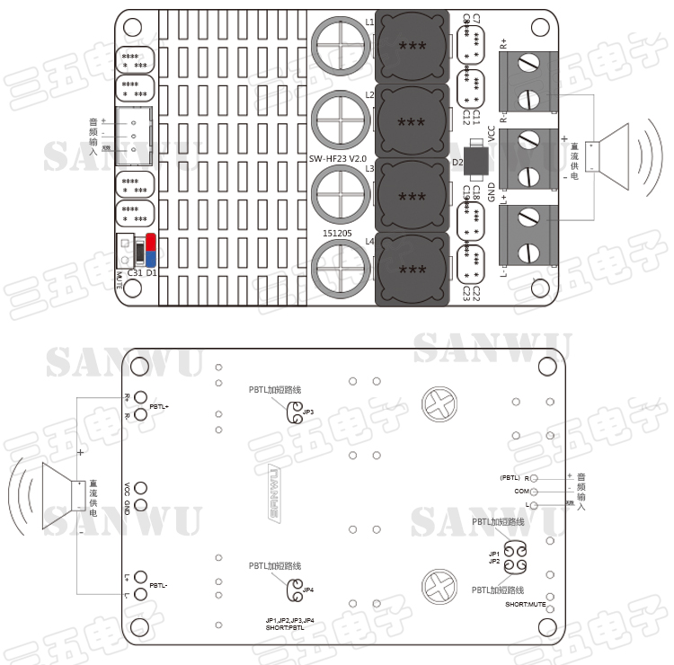

Does the Sanwu have provisions under the PCB for the snubber mod ?
Is that using pads intended for PBTL? From the datasheet schematic, they should be connected to the same point in the circuit as the bootstrap snubbers. If so, the Sanwu board does have pads that could be easily exploited to fit bootstrap snubbers.
JP3 and JP4.
JP3 and JP4.
