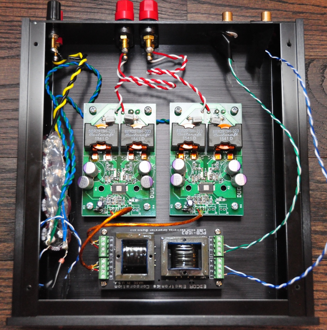

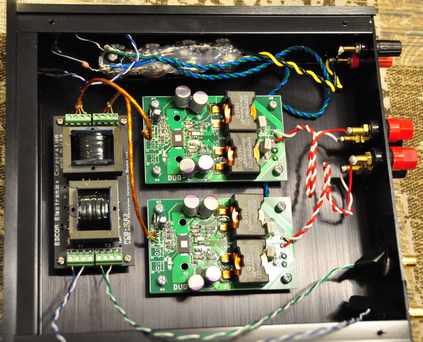

I just finished assembling my second DUG-1 dual mono-amp. This weekend I did the first test, and everything works, but there is a "whistling" or "squelching" sound. The squelching is fairly quiet, as it can be mostly drowned out with modest-level music. It sounds like a tea kettle coming to boil (though not nearly as loud) or like the wind howling at night. It's coming out of both channels. It doesn't seem to scale with volume. In this particular test, I was using my smartphone to send the signal to the amp (1/8 stereo to dual RCA).

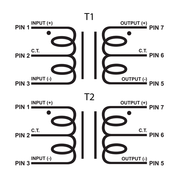

For this build, I'm using an Edcor TTPC15K/15K for DC-blocking and unbalanced to balanced conversion. Instead of capacitors for C2/C3, I used 0-ohm resistors (jumpers). I attached the schematic of the transformer below.
Here's the (naive) wiring I did:
RCA POS to T1 Pin 1
RCA GND to T1 Pin 3
T1 Pin 7 to Amp Input POS (i.e. series with C2)
T1 Pin 6 to Amp Input GND
T1 Pin 5 to Amp Input NEG (i.e. series with C3)

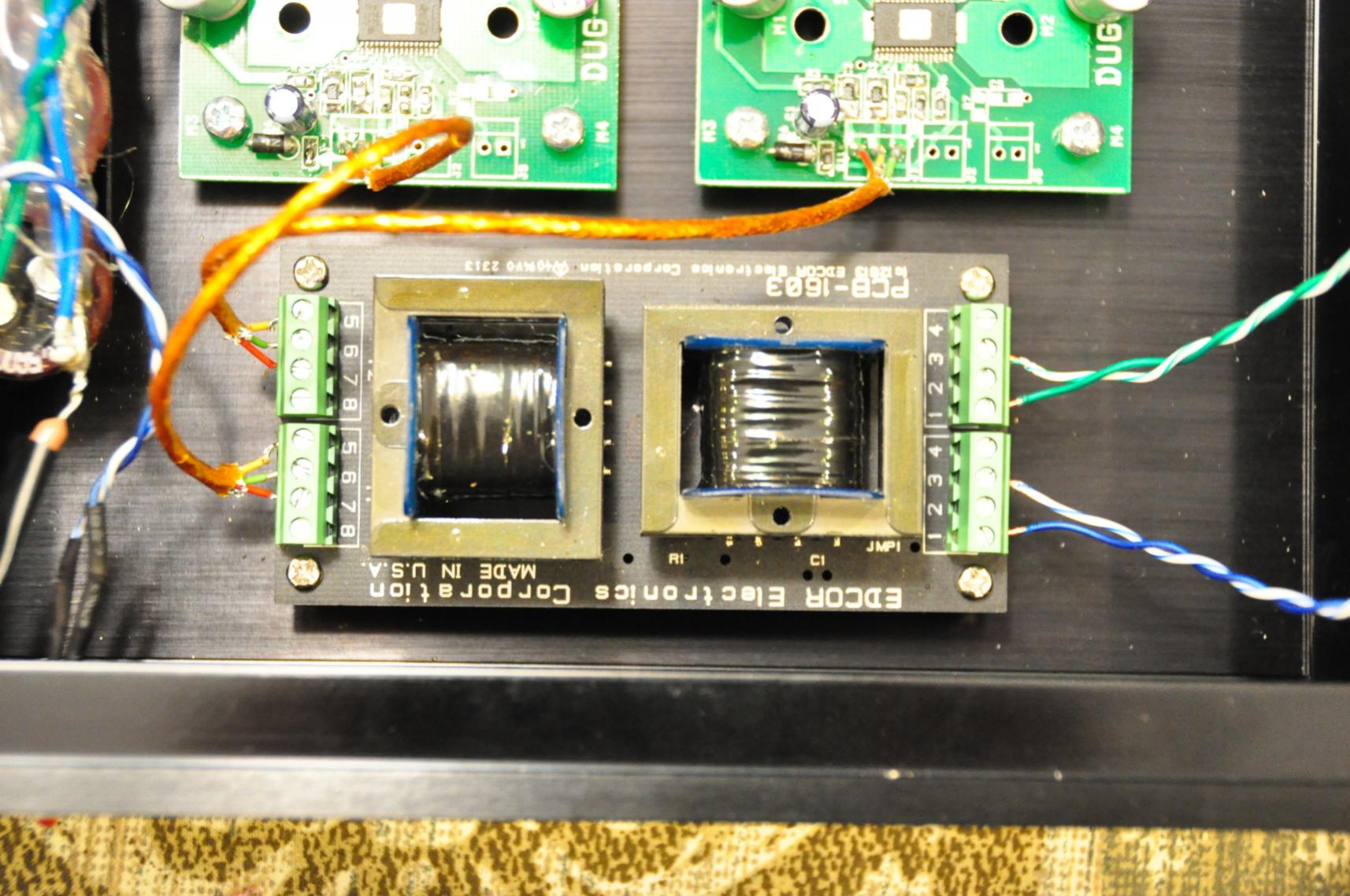

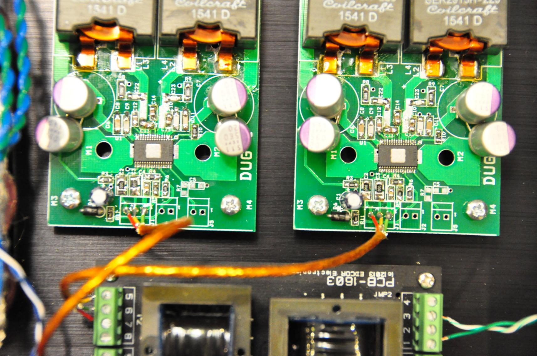

I thought maybe the squelching/squealing/whistling sound might have been due to the RCA-to-transformer side of things (since it was taped in place as a temporary testing measure). But I completely removed everything from the input side of the transformer, and the sound remained.
Based on the little web research I did, I suspect the transformers are microphonic and picking up some noise somewhere... earlier in this thread, I recall at least one person using transformers (not Edcors, but same idea I think) created some kind of RC snubber circuit. Perhaps such a thing is needed here?
Also, FWIW, I'm using an Astron SL-11R (linear regulated 13.8V) power supply. As per cjkpkg's suggestion in the other thread, I will try another PSU when I get a chance. I know the wiring is messy, I intend to the clean that up. I believe the amps should be reasonably decoupled from the PSU, with those 4x5600uF caps. (This thing will play for a good eight seconds even after the PSU is shut off.)
Happy to hear any thoughts or ideas, thanks!

I'd also supect the transformers.
The transformers themselves, or the wiring to/from them?
I have used these transformers before, though briefly, in another build (there's pics somewhere in this thread). And I also loaned these to rhing and he used them for a while, never reported any issues (also pics/writeup buried in this thread).
But, when I previously used them, it was balanced-to-balanced. And I think when rhing used them, it was unbalanced-to-unbalanced. So I believe this is their first use of unbalanced-to-balanced...

Did you checked for this with grounded and closed chassis as well? Do they pickup noise from your I.e. mobile or handset?
Not yet, i.e. only tested with chassis open (as in the pics above).
But that brings up another related question: what is the proper way to ground the chassis, given that the PSU is in a separate box? In my other builds I've had the PSU and amp in the same enclosure. I use a three conductor mains cable, and short the mains earth to the chassis. But I have no convenient earth available in this build...

I've observed (and read many comments about) that whenever a (relatively) high impedance is seen by the input of these chip there seems to be "noise" pickup.
In your case the transformers themselves may be the culprit.
Are the cores of the transformers grounded to the board ground?
Do the secondaries have a CT that could be AC coupled to board ground?
There may be hope. :)

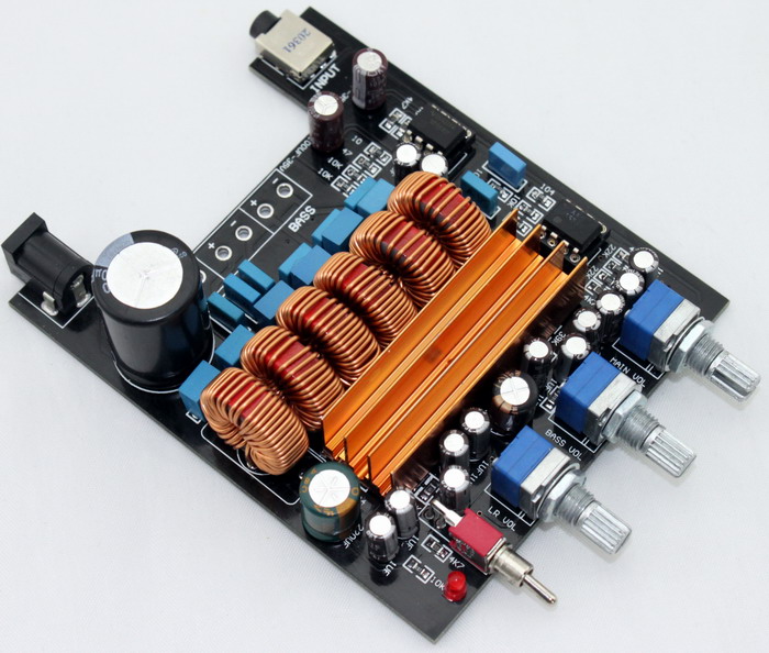

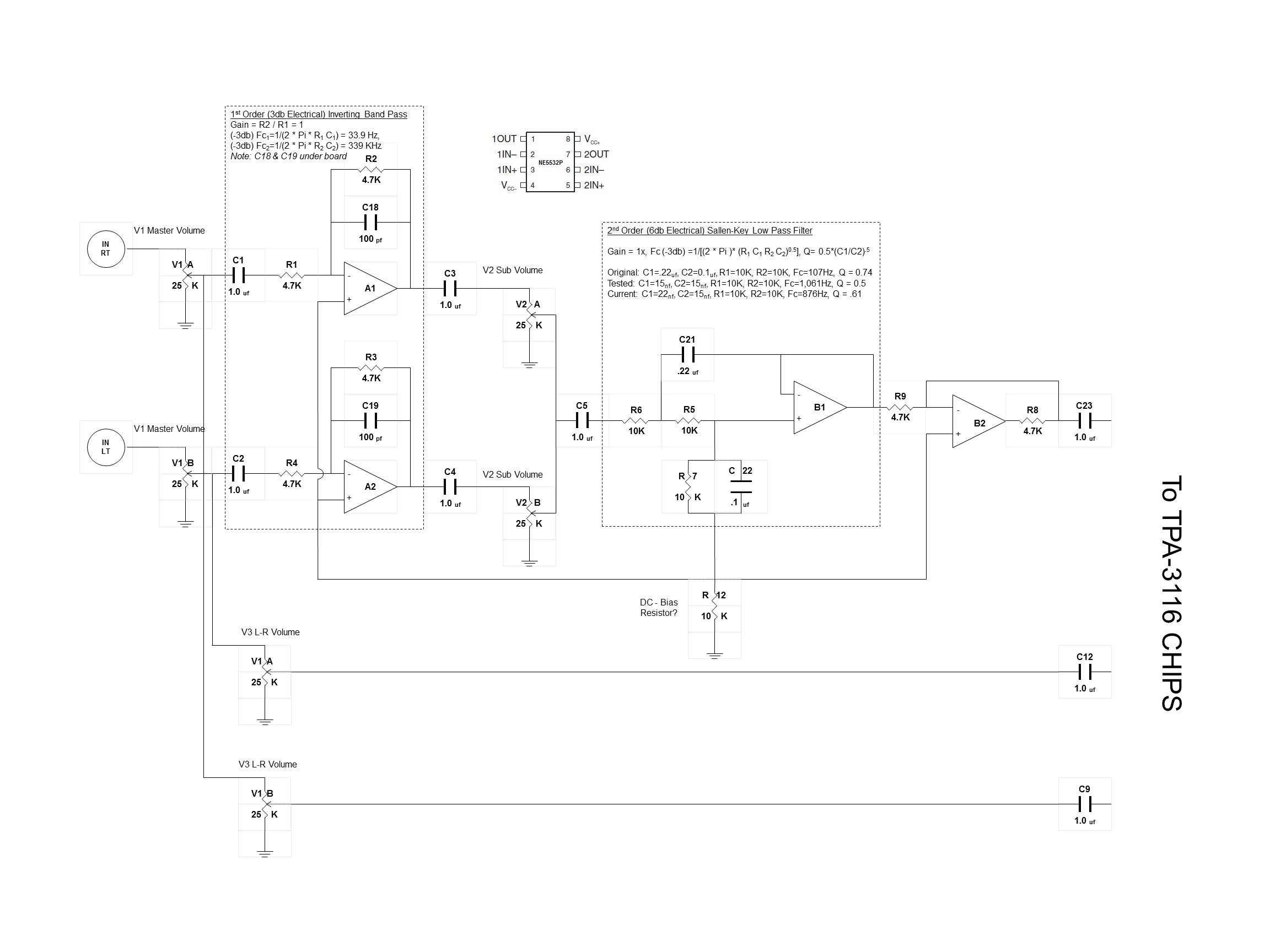

I have this amp. The layout is similar between two versions except for the PS capacitors.
Hers a rough schematic ... It's easier to read if you download it to your PC and open with Windows photo Viewer or similar app.
The L-R channels actually measure pretty flat with a slight decrease starting at 3Khz on up to 10Hhz where its -3db.
The sub channel on the other hand starts with a 1st order inverting band pass prior to summing the L-R channels (upper left in schematic). The band-pass low end's Fc is 34 Hz. This reduces the very low end base on the sub channel. You can get a lot back by substituting 10uf electrolytic capacitors for the existing 1uf decoupling caps (C1 & C2 in the schematic). I'm currently using it as-is to manage x-max on my sub.
After summing, the combined L-R signal is modified by a Sallen-Key 2nd order LP filter set at 107hz. You can modify the LP by changing the polyester caps C21 & C22 (mine is modified to 876hz). I have a legend for the physical board if your interesting in substituting capacitors.
On the bright side, there's no-turn or turn-off pop whether you use the switch or (un)plug in the power supply. Some mentioned that the switch only encages mute. I'll have to test current draw on idle to see if the switch actually turns-off the TPA3116 chips..
