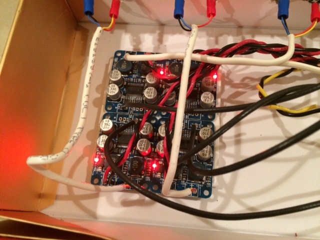

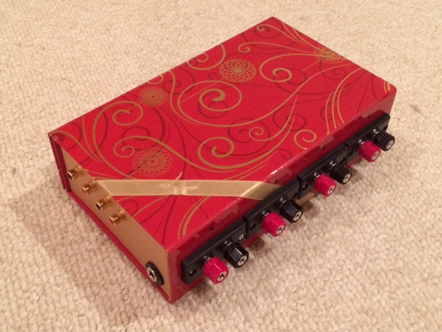

I put all four monoblocks into a case for a 4 channel active amp to be used with a miniDSP. The case is a cardboard Xmas chocolate box with magnetic snap lid, hence I will call this the "Xmas Amp". I am using RG-174 coax from RCA's to the amp, 18 ga stranded wires for power, and doubled-up solid core 22 ga copper for connection from amp out to binding posts. For output connection, I have some nice 5-way banana binding posts, and 4x RCA inputs, and room inside the box leftover for the miniDSP later.
Here are some photos. The amp even has an SMT red LED power on indicator.

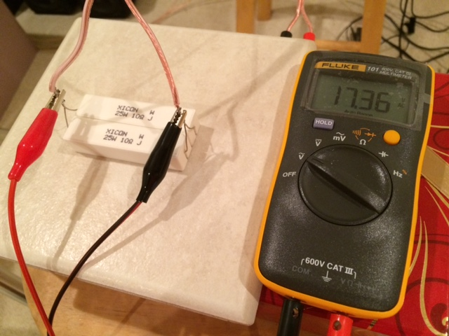

I hooked up a 5ohm 50w dummy load resistor, used a 24v SMPS, and clocked 17.36 volts as measured with a Fluke 101. The resistors were smokin' hot and outgassing something serious stinky smells (I could not touch them), the amp chip was hot and not comfortable to touch, the inductors (surprise), were barely warm. I ran for 5 minutes with 1kHz and the thermal shutoff never tripped. So it's a bonafide 60w into 5ohm amp.
I listened to it and was *REALLY* pleasantly surprised. In stock form, it sounds excellent. Great bass authority driving my 6.5in woofers in a 2-way (GR Research XL-S). Highs are clear and with good resolution and transparency. Ran through about 10 of my typical test tracks and they all sound good.
In summary, this amp is an excellent value, sounds great and is tiny. I highly recommend it.

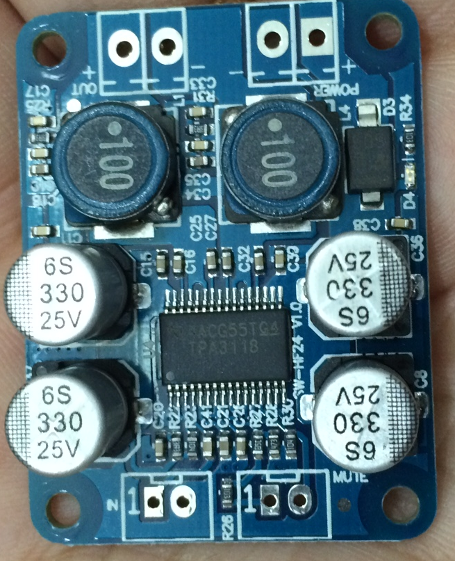

Nice little amp! What is standard gain ?
It's higher than 26dB, probably next step up 32dB? It sounds much louder at my usual volume knob and is the perfect match to be driven by my iPhone for good sound level. I am too lazy to get the magnfier out and trace the resistor settings. Although, the interested reader can probably zoom in on my photo and figure it out.
I will post a high res photo if anyone is interested in digging...
