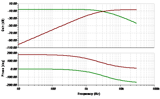

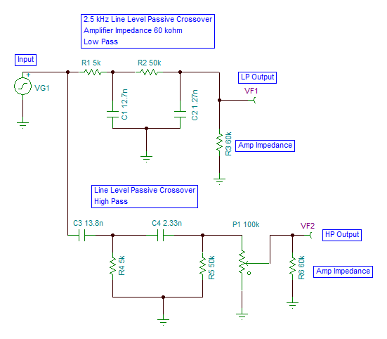

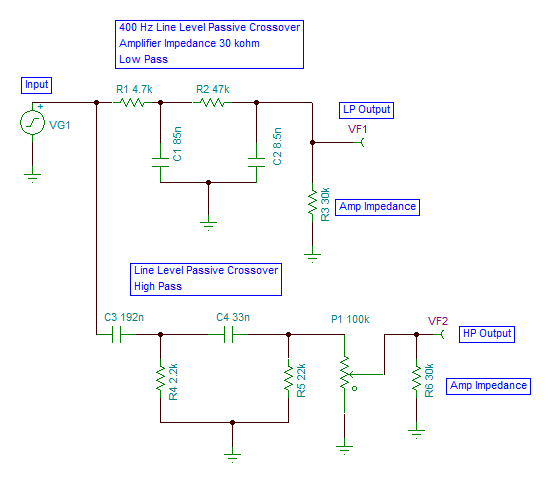

Since these amps are so cheap, it naturally makes sense to use them for bi-amping with a passive line level cross-over. I used the spreadsheet from here http://www.t-linespeakers.org/tech/filters/passiveHLxo.html to calculate values for a 2.5 kHz XO. According to the TI literature, the TPA3116D2 has an input impedance of 60 kohm when gain is set at the medium 26 dB level. Based on the results of the spreadsheet, I plugged that into the free Spice modeling program called TINA from TI to confirm the results. It looks pretty good with a 12 dB slope. Best of all these line level parts cost pennies and the cost of the TPA3116D2 is less than passive speaker level XO. I added a 100k pot leading to the tweeter amp to adjust levels to match (like an L-pad). The XO has an inherent loss of -6dB, but if you drive this with line level outs from a CD player, or better, use the headphone-out jack as a variable level preamp, this should not be an issue. I have never built one of these before so wanted to get your feedback if you have done this. I plan to use the amps to drive a coaxial Eminence Beta 12CX and attached compression driver. I have heard that XO at 2.5kHz is good and avoids cone breakup.
Thanks,
X
Here is the circuit:
Here is the high pass and low pass gain:

I have a correction to post #385: the impedance of the TPA3116D2 is 60kohm at gain setting of 20dB. At 26dB impedance is 30k, so the above circuit would have to be reworked with appropriate value, or change gain setting resistors on amp to reduce gain to 20dB. The higher input impedance works better with the PLLXO.

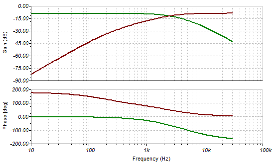

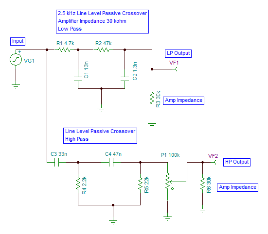

I ran a case for 400 Hz in the spreadsheet but when I ran the simulation in Tina, it is more like 450 Hz - should be OK. This is assuming you are using the 26 dB amp gain for input impedance of 30 k ohm.
Circuit
Gain/Phase Plot
the input resistor of tpa3116 has tolerance as high as +/-20%. For precise cutoff frequency you can insert buffer in between and use a high precision resistor to ground.
Good idea. I think the 2.1 version has a built in preamp which could serve as a buffer, and one could replace the input resistors with high precision ones. Adding a buffer to the 2.0 version sort of negates the simplicity of a PLLXO.
