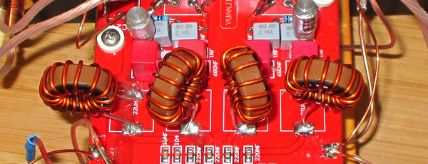

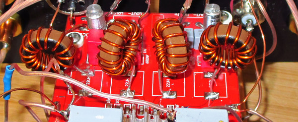

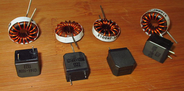

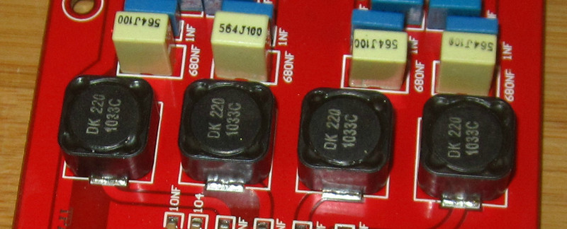

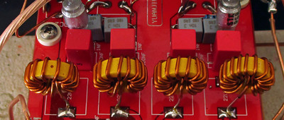

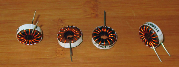

I finally got around to picking up some different inductors.
In one of my TPA3116s, I’ve been using some 10uH inductors that I originally bought on Ebay to put in a TA2020 and they sounded quite a bit better than the stock inductors in the 3116 but they ran quite warm and caused the chip to run warmer too.
652-2100HT-100-V-RC
Today I swapped them out for these Bourns parts (Mouser -652-2100HT-100-V-RC).
I think they are well worth the 9 bucks and I highly recommend them!
They are physically larger but sound great and they don’t heat up like the others I bought on Ebay.
Next will be to try these inductors from ICE (Mouser - 911-1D14A-100M) and hear how they compare.

Which are the photos of the Bournes inductors?

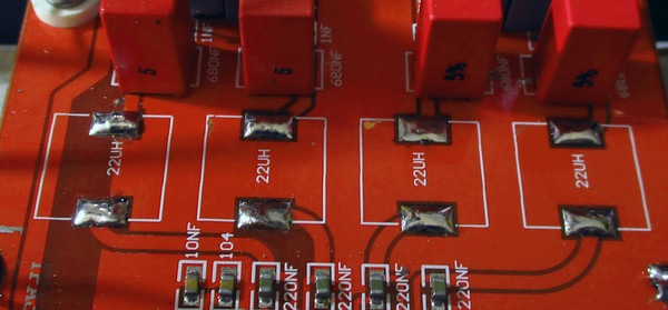

KJA,
Very interesting finding. Can you tell me how did you desolder the original inductor:eek:? Cannot even see the solder joints since it is covered by the inductors.
KJA,
You can see the edge of the pad on both sides.... I was able to remove them unscathed but be willing to sacrifice the part to maintain the integrity of the traces.
The ones from Mouser are listed as Class D filter inductors and have adequate current ratings...looks good.
What I would like to see in the data sheets is the self resonance frequency of these inductors.
I would not like to use an element that is acting like a capacitor in a Class D filter.

They seemed like a good choice to me too, but there are so many 10uH inductors to choose from. Have you used these before?
They are used in the amp10 from 41hz. The only drawback is that they're through-hole which makes it a little annoying when designing an amp meant for having components only on one side and the reverse full ground plane thermal glued to a heatsink.
Luckily the physical size of the inductor is such that by bending a small foot on each lead enables the inductor to fit perfectly on this board. Wasn't sure they would fit, but they fit quite nicely.
