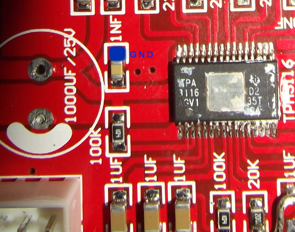

Did anyone have success with eliminating the anti-pop or anti-bump on the red JY board on turn-on? I placed a capacitor from the mute pin to the ground on the power input and that seemed to work but isn't very pretty.
Yesterday I tried the method proposed on page 172, see image below and the ground point suggested, using a 10uf 50v capacitor and it didn't work. This is a way cleaner way to mod the board so hoping there's another solution like this.
Or rather how do I locate a ground point on the board closer to the mute pin?
