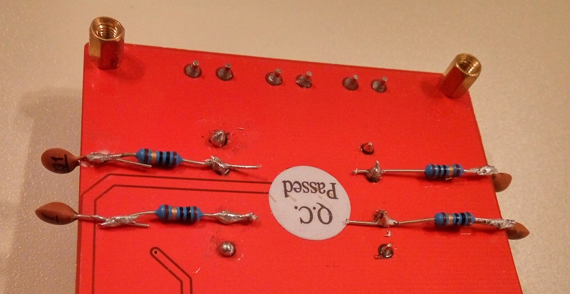

I put the bootstrap snubbers from the input side of the inductors to the ground plane underneath. Thanks again for the suggestions fellas! The amp looks much less silly now.
I'd like to do the snubber mod on my board too. Have some Wima 0.1uf caps lying around. Will that suffice?
With the original coils, it's hard to see where the input side of the inductors are. From your pic, am I correct to say they are the large solder pads next to both edges of the pcb?
Hello Bernie. The snubber mod specifically calls for a 330pf 50v capacitor and a 10ohm 5% 1/4W resistor. I used these caps and resistors. I am sure any capacitors and resistor of those values will work, does not have to be expensive. Maybe avoid wire wound resistors.
Yes, the way I did it the 330pf cap will go from the outer solder pads at the edge of the board, to the 10ohm resistor, and then to ground. There are many ground points, I just scraped off the mask underneath the board. As irribeo suggested, keep the leads as short as possible.

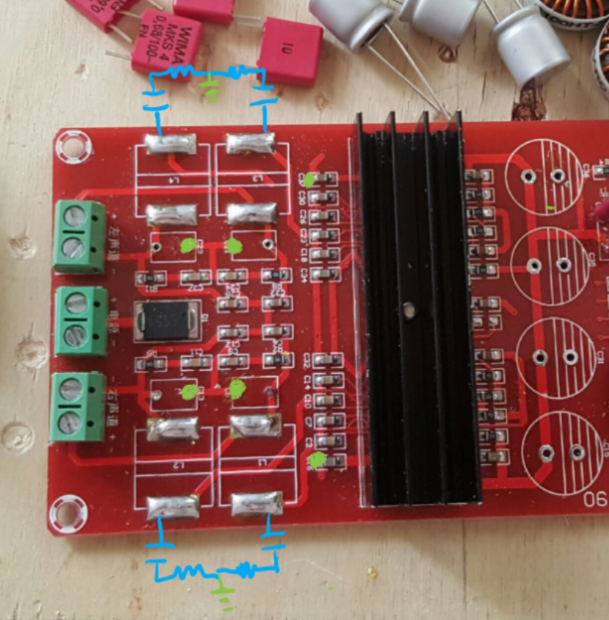

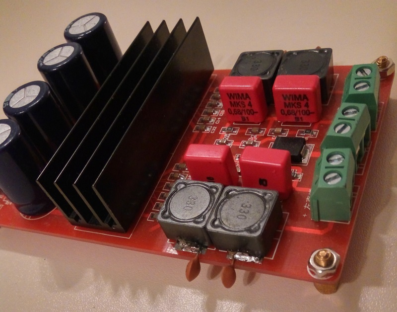

I saw a guy in Serbia on google images, that did the bootstrap mod differently than one of you guys recommend. I added pictures.
Picture 1 is MY setup (x2 ofcourse). Pic2 and 3 is the serbian snubber mod.

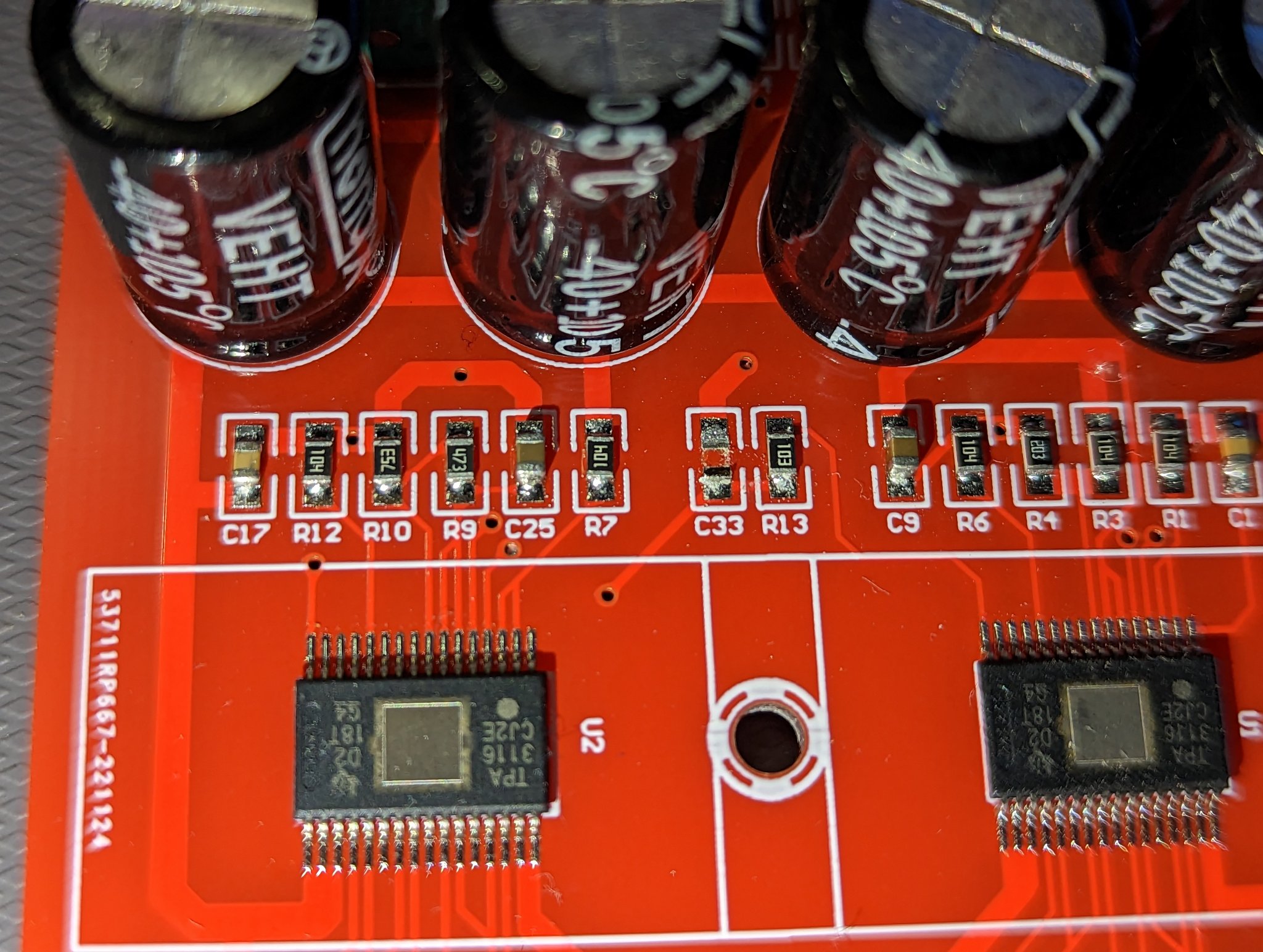

Totally new to this hobby, bought 2 of these boards XH-M190s and one came broken with a capacitor missing/knocked off . Does anyone have any idea what rating this ceramic capacitor has, C33 placement. Checked with a DMM and the it loops to nothing adjacent C9 ceramic is 3.6 uf.
22pF, best remove c33 on the other board too and also mount 22pF (measure footprint before ordering "massive" or "miniscule" replacement part
Function is to filter the synch between master and slave, the 1nF datasheet value doesn't work because it filters the frequency the synch works at. EVM values are 4k7-47pF and those do work, so I would think your r13 value gives 22pF to function like the EVM.
