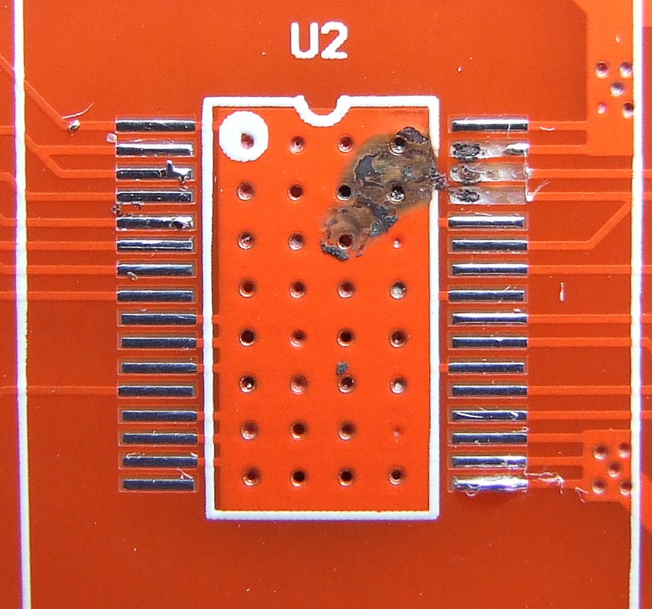

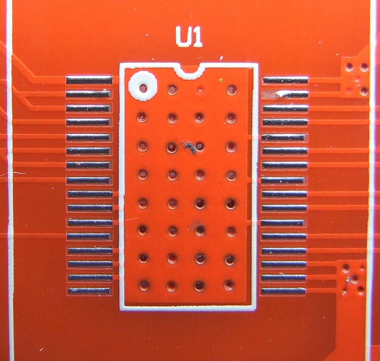

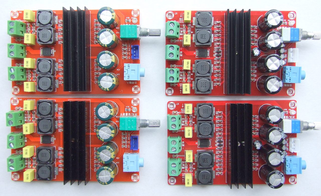

Fault investigation on TPA3116 boards.
I was very happy to pick up four defect TPA3116 boards. New challenges ahead.
I will briefly describe my findings and a method to use when looking for unknown defects in electronic amplifier boards. Many on this forum are far more experienced in repair than I, but some young DIYs may benefit from improved systematics.
VISUAL INSPECTION.
The most obvious, but often neglected part of electronic fault finding is giving the board a thorough look for mechanical abnormalities. Overheating, poor connection, wrong polarization, wrong connection, wrong mounting etc. are quickest noticed by looking carefully at the board.
On top, you may spot important details of the board.
For the four boards, the first impression was very good. No obvious defects were spotted with the heatsinks in place. The components on the boards were generally selected well according to the standards for such rather cheap boards.
Only the choice of the output filter chokes was awkward. TI recommends 10uH (with 680nF). On the board 33uH was used. Standard 12x12x7mm enclosed chokes. That the cut-off frequency is chosen lower is not a main concern, but the current rating is. The higher the inductance (using the same core), the less is the maximum current before saturation. Such 12x12x7mm cores with 33uH can handle around 3A (peak) before saturation. That corresponds to some 2Arms. 2Arms may just do for 8 Ohm loads but not for 4 Ohm and even less for 2 Ohm. Had the same cores been used for 10uH (as recommended), the current rating would have been considerably higher and 4 Ohm speakers could have been used at full output power without saturation. More bizarre, two TPA3116 chips are used on a board for PBTL coupling to allow low impedance loads (below 4 Ohm). But, the filter chokes will saturate with such low impedance loads. Something vent wrong in this part of the design.
When the heatsinks were removed, two similar defects were spotted on two of the four boards. For two of the in total 8 TPA3116 chips, a few pins had suffered current overload damages. In particular the pins on one of the chips. The pins and corresponding PCB pads had disappeared. Such damage hinted faults on at least these two chips.
It was clear that at least the board with the most substantial damage could not be repaired. The chip housing is very small (TSSOP) and the PCB tracks equally narrow. As important parts of the output track was gone, no repair was worth the effort.
TEST WITH AN OHM-METER.
A very simple but surprisingly efficient method is the use of an Ohm-meter. A large share of faults in else functional amplifier designs can be detected on the output terminals or the power supply terminals. Very often an output “hangs” on (shorted to) either ground or supply level. Or, the supply line is simply short-circuited.
For the test, I use the 20 KOhm range or 2 KOhm range and no power or connections to the amplifier board.
For a start, I test the power supply terminals with the 20 KOhm range. The red measuring probe on the “+” terminal for the power supply. If the board has a polarity protection diode, such as these four boards, the red probe has to be moved to the cathode of the protection diode. The black measuring probe on the “-” terminal for the power supply. If the power input of the amplifier is in good shape, the resistance value seen on the Ohm-meter will slowly and regularly increase as the Ohm-meter test voltage charges the on-board decoupling capacitors. If the resistance remains steady and low, the power supply line is likely to have a short-circuit somewhere. For amplifier boards with symmetrical supply, the test has to be carried out for both rails.
All four TPA3116 boards had a short-circuit towards ground (measured after the polarity protection diode).
If the power supply input is fine, then on to the speaker outputs. With one of the measuring probes on the power supply “-” terminal and the other measuring probe connected sequentially to the speaker output terminals. If any of the speaker output terminals have an impedance below 100 Ohm toward the supply “-” terminal, there is reason to worry. If all is still fine, the same test is conducted from the power supply “+” terminal and toward the speaker output terminals (sequentially), still looking for less than 100 Ohm impedance. When a symmetrical power supply is used, also the negative rail has to be tested toward the speaker output terminals.
The four TPA3116 boards all showed at least one speaker output terminal to hang on the “-” (ground) terminal. None of the outputs hang on the “+” terminal. Only one TPA3116 chip had outputs not hanging on either the “-” or “+” supply lines.
For the four boards tested here, all had an apparent short-circuit from power “+” to ground (“-”). And, all chips but one had at least one output hanging on power supply ground. The low impedance to ground could be caused by a short-circuit to ground in the output filters, but then the short-circuits between power supply “+” and power supply “-” would not fit in.
As two TPA3116 chips anyway had to be removed from the boards because of pins damage, they were removed such that these output filters were isolated and could be tested without influence from the chips. Both these two output filters were fine and the lines “floating”. Then, all the other TPA3116 chips were removed, except for the chip with no outputs hanging. All output filters seemed to be fine. Also, then all tests of the power supply lines were successful.
The board with only one (perhaps good) chip was tested with 10V/300mA, speaker and source. That channel worked flawlessly, even with 25V of supply.
Post mortem analysis is uncertain. The output stages of almost all TPA3116 chips had been ruined on the low-side. One output lines had suffered serious damage due to excessive current. The chip outputs were without doubt involved in the initial havoc. Either from output short-circuit/wrong connection, or from a high voltage “kick-back” of the filter chokes (no catch-diodes to protect chip outputs) eventually due to missing load. The destruction of the low-side switches/drivers resulted in short circuit of the power supply lines.

The boards are advertised as 2x100W. Impressive for that size and price. Credible? - only with restrictions. The TPA3116/18 are limited in output power by their maximum supply voltage of 26V. A supply voltage of 26V leaves the voltage “clipping point” at 2x35W (8 Ohm) and 2x70W (4 Ohm). No 2x100W.
But, these boards use PBTL coupling with one TPA3116 chip per channel. The TPA3116 chip is conceived as BTL so the output power cannot be raised by increasing the voltage on the load. PBTL only helps increasing the current that can be handled. According to the datasheet, the TPA3116 can handle the current in a 4 Ohm load with maximum supply voltage using ordinary BTL. Why then PBTL? PBTL leaves half the switch impedance (impressive 60mOhm) and perhaps double the current rating. Looking at the TSSOP (Terribly Small ) housing and leads, I am not fully assured. But, in theory the PBTL coupled TPA3116 can handle loads with impedances below 4 Ohm. Such low impedance speakers may be found in vehicles. Normal cars have 12V systems so 2x100W is not possible here (only far less). But, for a truck with 24V electrical system it may be possible.
In short, never rely much on such surprising specifications.
