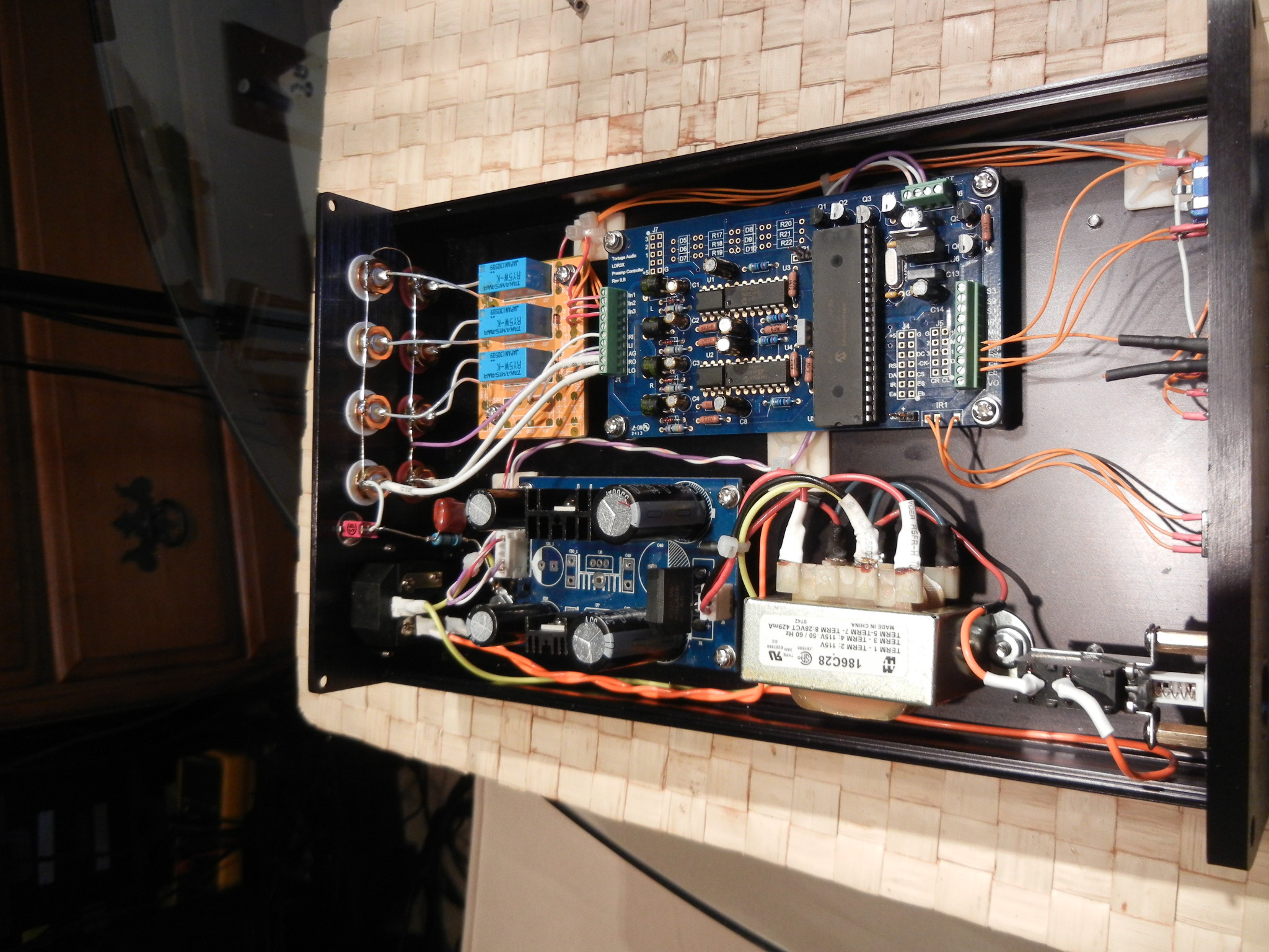

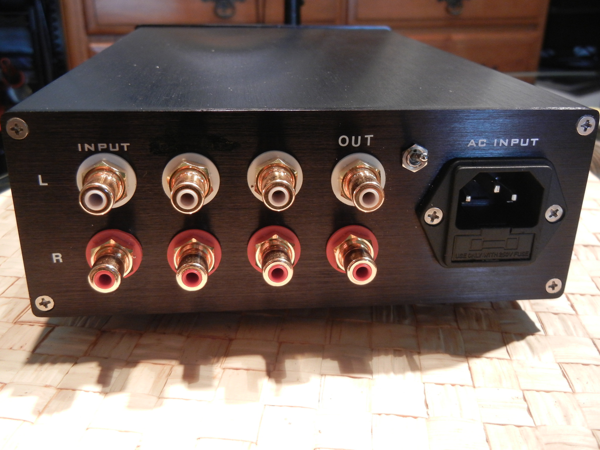

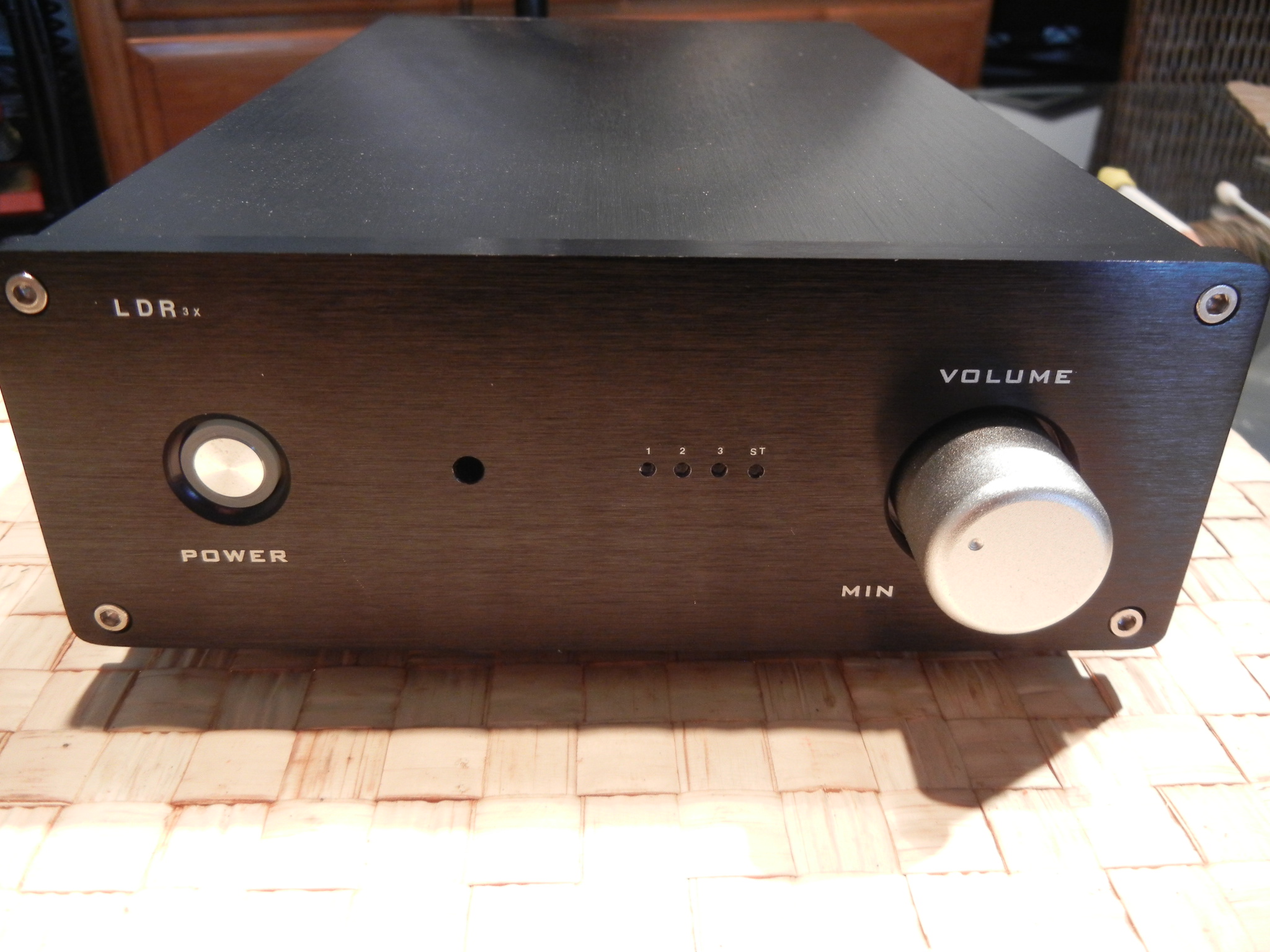

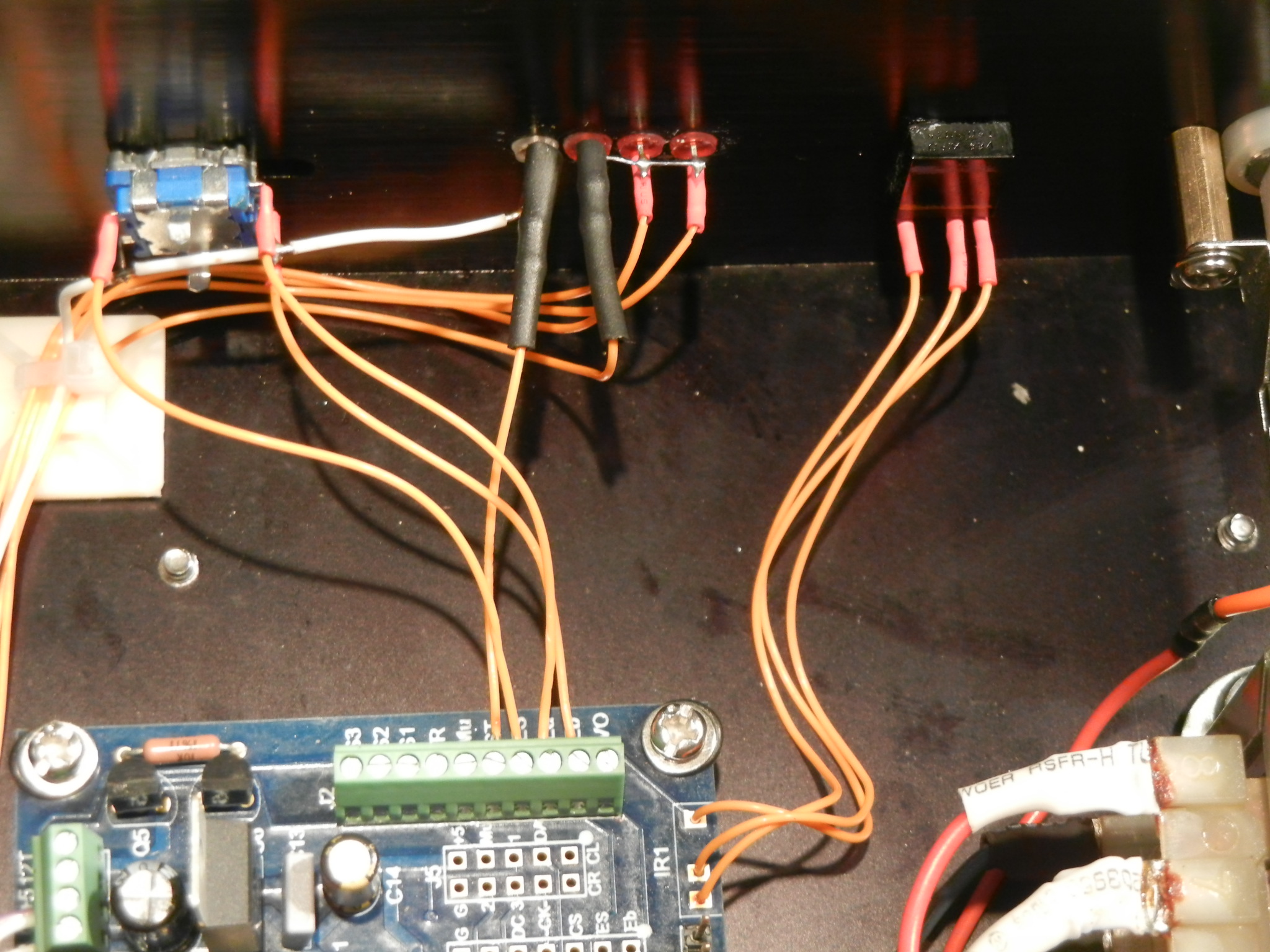

Just wanted to share the pics of my build.
In the past I built and used numerous "Lightspeed" and "Lighter Note" attenuators - wonderful sounding but problematic units. LDR3x seems to address most of the issues related to LDR matching, impedance curve adjustment and balance, and most importantly - remote control.
Initial impressions on my newly built passive pre are very good. I am using it in front of LDM 300b amp that has very high input impedance and sensitivity, so LDR is a good match.

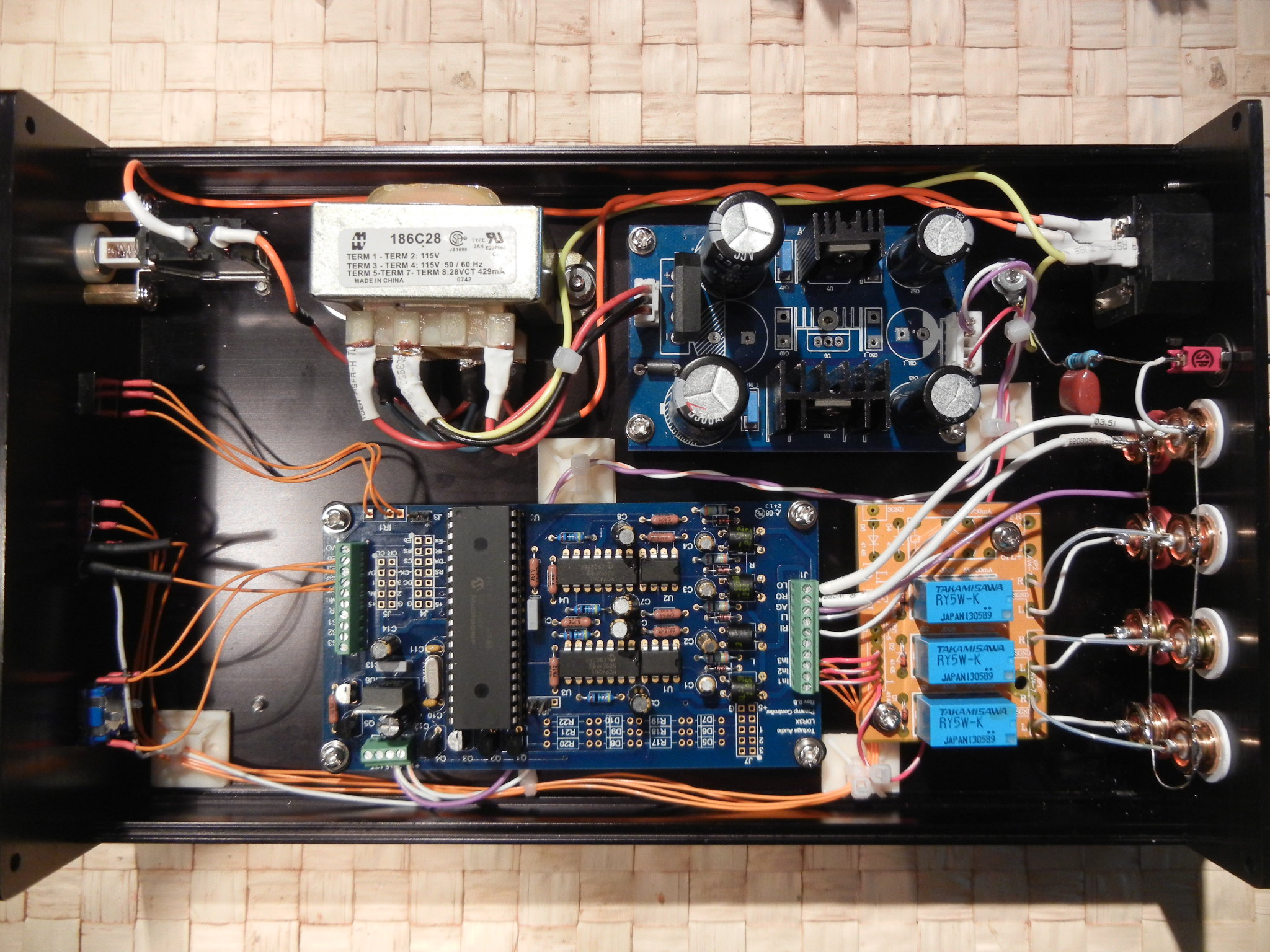

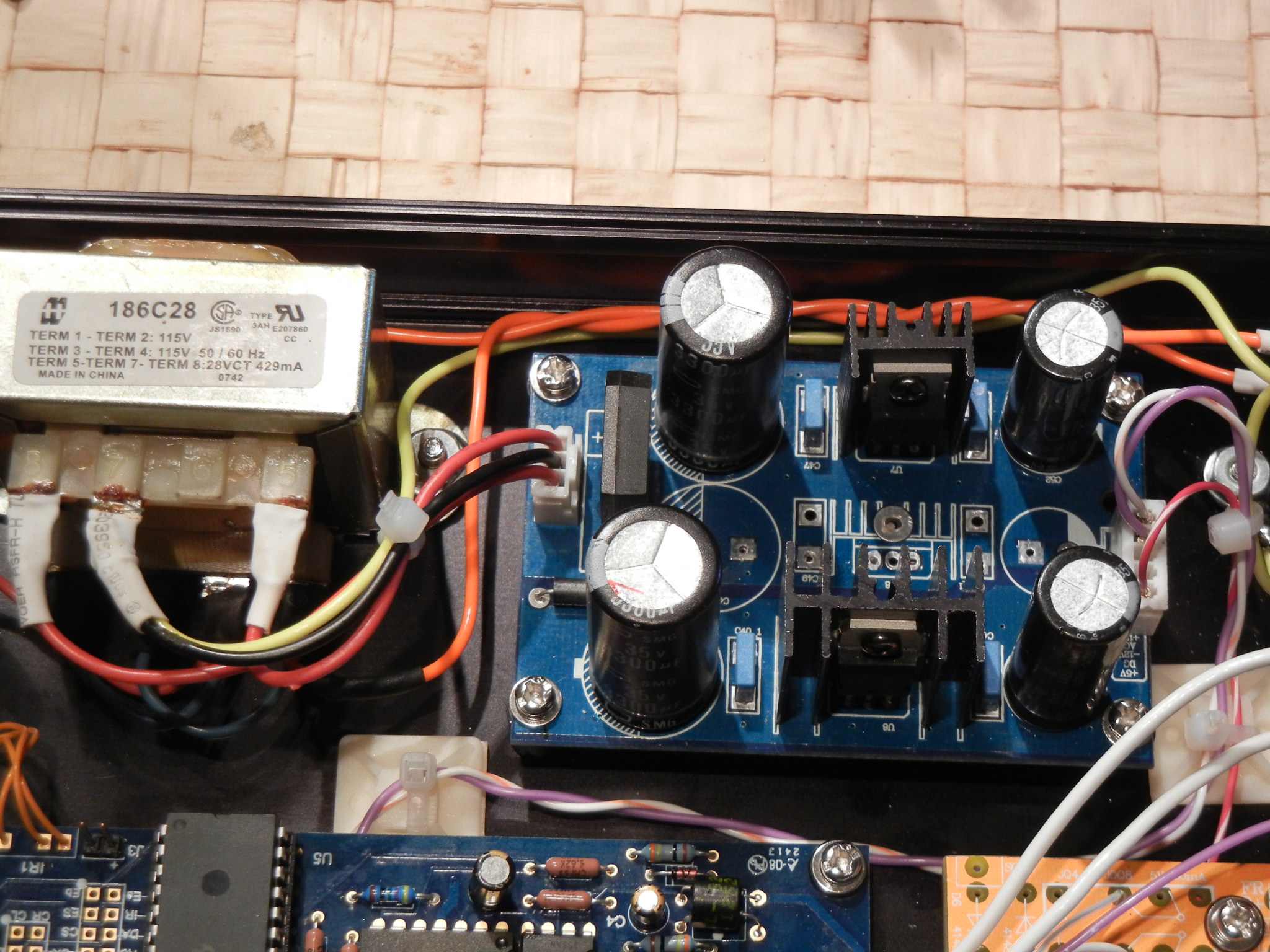

The build is straight forward: 28VCT Hammond transformer -> 7812 feeding LDR board, 7805 feeding input relay board. Audio signal is wired with #25 solid silver wire, everything else is wired with stranded #28 silver teflon wire. Attaching transformer and LDR board to chassis I used rubber rings to minimize vibration transfer.
The front panel houses rotary encoder, status LED, 3 inputs LED's, and IR receiver. I decided not to crowd the panel with input select and mute buttons as the rotary encoder performs all those functions.

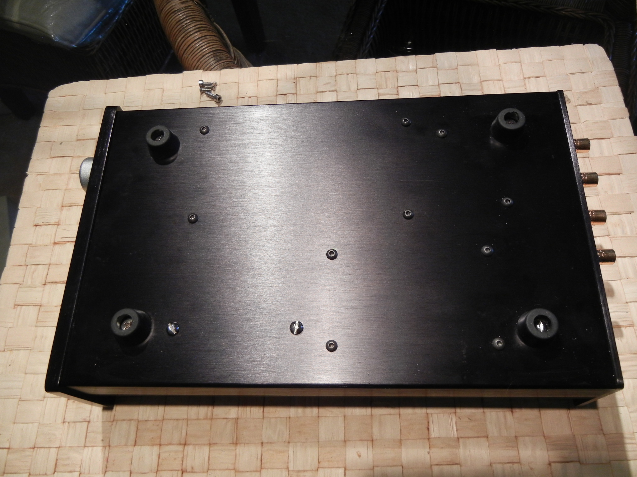

The back panel has 3 RCA inputs, 1 output, AC connector, and ground lift switch. Normally the signal ground is not connected to common ground. However, sometimes it is necessary to have such connection to resolve some hum problems. The ground lift switch connects signal ground to chassis earth via 10 ohm resistor bypassed with 0.22 uf cap which is a simple ground loop eliminator.
NOTE: on the LDR3x board the Audio Ground connection must be connected to signal ground only, it does not connect to common ground on the board. Initially I neglected this connection which led to some mysterious behavior of the preamp. Quick call to Tortuga and a couple of emails helped to identify my mistake (Thank you Marten).
LDR3x is a big step forward in developing LDR technology for DIY community.

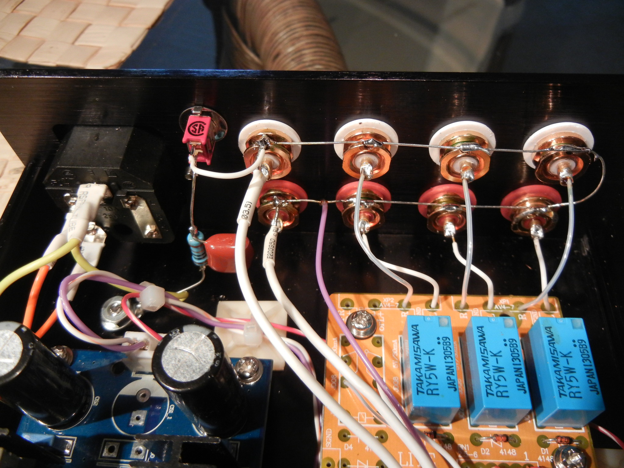

Hi ClefChef
Can you confirm if the three inputs as shown in your image are switched by relays. it would seem against audio purity of signal to have relays and only 2 active series and 2 active shunt LDR's controlling 3 inputs.
I would expect for a 3 input design that there be 6 series LDR's and 2 shunts, otherwise we are back to compromises with switches, electronic or relays, which correct me if I am wrong why LDR's are used in the first place, ideally wired directly to the RCA socket
It appears impossible to have anything less than 8 LDR devices if you want 3 inputs .
Perhaps some discussion on this could be enlightening.

The 3 relays are indeed for input switching. I think "audio purity" is somewhat misplaced here. Let's keep in mind that audio signal has to travel through various interconnects, sockets, switches, soldering points, etc. so relay contacts don't affect anything.
LRD's are used in the first place not for input switching but for signal attenuation. There were some attempts by Uriah Daley to create "pure" LDR switching device, in fact the very Tortuga Audio here has LDR6 with inputs controlled by LDR's.
Silonex SR32 minimum resistance is 40 ohm so you will never have a 0 ohm shunt and some signal leakage will occur no matter what. Relays or mechanical input switching is still my preferred way of doing it.
Comparing LDR3x to other units such as Lighter Note or Lightspeed or perhaps EVA I have to say that there probably is no difference sonically, nor should there be any, - all these units share the same Silonex SR32 pairs. There are no cobalt cores, silver windings or "Virgin Blood Capacitors" involved. The difference is in the implementation of the control interface of those LDR's and Tortuga seems to have the best one so far.

I'm a big fan of using LDRs as analog switches in lieu of mechanical switches. When LDRs are "off" they are well north of 1M of resistance - off enough! When they are full "on" they can be in the range of 40-60R which is de minimis relative to the downstream attenuator impedance. Again, on enough!
Thus, LDRs can indeed be used for selecting from multiple audio inputs. The argument for doing so is the avoidance of yet another mechanical interface point (the relay) in the signal path, gold plated contacts etc. notwithstanding. In fact, we use LDRs precisely for this purpose in our 6-input LDR6 Passive Preamp component. Including the LDR input "switch", we end up with 2 LDRs in series (1 fixed, 1 variable) and 1 in shunt (variable) per channel - or 6 total per stereo input.
Customers building their own preamps using our LDR3x DIY Passive Preamp Controller Board are left to their own devices as to how to implement input device selection. The LDR3x provides current sink switching to ground for up to 3 relays.....or LDR circuits. While we don't currently offer an input switching board, we are considering offering one in the future and it would indeed use LDRs in lieu of mechanical relays.
I would offer one caution in using LDRs as signal switches. For purposes of longevity, I don't recommend running them hard up against their LED current limit (20-25 ma in the case of the Advanced Photonix units we use) even though this yields the lowest "on" resistance. Better to back them off somewhat despite the slight rise in resistance. Still, commercial LEDs have a nominal lifetime expectancy of 50,000 hours. If you listened to music 5 hours a day, that's 10,000 days or 27 years....long enough I'd say!
