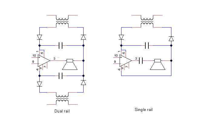

Is this what we are talking about?
Drawn a bit strangely but yes. A DC coupled speaker on the dual rail and an AC coupled speaker on the single rail.
Now take away the diode that recharge the capacitors at ~ 10% duty cycle.
The speaker in both situations is fed from the capacitors. It is an RC system.
The Power Supply capacitors affect the speaker output, a lot, at lowish frequencies and a little, at higher frequencies.

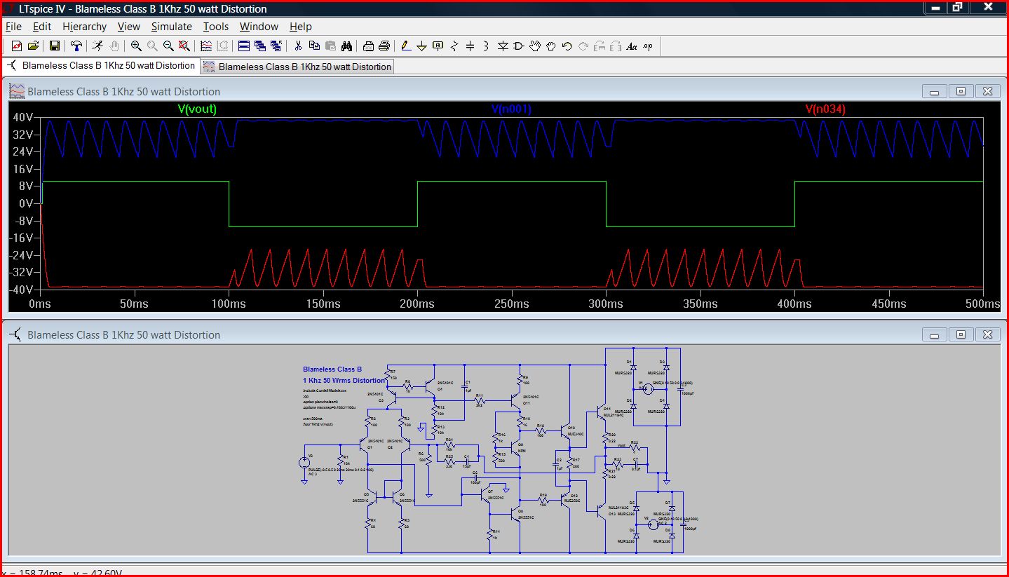

Lets try and get to the bottom of this. Here is a simulation of Dougs blameless Class B (chosen for the simple reason I had it on file). Here it is being fed with a 5hz squarewave into a four ohm load. The reservoir caps are 1000uf. The ripple on each rail is clearly shown.

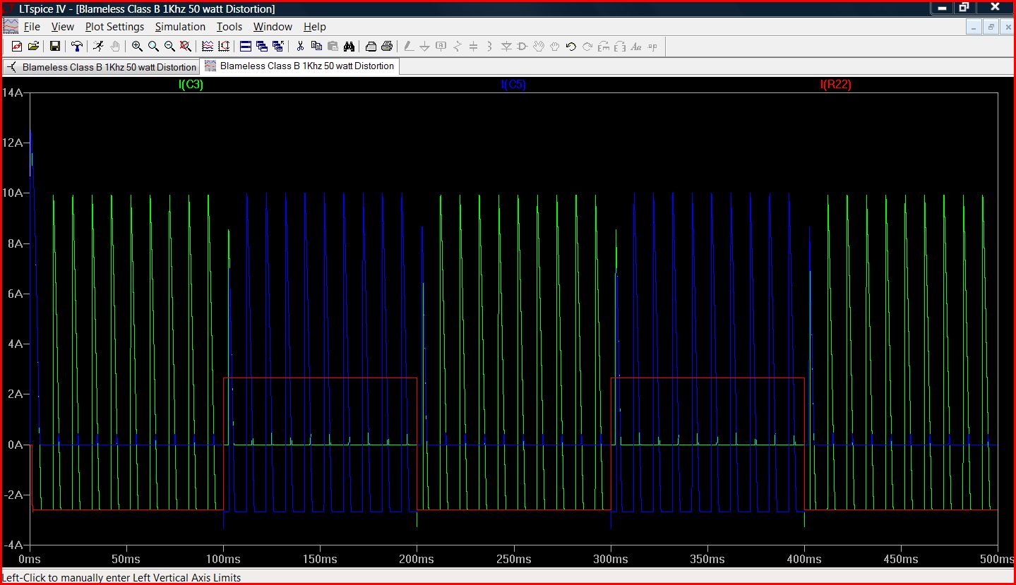

The reservoir cap currents are in the second piccy. Also in red is the current in the load.
So how do the reservoir caps affect the output at LF ?
Now is that true? Simulations show something els.

The gap between the Supply rail ripple and the output signal is predicted as ~15VLets try and get to the bottom of this. Here is a simulation of Dougs blameless Class B (chosen for the simple reason I had it on file). Here it is being fed with a 5hz squarewave into a four ohm load. The reservoir caps are 1000uf. The ripple on each rail is clearly shown.
If this overhead is reduced by increasing the output current then eventually the 5Hz performance will be affected.
You can increase the output current by reducing the load resistance or increasing the signal level.

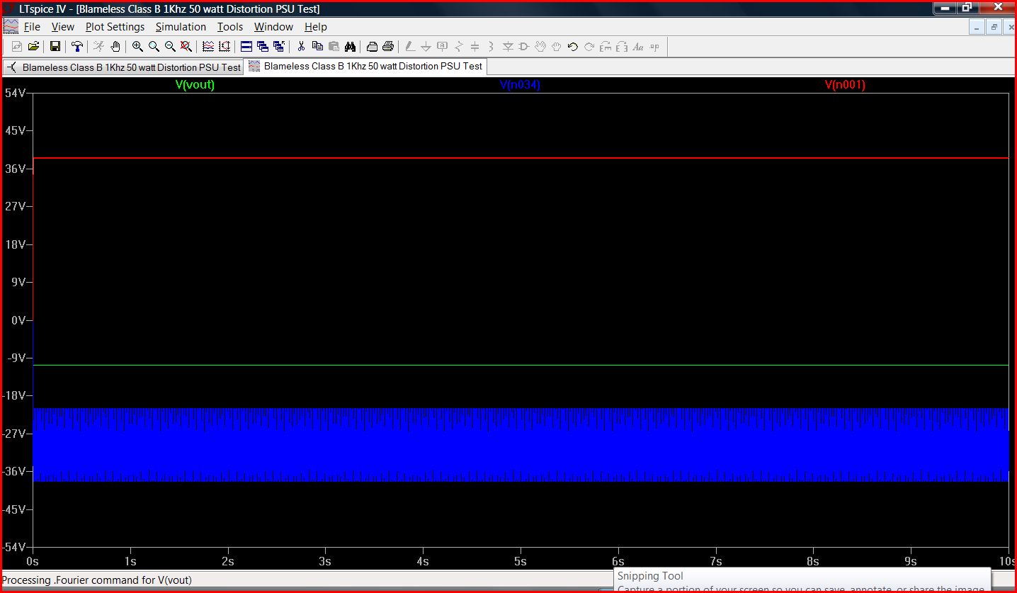

Here is a 10 second run showing the amp delivering negative 10 volts DC across 4 ohms. The negative rails ripple is huge because of the 1000uf reservoir caps. There would be no effect on the output voltage until the ripple "troughs" impinged upon it due to increasing current demands.
Andrew... can you see how the ripple current (which is huge) has no effect on the output. Similarly it is true to say that the output current, is independent of the ripple current, and in no way can a constant DC output currrent (0Hz a valid condition) can be said to be "passing through" the reservoir caps.
Edit... Red is the positive rail, green the output and blue the negative rail.

Compare the two diagrams in post25. They are so similar that you can see the RC filter.
Everyone accepts and recognises the filter imposed by the output cap in the single ended version.
That cap just moves to the other side of the Ground reference terminal in the dual polarity example. It is still an RC filter effect. If the charging system were a constant DC of appropriate impedance, we would not see the ripple imposed on the output signal, we would just see the droop in output voltage, i.e. reduced gain, as the two voltages approach each other.
