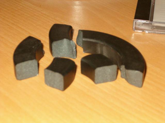

i found a way to know if its ferrite or not by trying to brake it :) :smash: , most of the time ferrites are fragile
so here it is :)

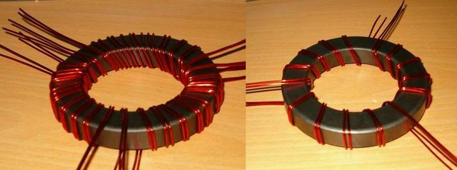

imho 4 turns ct and another 4 turns is the best config for the primary of car smps , read the whole thread i can find somthing dealling with freq :)
Originally posted by Eva

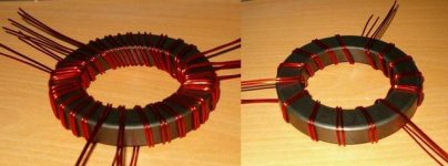

Another option is to divide the core in two or three equal sectors and wind two or three independent primaries [one for each sector] connecting them in paralell externally
i had some problems to cover the whole core with only 4 turns , after couple of tries i finally decided to do this that way , i have divided the core into 3 sectors as Eva said making 4.5 turns within each sector -heres the pic , on the right side one primary and on the left side bought primaries , looks kind of messy isnt it ?:D
