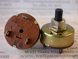

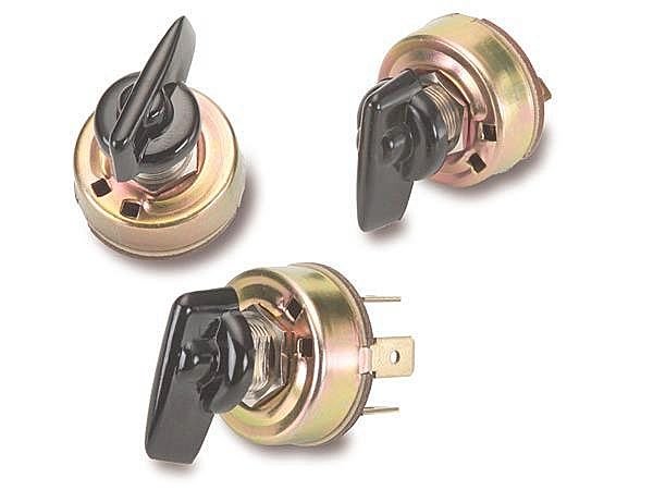

A. Rotary Switches
1) Saia-Burgess
Saia-Burgess P5-1N-209
P5-1N-209 | Drehschalter 15A 250VAC normal | Saia-Burgess
Saia-Burgess TH508025000: nla
2) Lorlin
Lorlin RMS1016
https://www.lorlin.co.uk/wp-content/uploads/2017/09/RMS-ROTARY-MAINS-SWITCH-GB-Iss-A-190917-1.pdf
RMS1016 | Rotary Switch, 2 Way, Solder | Lorlin
3) Shallco
Shallco Inc > Industrial Switch Products > Detent Action Rotary Switches and Lock-Out Relays
http://www.shallco.com/portals/0/industrial/detentactionrotary/Series-16-Switches.pdf
http://www.shallco.com/portals/0/industrial/detentactionrotary/Series-26-Switches.pdf
4) Various
https://www.surplussales.com/Switches/SWRoMisc-2.html

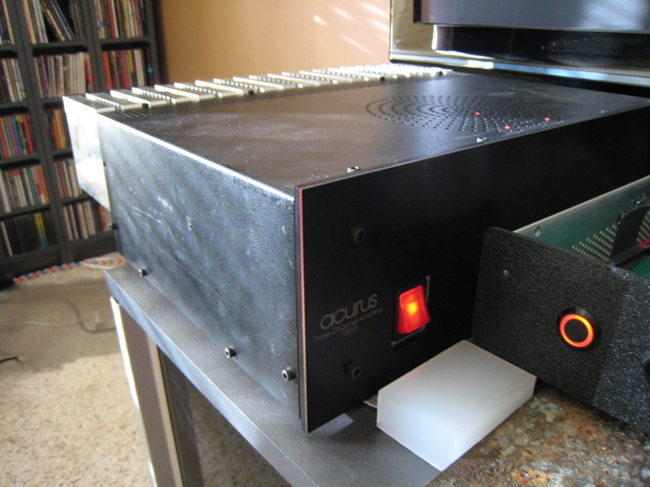

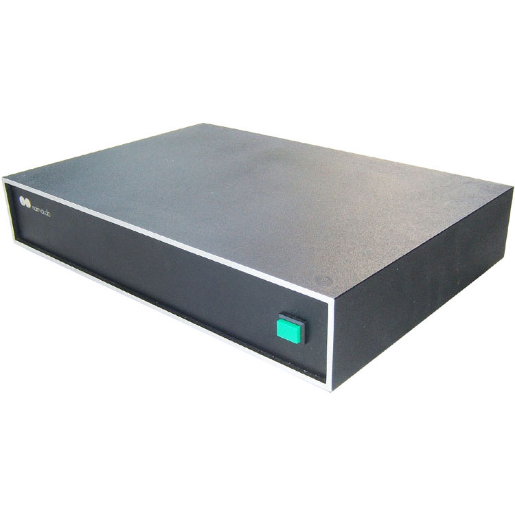

B. Pushbutton Power Switch
1) Panasonic ESB92S/D
https://manualsbrain.com/de/manuals/1103543/
https://www.digikey.de/product-detail/de/panasonic-electronic-components/ESB-92S21B/P8100S-ND/259552
3) Toneluck (often to find in some harman models)
http://www.toneluck.com/pdf/pwl-2p.pdf
4) Legion MPS11 series
http://legion.com.tw/en/products-MPS11.php
http://legion.com.tw/products/download/MPS11.pdf
5) Apem A1/AO3 Series
https://www.apem.com/int/a1-series-43.html?search_query=IP40&results=5
https://www.apem.com/int/a03-series-50.html?search_query=IP40&results=5
6) ITT-Canon (C&K) NE18 ("NE 18")
https://www.ckswitches.com/products/switches/product-details/Pushbutton/NE-18/
https://www.ckswitches.com/media/1409/ne18.pdf
7) Various (OEM)
Switchs mail order for Televisions etc, also tack switchs for computers etc.
http://www.pltv.org.uk/pictures/sw629.jpg
8) EAO 01 Series
http://products.eao.com/index.php?IdTreeGroup=1076

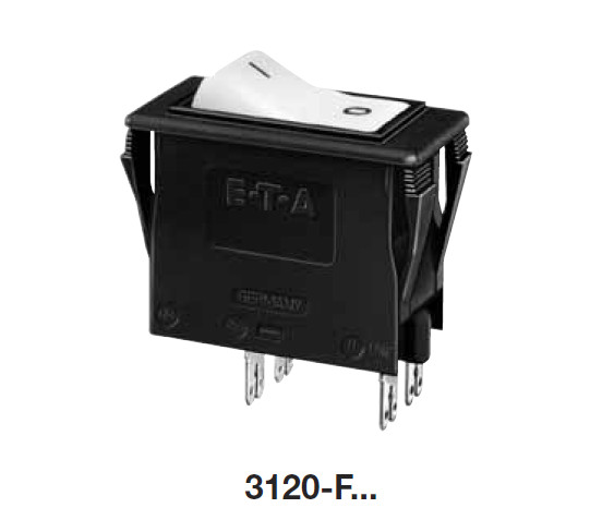

D. Rocker Switch
1) Carling Technologies C1005B Series
http://www.carlingtech.com/thermal-cb-c1005b-series
http://www.carlingtech.com/de/thermal-cb-c1005b-series
2) Cherry WR Series
https://www.jameco.com/Jameco/Products/ProdDS/577643.pdf
3) Honeywell AML34/36 Series
https://sensing.honeywell.com/AML34FBA4AC01-pushbutton-switches
https://sensing.honeywell.com/index.php?ci_id=142059
4) E.T.A. 3120
https://www.e-t-a.de/produkte/schutzschalter_sicherungsautomaten/thermische_schutzschalter/p/3120/
https://www.e-t-a.com/uploads/prodb/D_3120-Wip_e_230209.pdf

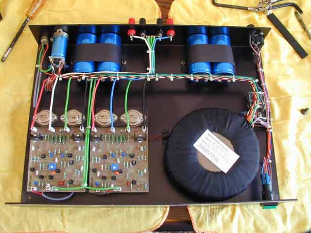

The decisive factor here will be the quality of contact material that need to process the voltage flash of inrush currents - particularly by large main toroidal transformers without inrush current limiter - so I think. Therefore the contact material is very important. Which of the follow is here the best ?
Ag & Ag Alloys
Ag/Ni
Ag/SnO2
Ag/ZnO
Ag/CdO
A well designed amplifier should not require a extremely heavy duty power switch as it would have an integrated inrush current limiting circuit designed in - there are several articles and circuits at https://sound-au.com/ showing the proper way to accomplish this.
