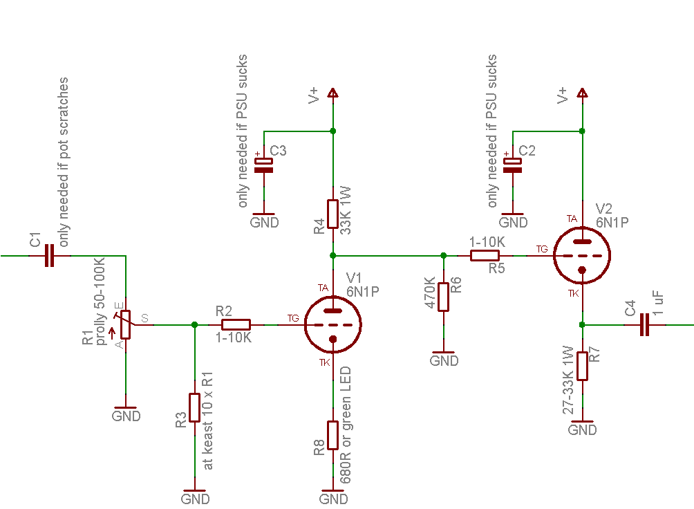

Here are some simple things to help this circuit out.the gain is way too high, i can only turn the volume up about 30% and then it starts to distort. it doesnt use feed back it is a dual paralleled single ended triode with a cathode follower.

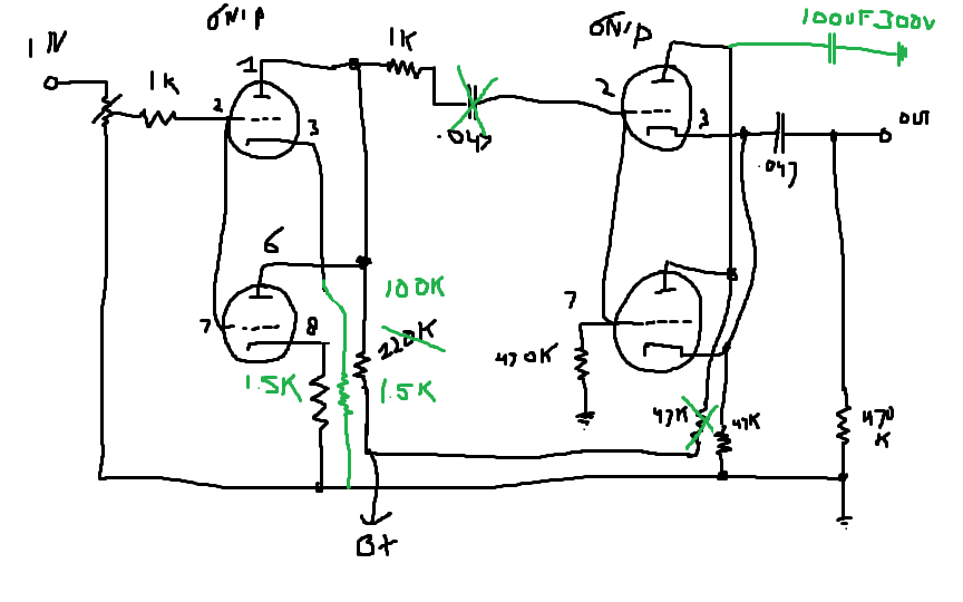

here is the schematic of one channel, the pot is 100k
Put a 100uf 350 cap to ground off of the plates of the 2nd stage. I would consider eliminating the 47K plate resistor entirely.
On the first two tubes, which are in parallel, install a 50 ohm resistor in series with each cathode. This will help the tubes act more as if they are in parallel.
You do not need the coupling cap between the 2 stages if you get rid of the 47K plate resistor in the 2nd stage. Again a 50 ohm resistance in series with each cathode of the 2nd stage will help those tubes work better together.
If it were me, I would replace the 220K plate resistor of the first stage with 100K. That will reduce the gain somewhat and give you better bandwidth.
Have fun- don't zap yourself.

thanks a lot for this advice. do you mean like the attachment here?
i followed an alternative schematic for the cathodes in the first stage using the 1.5k values, this cleared up quite a bit of hum i was getting. im still having a hum problem but i think that might be solved by reducing the filament voltage from over 7v ac down to 6v or so.
you mentioned using 50ohm? im not clear on this part.
dont need the coupling cap? dont i want to isolate the dc voltage of the first stage from the second and allow the signal to pass? im new to this im just testing my understanding which is very limited.
get rid of the of the 47k in the second stage. did i cross out the right one?
replacing the 220k with a 100k means that there will be less voltage across that resistor and more across the tube. is this right? wont this increase the gain? i dont know.
the 100uF cap to ground off of the plates in the second stage, what will this do ground out some high frequencies?

The cathodes of the first stage tubes will still be tied together. But the idea is to put a small resistance (50 ohms) in series with *each cathode* and have them join together at the 1.5K resistor to ground.
The 47K gets jumpered with a bit of wire, same for the coupling cap. The 100uf cap will ground *all* frequencies and insure that the plate is held at a constant point so that the tube will act as a cathode follower.
I would do something to get the filament voltage down as you will bake your tubes otherwise. That may help with the hum but IMO you need to lay the components out more carefully- less 'flying wires', keep your leads short, that sort of thing. Keeping the finished circuit looking neat is important as you will find yourself looking for the optimal layout to do so; if your layout is sloppy you can pick up hum, induce oscillation (which can result in hum) and reduce bandwidth.
BTW I would put a resistance of between 150 to 1000 ohms in series with each grid of each tube, which is known as a grid-stop resistor. There is one shown in the schematic tied to pin 1 of the first tube. There should be two there- one for each grid, and two more for the 2nd stage grids. That 1K resistor off the plate of the 1st stage should really be on the gird of the 2nd stage after the cap (which we are going to eliminate). Its things like this in the schematic that I think convinced others that the schematic was not right or else was poorly designed. Normally the resistor body is fairly close to the tube. This will reduce RF issues and often thus reduces noise. FWIW, no tube circuit can be expected to be competent without grid stops!

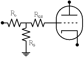

you said that there is a grid stopper resistor tied to pin 1 of the first tube, did you mean pin 2? pin one is the plate
thanks a lot
i found this diagram.
The grid stopper resistor RGS blocks radio frequencies while allowing audio signals to pass. This keeps the amplifier from becoming a radio receiver and prevents the stage from breaking into parasitic oscillation.

Would schematic help ? I drew one just for you. Unlike what you've got there it's actually suited to 6N1P tubes and shouldn't be just a distortion box. If you intend to keep the silly double tube with shared load resistor arrangement, halve the values of R4 and R7 (each tube sees same load so when paralleled, the combined load is 1/2 the load of a single tube).
This assumes supply voltage V+ of 200-300V.
I just noticed a typo: "at keast" should of course be "at least"
As for replacing R8 with green LED (which should improve gain and probably sound better): make sure you buy the cheapest example of low luminance low current matte dome kind that is avaliable to you (the more expensive high luminance bright green types have considerably higher Vf and will again bias the first stage waaay into non-linear region). LED must light up when circuit is turned on - if it doesn't, you've got its polarity wrong and you must reverse it.
