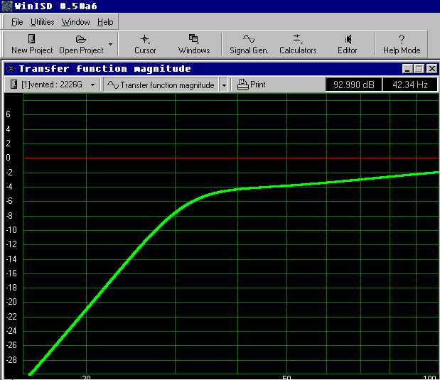

i have a jBL 2226 in 33hz 175L heres its response=
it sounds very nice!.
in my 2.2mx4m room with low ceiling,the walls vibrate noticably with 20watts.
im interested in measuring my SPLs at various positions
should i just use sinewaves,note each SPL at measured positions and then compare?
the subs in a corner position
when i get SPL meter i will do this and post results perhaps.
cheers

Room Frequency Response Measurements
should i just use sinewaves,note each SPL at measured positions...
In my opinion, room frequency response measurements are generally speaking somewhat delicate. Pink noise and RTA measurements are often unreliable. Our ears tend to ignore late reflections in the treble region while adding some weight in the mid-range and even more weight in the bass region. So, theoretically an adaptiv room frequency response measurement should be used, which excludes most room reflections at high frequencies (except approx. the first 10 ms), includes more reflections in the midrange and includes nearly all room reflections in the bass region (up to approx. 200 ms at a frequency resolution of 1/3 octave).
So, your proposed measurement setup may be all right as long as it is limited to the bass region (up to approx. 150Hz) and you smooth out room modes manually.
