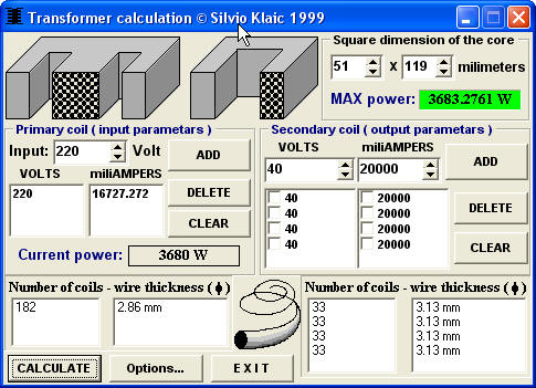

is this softwares perfect?

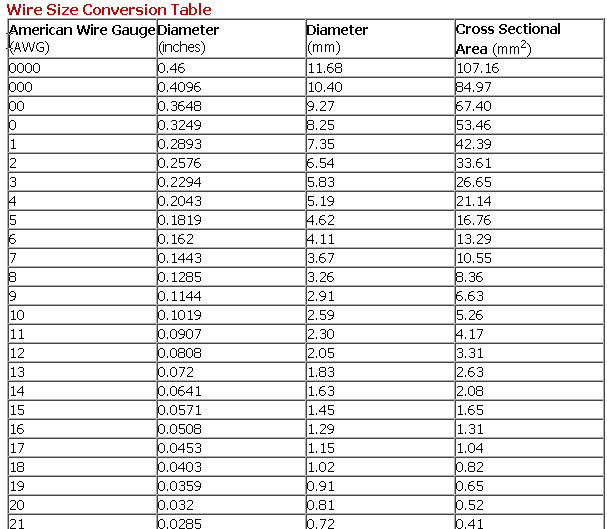

what is cross section in awg table?

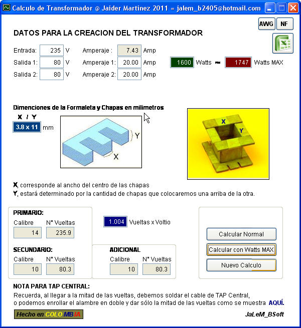

the left pic must be wrong.
Those X & Y dimensions must be about a factor of 10 in error.
Could it be he has his mm and cm mixed up?
The middle pic seems to be right I have used it to estimate EI transformers I have bought secondhand or inside existing equipment. One part missing from Klaic' software is choosing the working flux.

the picture on the left must be in cm not mm as shown, otherwise the calculations are okay.......

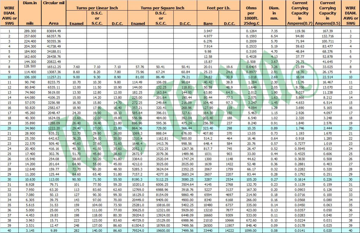

cross-section area = (2pi x diam)/4 = (6.28 x diam.)/4, it forms basis for current density in your copper, i am used to imperial units, i use 500 or 700 cm per ampere current density. the ARRL handbook has this nice table to look at...

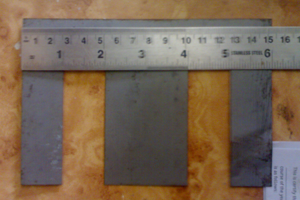

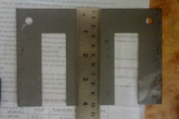

sir Tony, I have this CRGO core, and size u can see,
can u tell me about winding to get 80-40-0-40-80volts at25 amp?
Thank u

When I look at Sandeep's pictures we deal with an EI 150 core.
Standard stacking heights for this core (with respect to available bobbins) are 4.79 cm, 6.49 cm and 9.09 cm.
Presuming good quality core material of 0.35 mm strip thickness secondary power for these cores are 560, 730 and 940 watts respectively.
Afe (effective core area) 22.2, 30.1 and 42.1 cm² respectively.
Please note that effective core area is less than stacking height x tongue width.
Number of primary turns for 1.2 T and 220 VAC/50Hz 370, 275 and 195 respectively.
I did not check currents (with respect to wire diameters).
^the width of the lamination is 6 inches in the drawing therefore the tounge width is 2 inches....
stacked to 4 inches and you get a core with 8 square inches, stacking factor of 95% gives you a core area of 7.6
