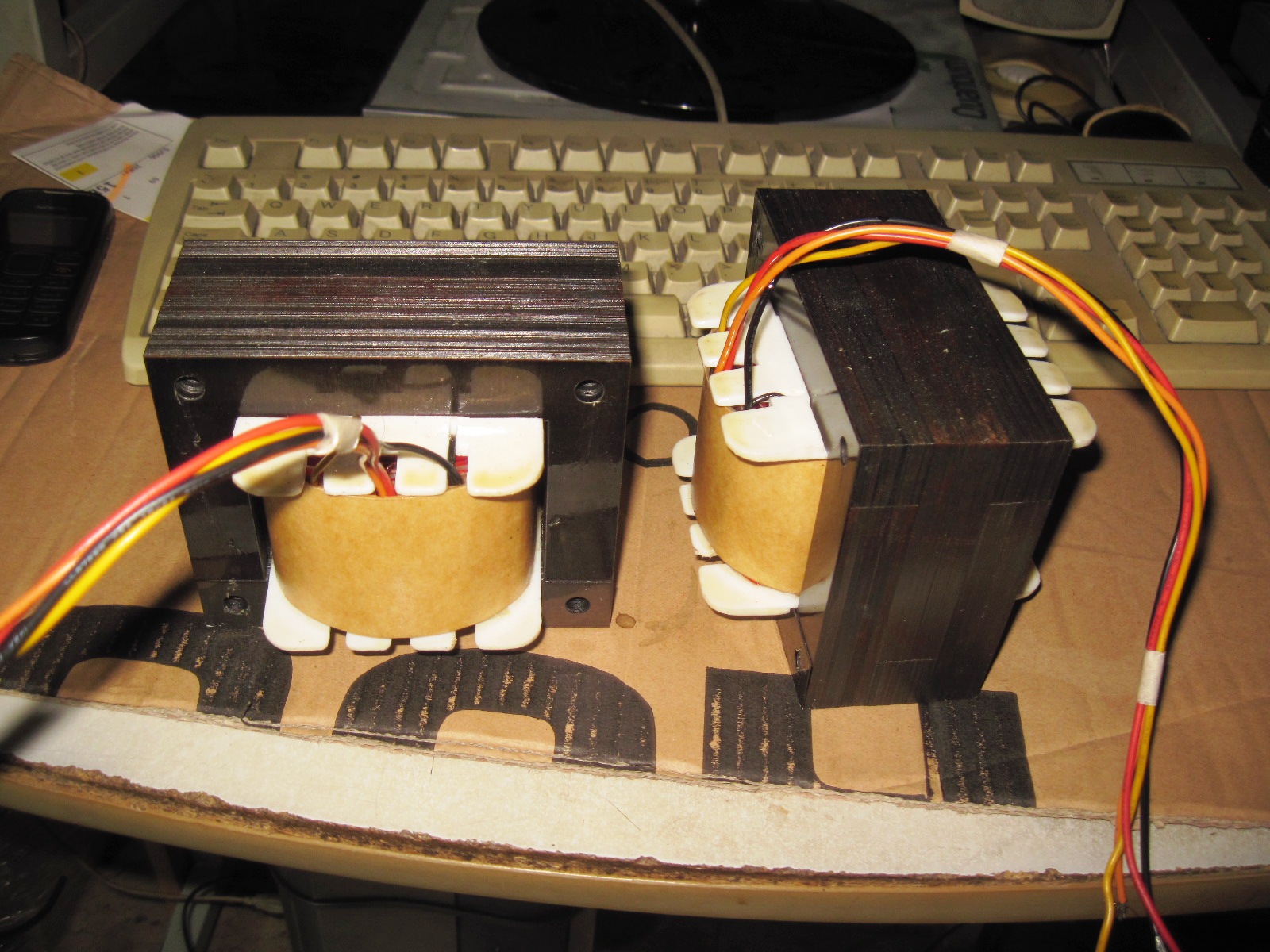

@Turbon, nice bobbins. did you make them yourself? sectioned bobbins make winding faster and insulations are easy....
Thanks Tony.
Yes, homebrewed. The coreparts and the outer walls are 1mm epoxyboard. The intersections are of 0,5mm. The output shall be 2*360V 400mA. I'm trying to figure out what would be the most useful 5 taps to make.
Regards
Thanks Tony.
Regards
Well, the question about taps has already been answered - for experimentation - use a variable mains transformer...
Regards
Right, minor adjustments needed. Then it is time to epoxy it and maximize the stack. I have been able to stack to my goal of 81mm but I can probably squeeze in at least 1mm more. I will keep the intersections movable as I haven't decided the maximum current yet. I planned for 400mA at 720V divided on 2HT windings but I think that it could be made 0,5A instead. Not sure yet...
