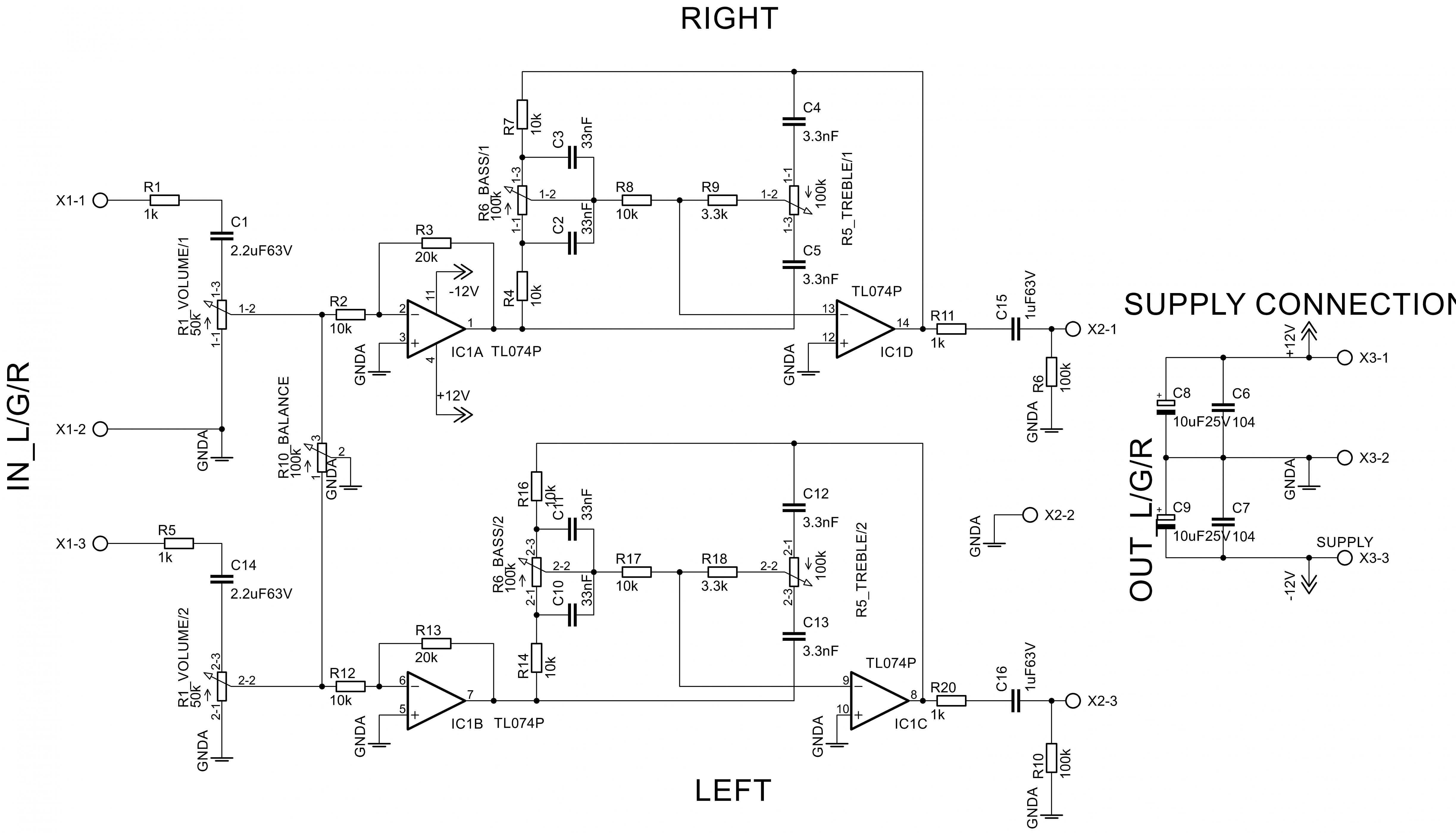

Hi all,
Here is the modified schematic as per your suggetions. Hope its all right this time. I have used a 1k resistor at input before vol control and 1uF coupling cap at output.
regards
prasi

Seems ok, but it depends. What are your source components and their impedances, and what is the output component and its input impedance?
Hi Rayma,
I am planning to use a general purpose DVD/Blueray player as the source. on the output side planning to use the DIYAUDIO
honey badger amp / APEX kelvin amp.reg
The source should be ok. The honey badger has around 25k input, so you'll want at least 1uF for the output cap.
If the other amp is also fed by the circuit, the cap would need to be larger, maybe twice as large.
I would increase the value of R10 to 100k or more, as it needlessly loads the output cap.
Remember to use small decoupling caps near each op amp's supply pin, around 0.1uF.

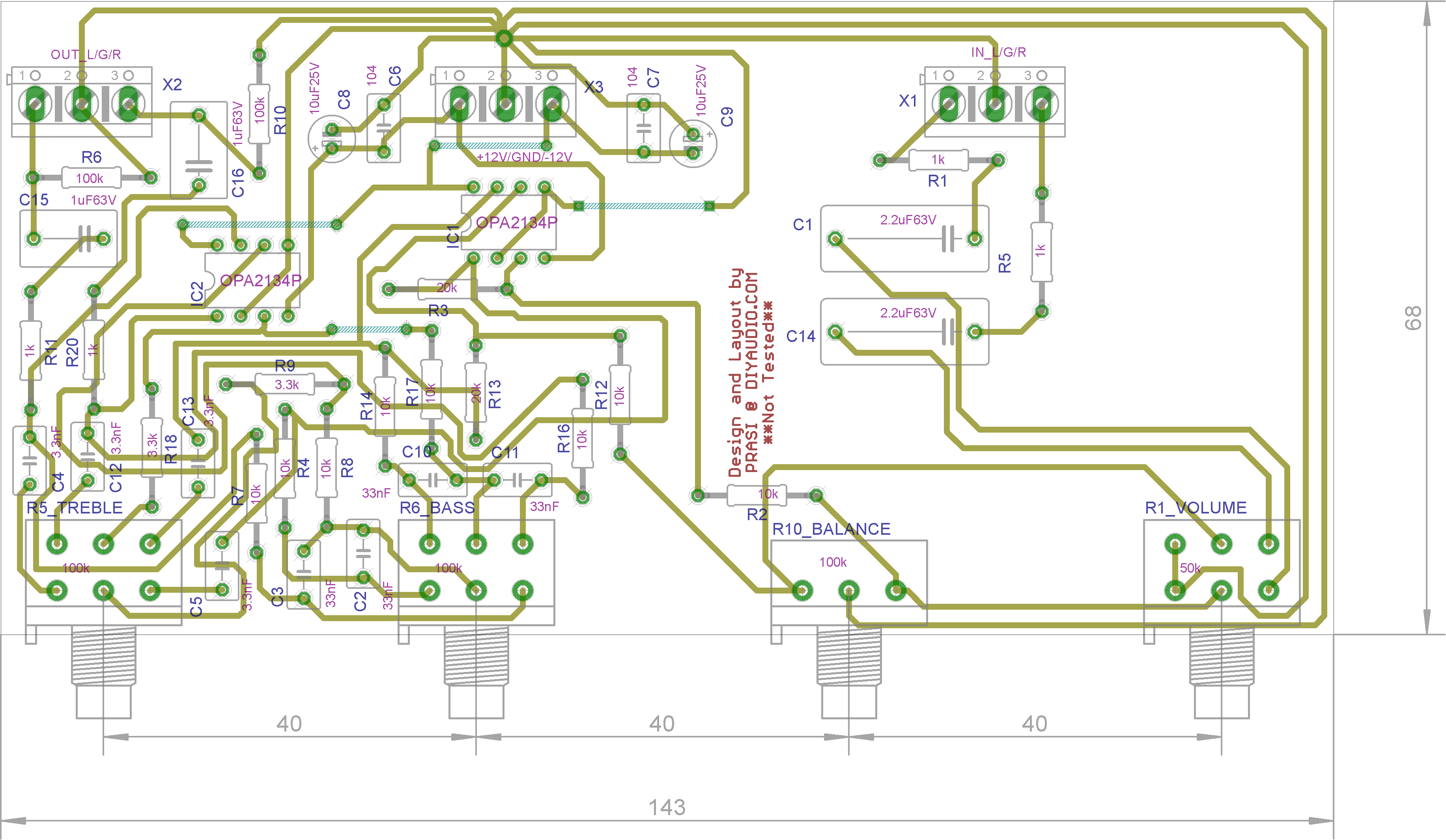

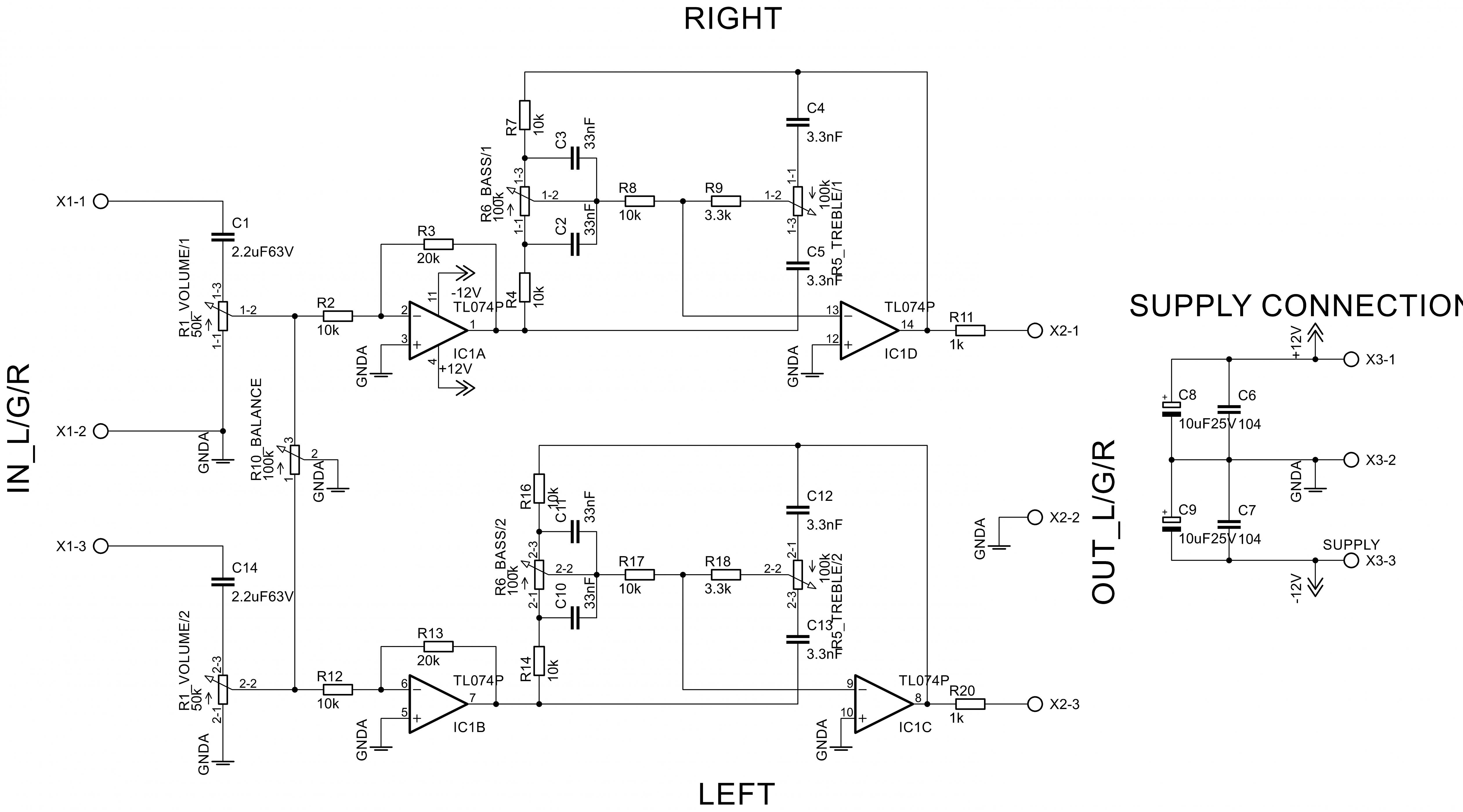

Hi Rayma and others,
Finally I was able to layout the PCB. I am attaching the layout (and the final schematic for convenience).
Appreciate very much if you can suggest improvements/corrections.
some design values and considerations that went into the layout.
1. pots to be pcb mounted with adequate spaces between adjacent pots for operation of knobs(of reasonable sizes).
2. width of the traces is kept as 0.6096mm (24 mils). Hope this is sufficient for current levels.

The trace widths should be ok. The two channels usually are kept more separated from one another. Is there a constraint on size or shape?
Also, when there is no ground plane, the ground routing is best kept as compact as possible for each channel to minimize parasitics,
and then the two channels' grounds can be connected at the main power capacitor or regulator.

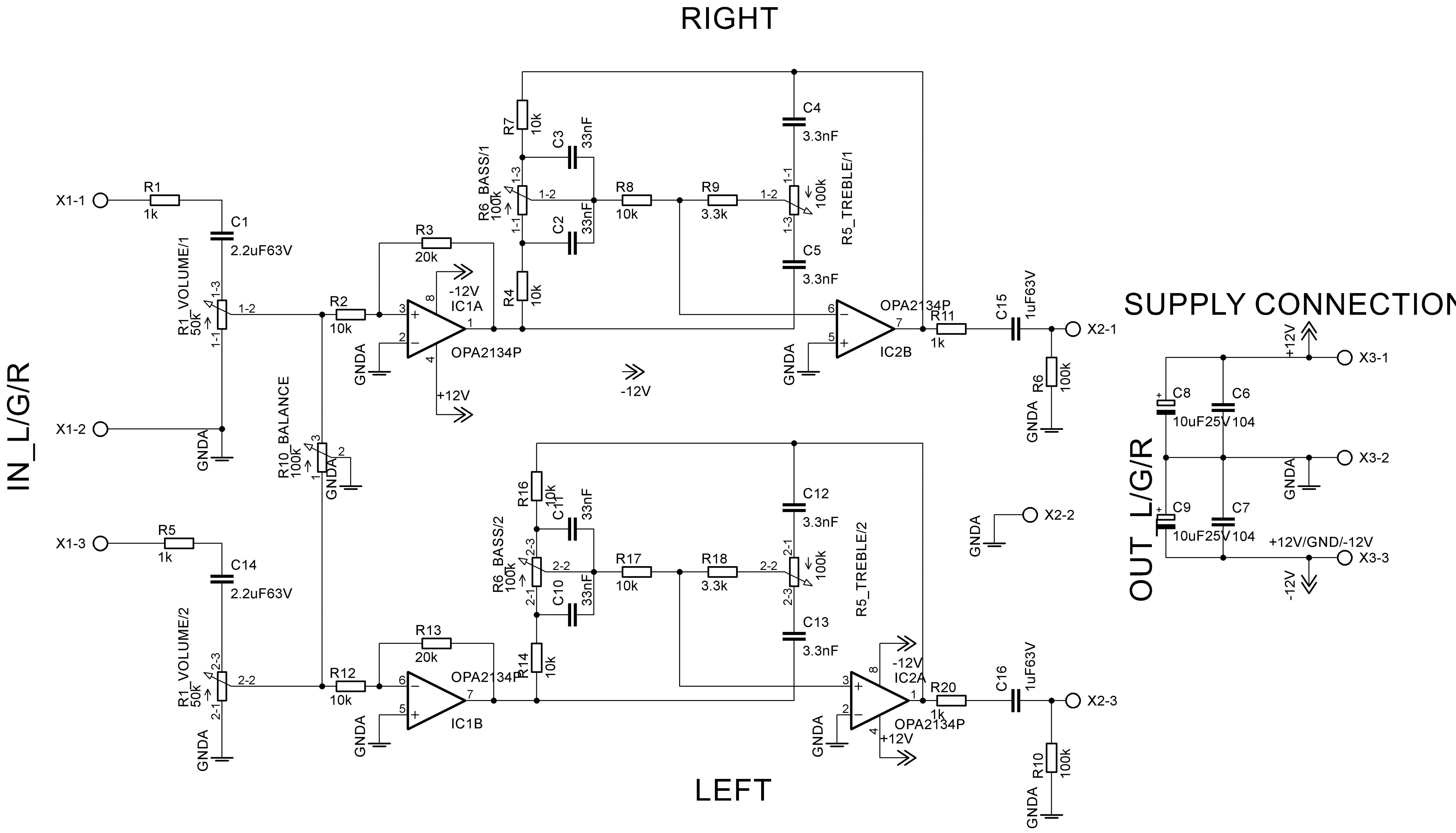

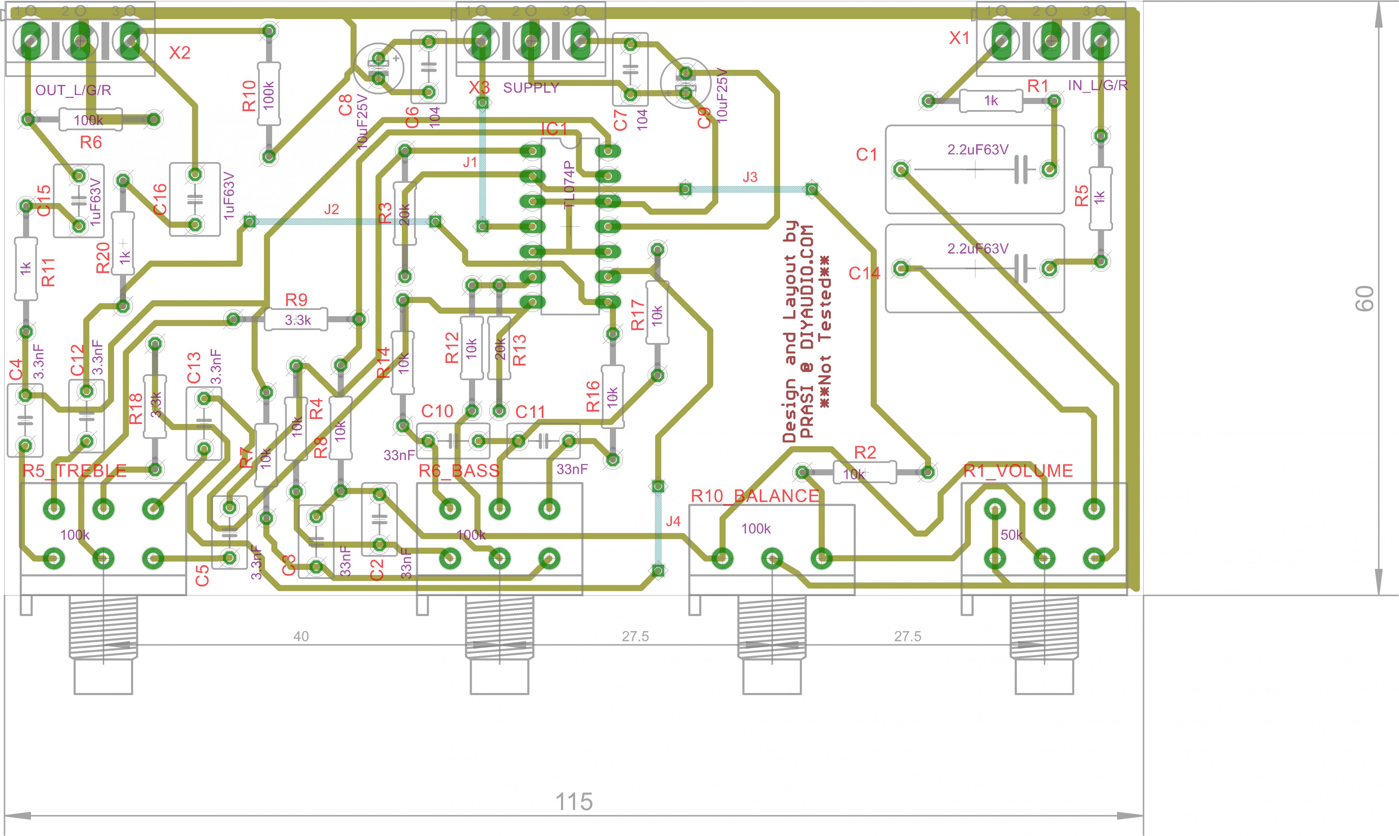

I have made a second layout using 2 OPA 2134 and tried to the star grounding scheme. Although I have not separated left and right channel grounds, I have tried separate power ground and joined all at the power entry point. The schematic and layout attached.
Any comments ?
There should be small decoupling caps right at the power supply pins of each op amp.
I'd try to shorten the balance and volume control grounds. You could run them to the
left of the input caps, and move the signal trace that goes between the balance and volume
controls lower to make way for them. Also I'd separate the volume control grounds,
with a trace for each going to the main ground. Is there a reason that the channels share a
ground, both at the inputs and outputs?
OK will do. can polyester 104 should be ok, right?There should be small decoupling caps right at the power supply pins of each op amp.
OK. will do. I think now I got the hang of it on exactly how to do it.I'd try to shorten the balance and volume control grounds. You could run them to the left of the input caps, and move the signal trace that goes between the balance and volume controls lower to make way for them.
there is no reason why they share a common ground. I had, in my earlier pre-amp twisted the left and right ground wires together and inserted them at ground i/p. there was no issue with any hum/noise. that's why i thought it might work here also. here is what I will do. I will use three separate grounds, One for left channel, one for right channel and one for power and then combine them all near power i/p at a convenient location.Also I'd separate the volume control grounds, with a trace for each going to the main ground. Is there a reason that the channels share a ground, both at the inputs and outputs?
