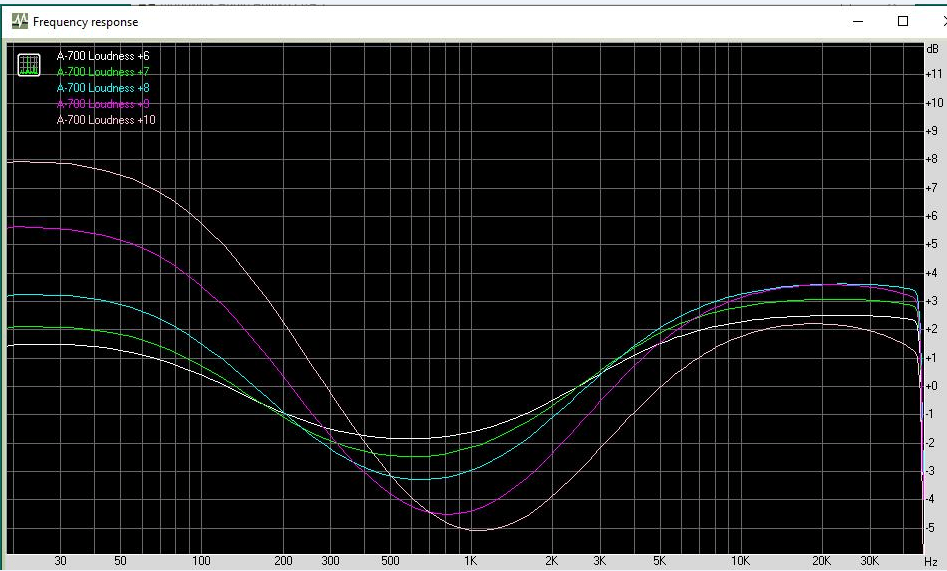

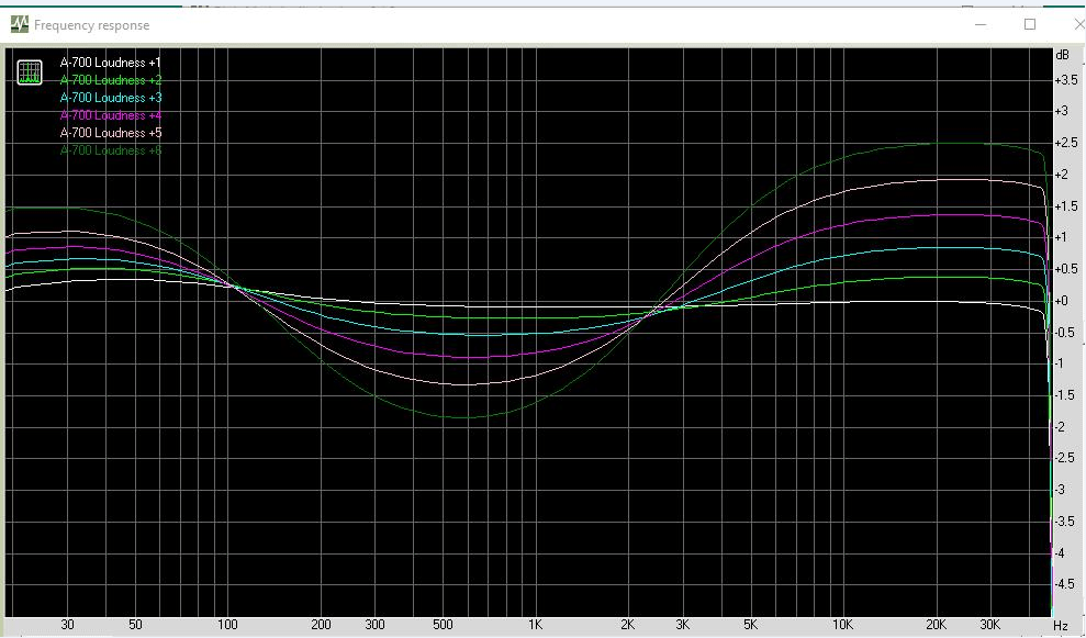

Yamaha variable loudness has been mentioned earlier in the thread - here is what it does on A-700:
positions 1...5:
positions 6...10:
Personally I consider it a good option to have available provided that the listener is not in the "direct only, no tone controls" camp.

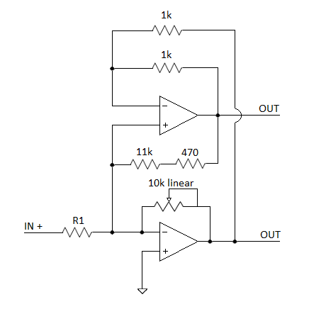

This might be a good volume control to build a loudness network around.
The circuit is an active balanced volume circuit that supports a customizable log curve. If one wishes to use the circuit unbalanced, they also may do so. The key point is its excellent attenuation behavior for low listening levels. This was meant to address the sensitivity problem that several builders in the Preamp from Linear Audio # 5 thread had noted. The circuit shown below offers a truer curve than a linear pot with a resistor from wiper to ground, and is better early in the rotation than many expensive audio taper log potentiometers that I've measured, and it has a constant input impedance.
The 10k potentiometer is the volume control. The 11k and 470R resistors allow fine tuning of the log curve and one could be replaced with a multiturn trimmer pot; higher combines values (a single resistor can be used, if you wish) result in a more linear curve; and lower values exaggerate the log shape of curve.

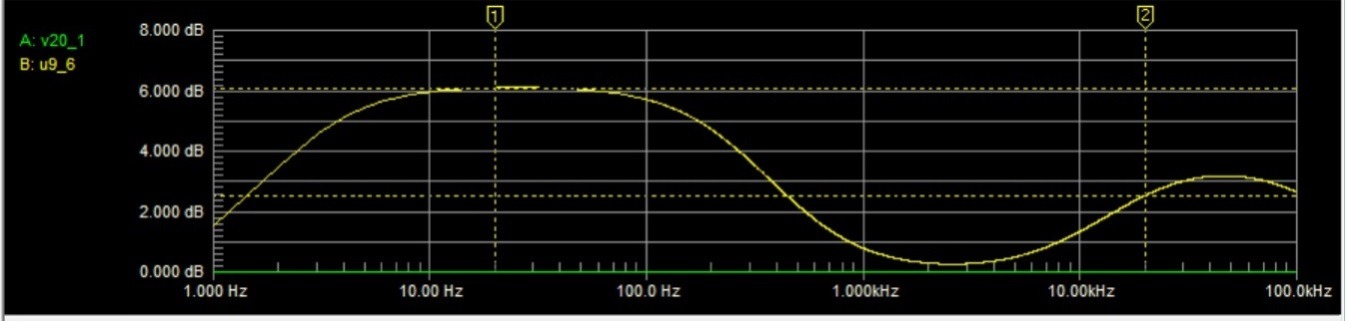

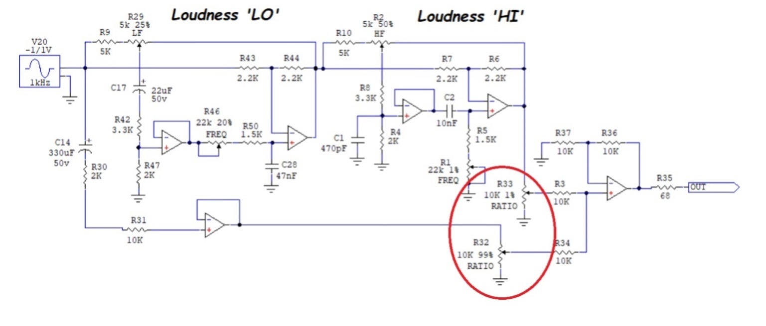

I spent a couple of hours modeling my proposed loudness control in my ancient copy of Circuit Maker software. Below is the result. R32 and R33 pots (circled in red) form the contour control. The pot segments are wired opposite of one another so that the resistance increases on one while reducing on the other. A four gang pot is required for 2 channel stereo. Rotating the contour pot counterclockwise 100% passes only the unequalized signal and none of the loudness corrected signal. As you rotate the contour pot clockwise the ratio of equilized to unequalized signal increases. The gain and slope frequencies are adjustable for both the 'Hi' and 'Lo' portions of the loudness correction. My goal was to make all elements adjustable, at least for the prototype. The loudness EQ portion of the shown filter circuit is lifted from the recent article in AudioXpress by Douglas Self.
I have not actually built the circuit. I've only knocked it up in Circuit Maker. Circuit Maker predicts the filter behavior shown below. Assuming that I have time, I plan to build it during the holiday break. I invite any and all interested parties to make comments.
