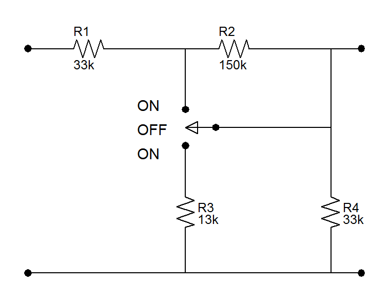

For whoever said it, a triple throw switch would have three electrically connected positions in most cases. But some companies do not follow that convention and include an open center position.
And while everyone is fighting over semantics over the way to describe center off, and ON-ON-ON switch implies the the center position leaves both end poles connected to the common. A shorting switch in other words. Such a switch might be used to select one pickup or the other on a guitar, with center position enabling both.
