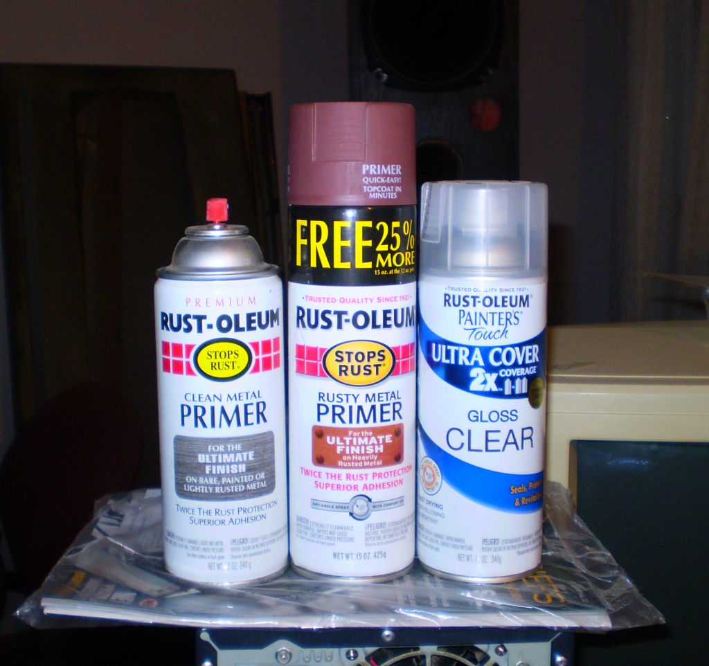

This is extremely useful Jer, thanks!
Looks like I'm headed back to the auto parts store for etching primer and regular primer (red). On Rust-Oleum's website I see only one Self-Etching Primer as per link below. It is dark green in color and has Carbon Black as an ingredient. Is this an appropriate product to use? Or is there one you know of that is red or clear?

The etching primer you describe is the stuff as it has Titanium dioxide as the pigment and it comes out as a grayish green color.
It is okay as it is the very first coat.
I don't know of any other colors for this type of primer.
Hanging the panels is okay but you may have a better result laying them flat on some sort of standoffs.
This will help you to get around the panel easier to make sure the holes are properly coated on the insides of them.
And it will help you to avoid any runs in the coating.
You will also have a more consistent thickness of the coating across the whole area of the panel as well.
However works best for you as long is you don't create any runs.
You want the paint to go on wet so that it flows out but you don't want it to flow too much (you know what I mean).
Also how ever you choose to mount it for painting don't lean it up or let it touch anything before the paint is fully cured!!!
I was in a hurry one day and I didn't set my panels up properly to cure and in a mater of just a few minute they had stuck to the box I had them in and it peeled the paint right off trying to get them unstuck from the box!!
Luckily it was not in a critical area and I was able to redo that one section.
Another DIYer had done the same thing not too long ago and he wasn't as lucky and had to start all over again!!!

For the clear coat it is cost effect to use the Thicker 2X or 3X stuff if you are using spray bombs.
At one point I had found some regular clear off brand paint at the now Defunct Pamida stores for $1.87 a can and it is the very same paint as the Rustoelum brands as it tested the same voltage wise and it is just clear acyrlic enamel.
That was the very same paint that I had used on my sample window screen stator.
Menards and in my area has the best price on a can of the 2X for under $4.
I got lucky one day when Mejiers had %25 more cans for the same price as the regular ones!!
I think I listed all of the UPS codes in the coatings thread in this post,
http://www.diyaudio.com/forums/plan...tric-coatings-fact-fiction-2.html#post2894629
I was using some Sherwin Williams etching primer at the time but on my new build I used Rustoleums Clean Metal Primer #7780.
According to the MSDS I believe it is an acid based primer therefore an etching type.
