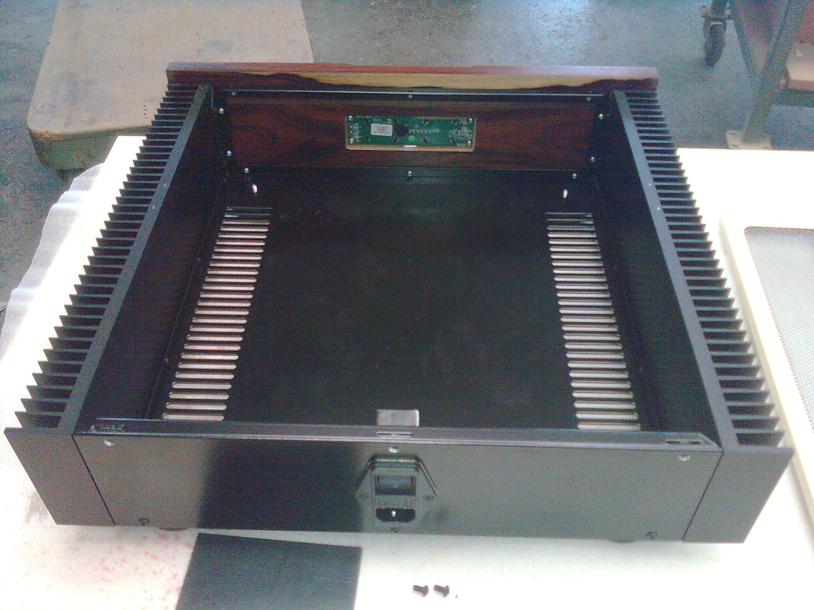

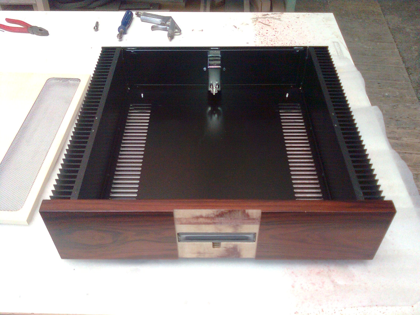

Gentlemen, I have just received a couple of images showing the case that Gerhard, my favourite carpenter, will send me by the end of this week.
The three pictures on the left showing my "Integrated Amplifier's Case", the other 2 images showing the R-PRE Case!
I am absolutely impressed by Gerhard's craftsman's skill and cannot wait to put my current NJW0 - SYMASYM (last picture) into his case.

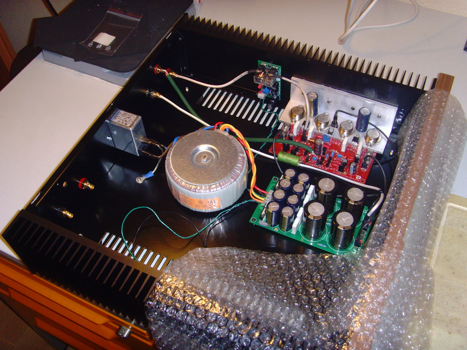

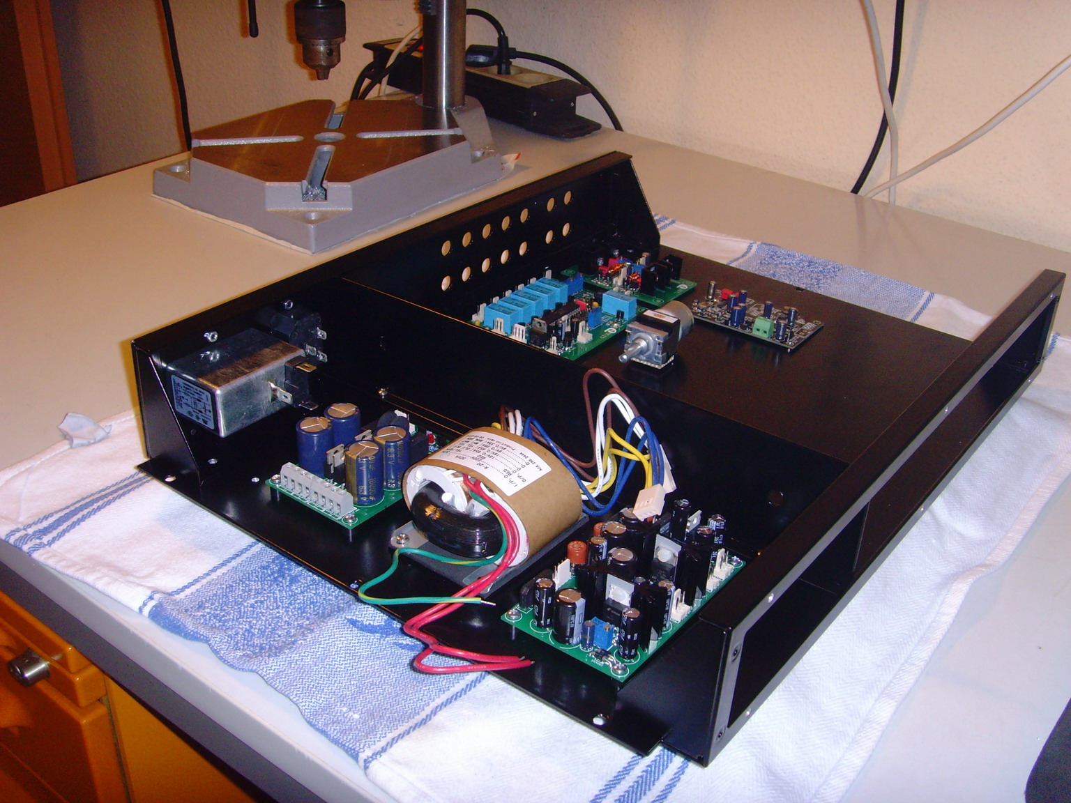

Gentlemen, I am the first one to receive the cases having ordered from Gerhard, my "favourite carpenter".
See my previous post!
I have started with the Pre-Amplifier's case, housing my R-PRE, a modified version of CALVIN's line-buffer (layout of which has been done by myself) and Jean-Paul's DAC V2 - see 1st attached image.
You see a Schaffner Main's filter (with Power-On Switch and fuse-holder), followed by my "Soft-Power-On & DC-filter", a 30VA R-Core and the very nice PRE-PSU (being inspirated by Rephil!)
Gerhard's case is a lovely piece of workmanship, and I have never come across a case like this before.
This case cannot be compared with the soulless modushop cases!
I have asked Gerhard to provide me a separation plate (which I will paste up with some kind of µMetal) and an individual rear-plate. He did!
I have already finished his front plate (2nd image) and the PSU - section.
Gerhard's cases are "gems" (they are not "for nothing" though!), and I will go on very slowly and carefully with them.
Best regards - Rudi_Ratlos

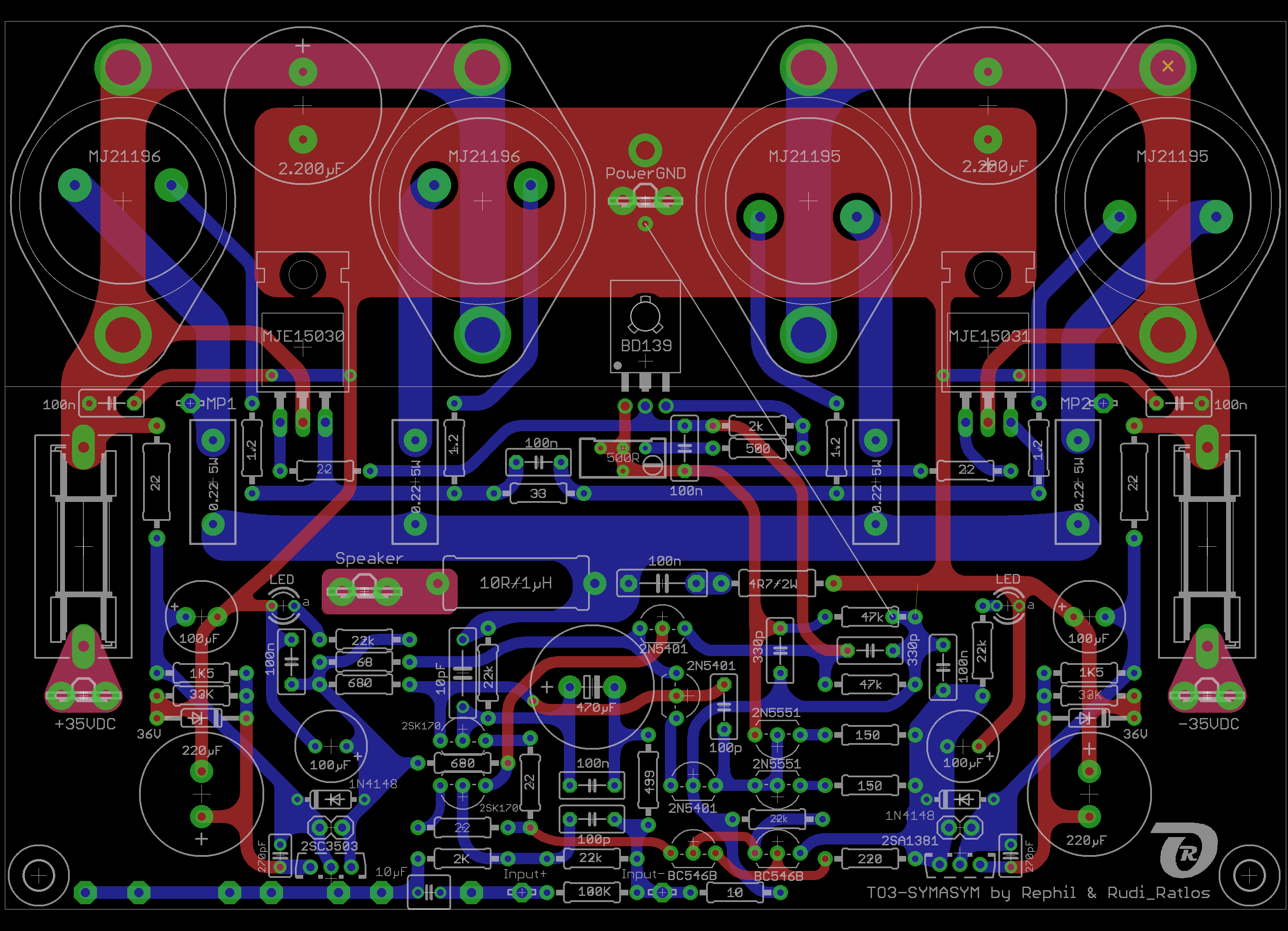

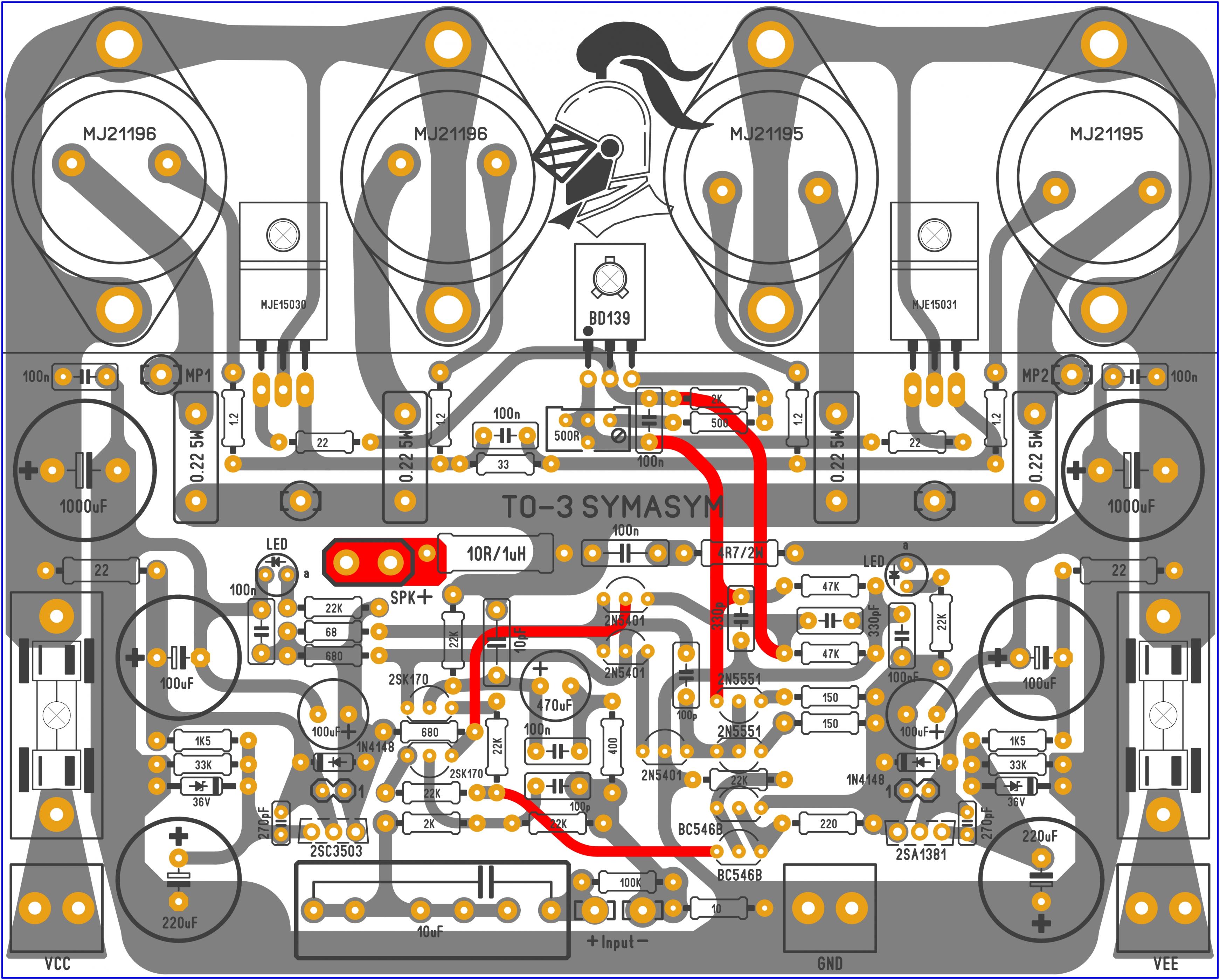

I like TO-3 transistors for a long time and I love the design you made of TO-3 SYMASYM here is a copy of a file you post for diy and what I did is just copied the best I can and I love it and thank you for share the file I don't remember in what post number lol , I love your work man also the new layout for this year

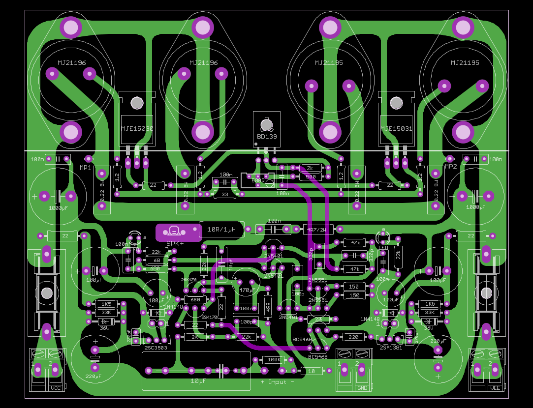

But, Juan, this layout is long, long time ago!
I am happy to get rid of the "loops, the deadly power and GND - embraces"!
There are none on my current layout.

I told you to go and read a Thread that specifically discusses LOW LOOP AREA............ I didn't know about the GND loops ? ....................
You replied that you would go and read.
Adopting better layout practice would cure the layout errors that you incorporate in all the layouts I can recall seeing in your posts.
You are not alone.
The vast majority of layouts whether for PSU or pre-amps or Power Amplifier ignore LOW LOOP AREA as something that needs due consideration.
One reason I do not use a PCB for PSU is that direct wiring gives a lower loop area.
The main reason is less cost.
But it's nice when less cost = better performance !

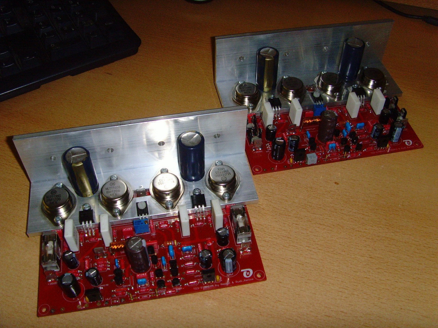

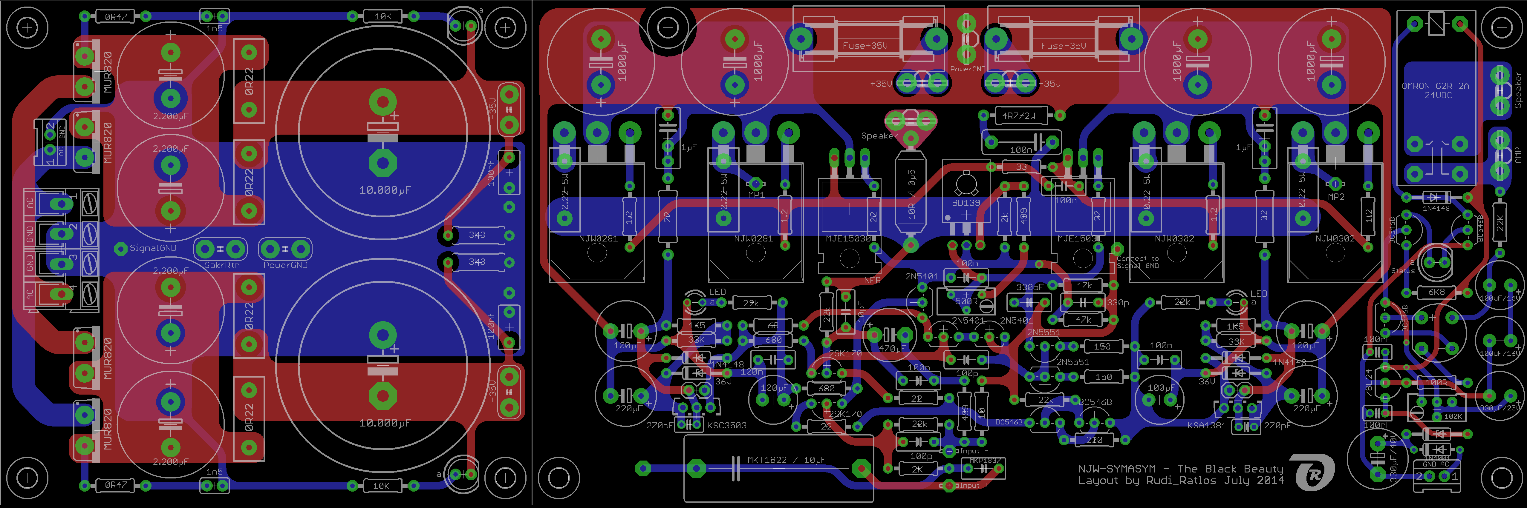

Gentlemen, I have promised to Gerhard, who is my favourite carpenter and who has developped a series of very nice Audio-cases (as an example: image 1 shows his "small amplifier" - case)
to layout a new SYMASYM PCB that can be mounted directly on the heatsink - side-panels (see my post #861, which also shows the prototype of this new PCB) of his case.
In the meanwhile I have "optimized" the layout to include a speaker-protection circuit and a backend-PSU as well!
Don't call me crazy! I have layouted this big PCB in order to reduce the tooling-costs that the etching-company will ask from me!
The new PCB (image 2) contains 3 sections:
1) a backend-PSU (the schematic is given in image 3; if you want, I will cut it off the rest of the PCB)
2) the SYMASYM, which will use NJW0 - output transistors that (as well as the drivers and the BD139 TEMPCO transistor) need to be mounted beneath the PCB
3) the speaker-protection-circuit on the right side (you need not populate this section!)
The size of resulting PCB is 254 x 83mm.
I will give it the best quality available: 2mm FR4 PCB, 75µm copper, Gold immersion, black(!) soldermask and white silkscreen.
This big high-quality PCB will have its price though: 17€ (remember: the PCB contains 3 different sections!).

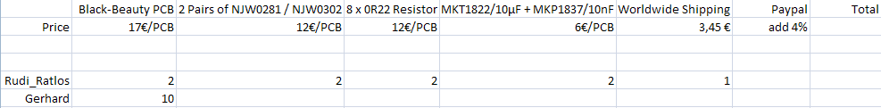

I'm interested in having a Stereo-Pair of the Black-Beauty with all off the hard-to-get components. But please list them for me with its price. (I'll decide, if i buy everything later; weitere Bemerkung: Bezahlung nur per Überweisung)
Best regards - willNamennichtnennen
Sorry for my bad english.
On my phone I cant see the pricelist as I should.
