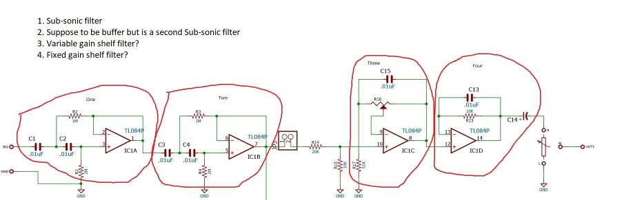

So with the help of a friend I ended up just redoing the circuit on a new pcb. However I have a couple of questions..
What does circle 3 and 4 actually do? I "think" they are shelf filters that do similar to a Linkwitz transform but I figured I'd ask people who know more than me.

'4' is simply a unity gain buffer. The cap and resistor don't really serve any useful purpose as drawn and could usefully be linked out.
'3' is some kind of filter and would have a response like a shelf filter with the gain falling past a certain frequency point set by the pot.
Yes, they can have a purpose similar to an LT, but why do you ask? I think you should already know what you are trying to do. For example you talked about HF section but I don't know its relationship with posted image.
I don't think there is 'magic' or 'rocket science' with such circuit (except the fancy box). And to utilize it is not simple as to work properly it must work with other elements of the system. See the pots? How will you adjust the pot if not using proper tool?
I say, build something new. Define your objectives and you can always get free circuits from the net.

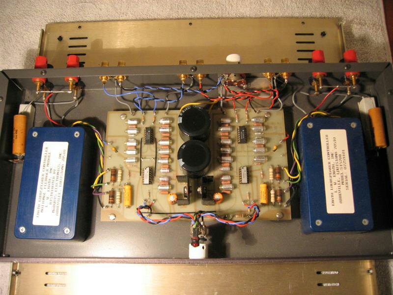

As you can see in the picture, circuit boards have come a long way since that was produced.
And like computers the technology has gone full circle. I want to push the electronics back into the speaker like the originals. 2027262933.jpeg

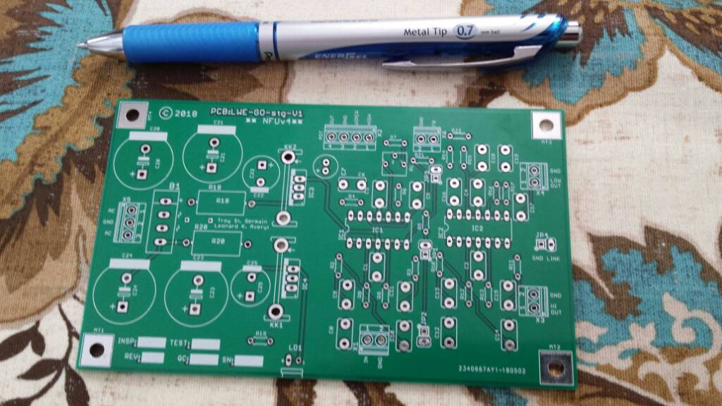

This is a new prototype pcb I had made off the original schematic. I plan to start stuffing them today and testing them this week. However I am trying to understand the circuit better. It is not my design and the audio genius who designed it has since passed so I can't ask him. Therefore I go to the next smartest people I know. The group collective here on DIYaudio. 1530450457047.jpeg

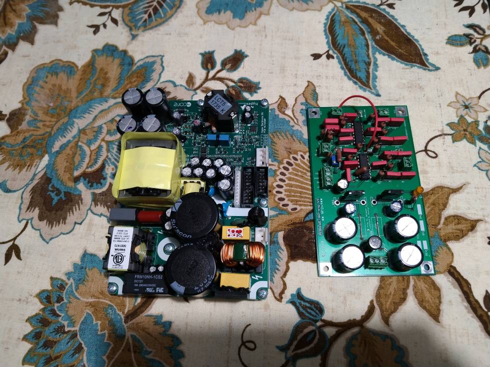

And these are prototype pcb's based off the original. Once I know it works I would like to see if I can improve certain aspects.
Layout, noise levels, component organization...
The actual negative feedback circuit for the woofer works like a charm and sounds fantastic.
It's the high pass that is the issue(noisey) and the desire to make active speakers that drive this project.

The new circuit does work and I am in the process of integrating it with the amplifier modules.

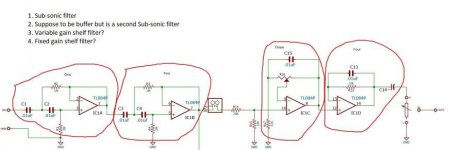

But a quick question on the "shelf filter" circuit.
Attached is what I think is the shelf filter to give the circuit it's 12db/oct boost below XO frequency.
If I open/remove the capacitor will it be just a gain stage? I need to defeat the boost/shelf function for a test but want to be sure first.

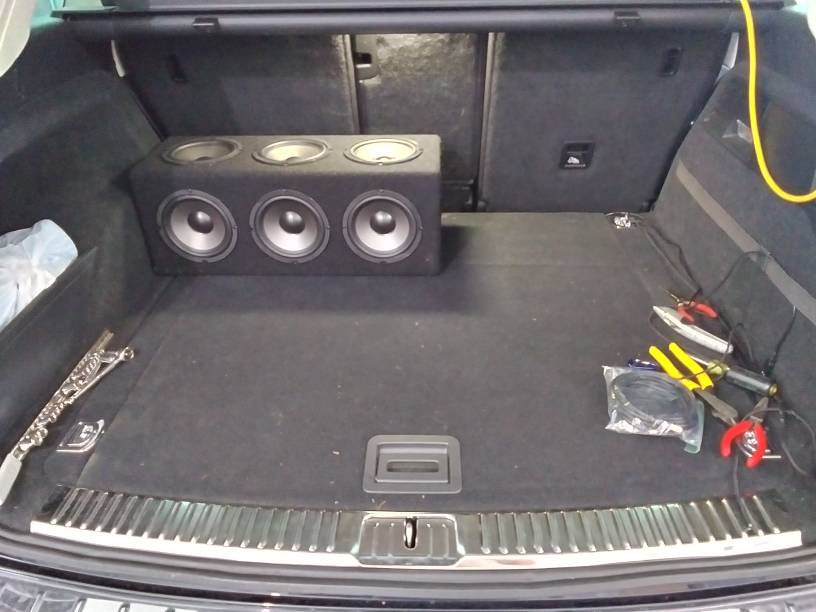

I lifted the capacitor in the circuit and it worked as hoped. Sort of. I think in the car the full shelf filter is TOO much (too much infra sonics no midbass) but a little is needed.
I will put it back in the circuit and put another resistor in parallel to the first to keep the shelf filter but reduce the level of the circuit.
Another question, the potentiometers are VERY scratchy (30+ yrs old) but instead of changing them out I would like to use fixed resistors and set the gain at about 1/2 - 3/4.
Should I put a 10k from IN to GRD and a 3-5k from IN to WIPER(out)?
