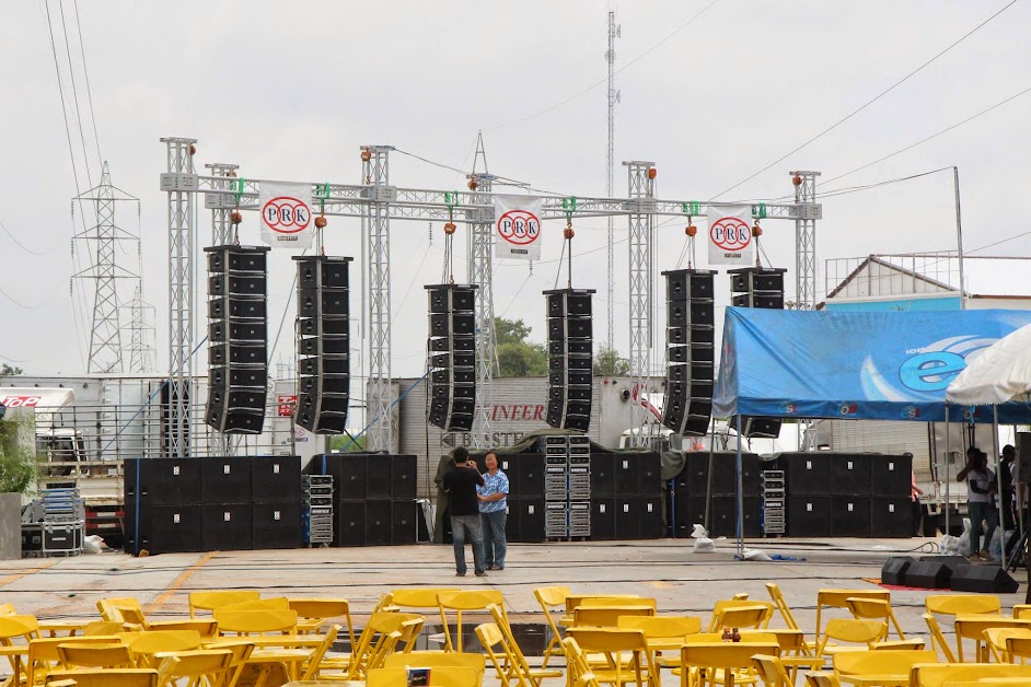

guys after finished an test fph . my friend brough them to khonkean province for pa meeting. lot of brand went to there. some brands are thai. n some from china product or oem from china. the khonkean is far from my location about 260 km but when go there it will slowly. the highway hv lot of mountains. about three hours if drive the car. ok enjoy with the pics

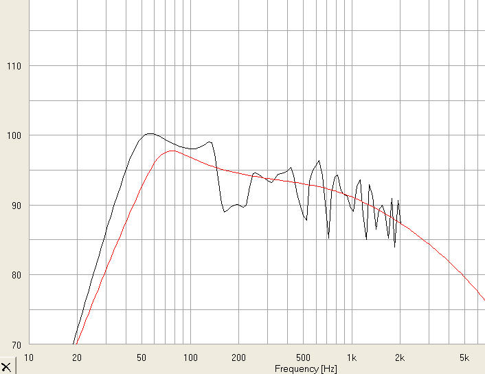

yes it can work. sadik if u dont waist space. u can do like this. the cab u posted it hs a good point. a few pair of them are very loud. but one thing u must learn how to design before
Yes , I know i have to learn a lot... This is just my idea, I have observed many horns, and after understanding the Shapes of them i had a strike in my head, took a Pen and a paper and made the sketch.
As you can see the Rear Chamber has more Volume & Path length then the Front one, I thought this will help to generate more SPL of Bass Output, Where as in Front Chamber, I thought the First Length which is more Compressed will generate more SPL. (its just my thinking, may be i am wrong)
I have never used any software to design an enclosure, because i don't know how to use them, so i do not have any experience to stimulate the same in Software.
And by the way thumps-up to you Brother ... U r excellent. Loved your work too much.

the simulation guys, the sound is very clear when compare esw1018
What about compare vs simple basreflex?

the knowledge u can get from the comparsion. because everything is deference. it makes u know better. u will have the experience from u do. try to use the software its not difficult to learn. u can learn from people on here post.
No i dont compare but lot of my design i will know that it will be. ok i try compare
