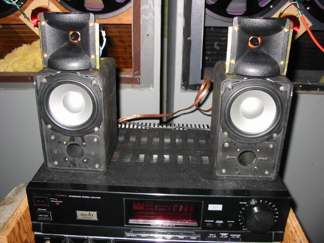

Hi Goldy,
I have recently used this small driver
Vifa 4.5"
With this horn mounted externally,
CD horn
and some heavy resistors, I got very nice dispersion and imaging. I was very pleasantly surprised. From about 12 - 15 ft away, a bass wave seems to develop nicely and sounded good even without a woofer. Anyways, if you remember the Realitic Minimus 7's, well these are a step above them.
My girlfriend was impressed.
Her cat was not. Kept nipping at my leg during "testing"
They are not quite as shown as I have blocked off the port.
