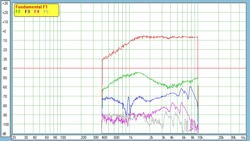

Could you explain why i should not use a 2k résonnant tweeter for a 2k xover ?
Distortion.Could you explain why i should not use a 2k résonnant tweeter for a 2k xover ?
That isn't your typical $40 tweeter with a FS of 2K.
That has very ugly response for a tweeter in its price range.
Yes, below -30 distortion becomes difficult to detect.
You think that my audax tweeter is above -30dB ?
- Titanium Tweeter down to 2K (or lower)
