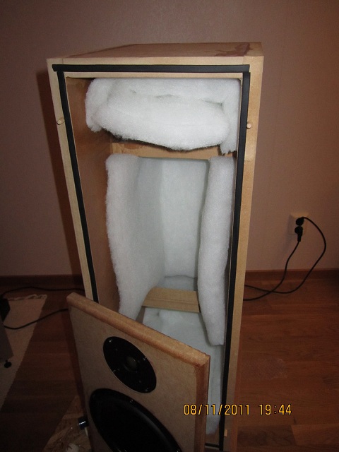

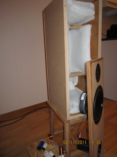

Salas, I listen to all kinds of music, classical, rock, pop, jazz. I am a pianist so I often use piano music as a reference. I think the bass sounds a bit scaled down and dry compared with what I am used to, I guess I want a little more "flesh". It is mostly when listening to pop/rock and not so much listening to classical music. I will post a picture tonight from the inside of the speaker.
This is the coil I use for the bass:JANTZEN-2005 - Jantzen Wire non-ferrite cored coil 2,500mH 0,268Ohm 1,20mm - Europe Audio
It doesn´t look like that in reality, it is the high coil I use (ealier picture).
The RDC is a little lower than a 2mm air coil from what I know but it should be a very small difference.

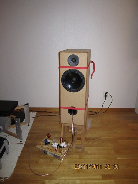

In a bass reflex too much. A simple test is you push back the woofer with one hand first, and you press with your other palm the port's mouth sealed the best you can. If you leave now the woofer alone, it should remain sucked in if there are no leaks.
Yes, do not forget I have no experience building speakers so maybe I have overlooked something, and maybe even that coil of mine is not very good. (I will also see if it is possible to glue the baffle soon allowing me to put the filter inside through the woofer hole later, I do think it would be nice to have it inside the speaker which is more practical).

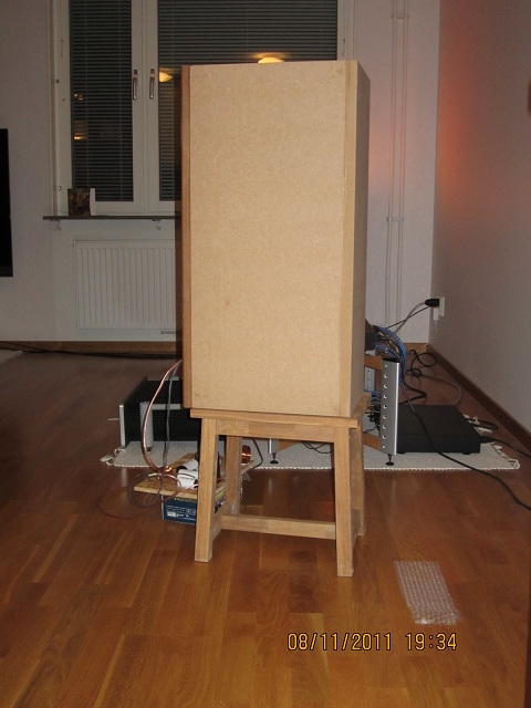

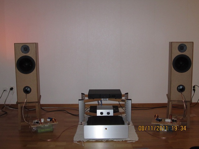

I have done as said, and (!) I hear a clear improvement! It seems the problem was a leaking cabinet. I have just started to listen but I am pretty sure it is ok now. Posting pictures.....
