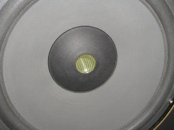

Raka said:Does anyone know any trick to improve a driver? I know that the production line is not perfect and they are not asked to be, so some things can be "fixed" by a diyer
Almost all drivers can benefit from tweeking -- some inexpensiv drivers cn be made dramatically better.
One has to be careful, or willing to loose a driver or 2, because tweaks can go wrong. Here are some examples:
1) damp the basket or the can over the back of your tweeter-- duct seal works as do many oother things
2) reduce early reflections off the basket (and in the case of your tweeter off the inside vent etc)
3) treat the cone. Damar, puzzlecoat are commonly available, "official" stuff like Lords BL100 are harder to come by
4) remove the dustcap
5) add a phase-plug -- try this on a cheap come tweeter, you might be surprised
6) plug the pole vent (only in conjunction with dust cap removal and will compromise the thermal capabilities)
dave

Raka said:1) How I damp the basket? Do I have to put some felt in the "legs"? If the tweeter is fitted in a separate enclosure, is redundant to damp the back of the tweeter?
I use duct seal (available at HVAC wholesaler if not at home despot). This goes on the outside of the basket and in the crevice between magnet & frame (unless you are doing the "potting the magnet" mod). This kills vibration & resonance. (so yes it is still needed on the tweeter).
2) Reducing reflections off the basket. How?
This is where the felt (or foam comes in). On the inside of the legs to reduce the magnitude of reflections off them from the back of the cone.
5) What is a phase plug for?
It effectively halves the distance across the cone, doubling the frequency of any resonances. Fills the hole left after you take away the dustcap (killing the tin can resonance)
