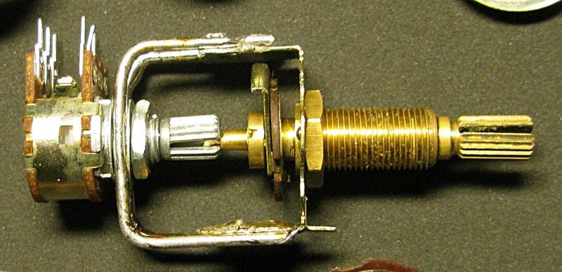

After searching replacement for broken stereo-balance pot (unusually long threaded part + shaft/D6mm = 30 mm), I given up and decided to build a new one on the basis of old skeleton and new dual-gang pot.
See attached pictures.
