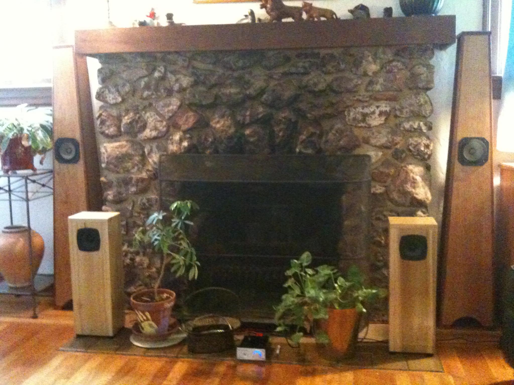

Built using two 8ft 1"x6" (nominal) boards with a 1.5"x4" vent. 7 liter (.25 cu ft) cabinet, about 6.5 liters minus driver, driver brace, and vent.
Picture shows them doing the work normally done by a pair of Fostex 127E Metronomes. The Mets are better (duh!) but the little TB's have improved markedly in just two hours of run-time. Bass is good for such a small driver but they (currently) lack "air" on top, and drums and piano lack that "twack" on the initial transient.
They look far better than I expected given my rudimentary wood working skills and tools. Thanks to my next door neighbor Ed, for his planing and belt-sanding which allows me to use the word "joinery".

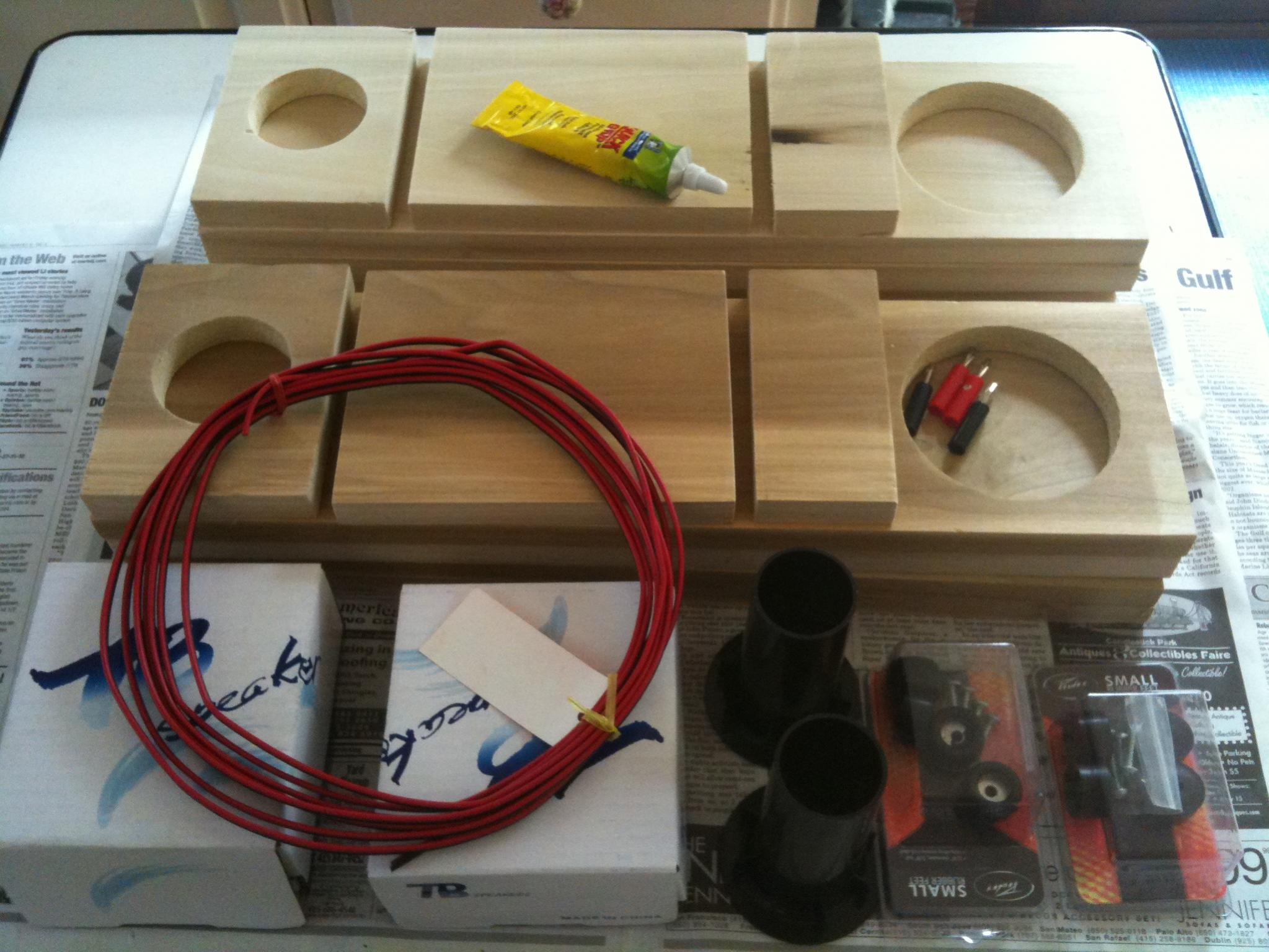

Obtain two 8 foot 1"x6" boards (.75 x 5.5 actual). I used poplar from Home Depot.
For each speaker, cut four 20" long pieces for the front, back and sides. Cut a 4" piece for the base, a 7" (or just a skosh longer) piece for the top, and a 2.5" (or just a skosh shorter) piece for the driver brace. You might want to cut the remaining (hah!) piece to 4" as a temporary spacer between front and back during glue up.
Cut a hole for the vent centered in the base piece, and a 4" hole for the driver, 3" down from the top of the front piece.

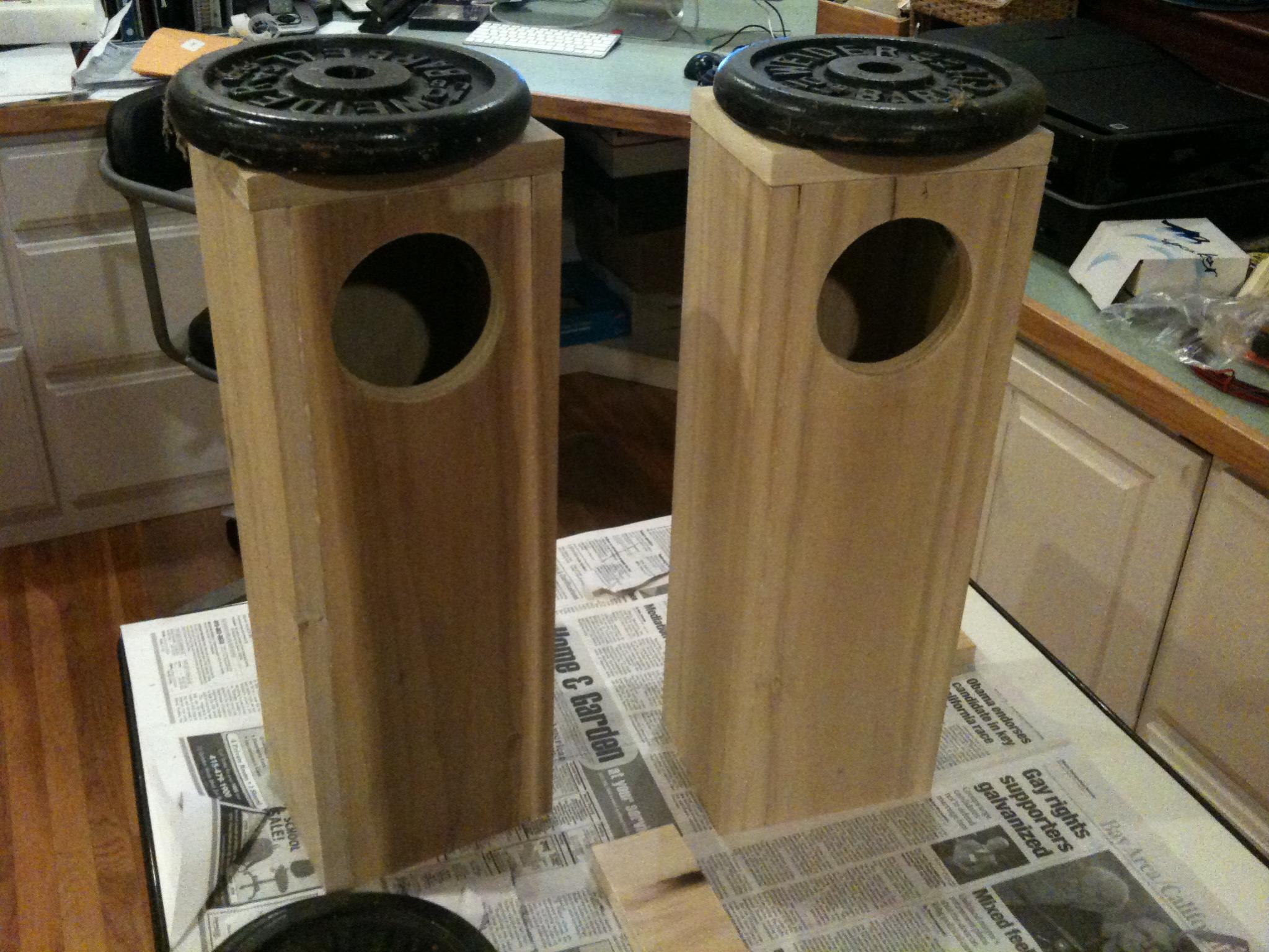

Glue them up. I used Quick Grip cement I got from the hobby store.

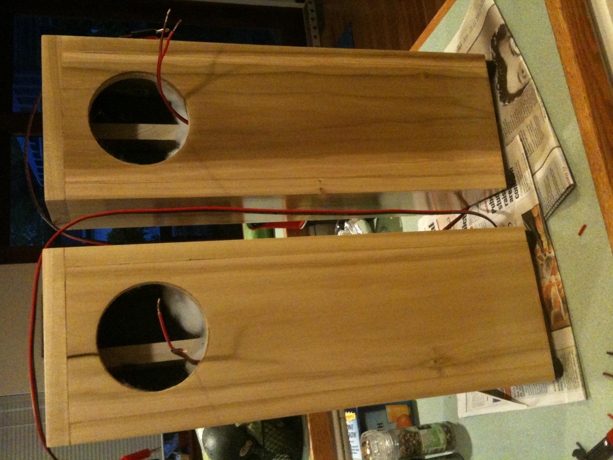

The driver brace goes at the top, behind the driver, slightly offset to one side.

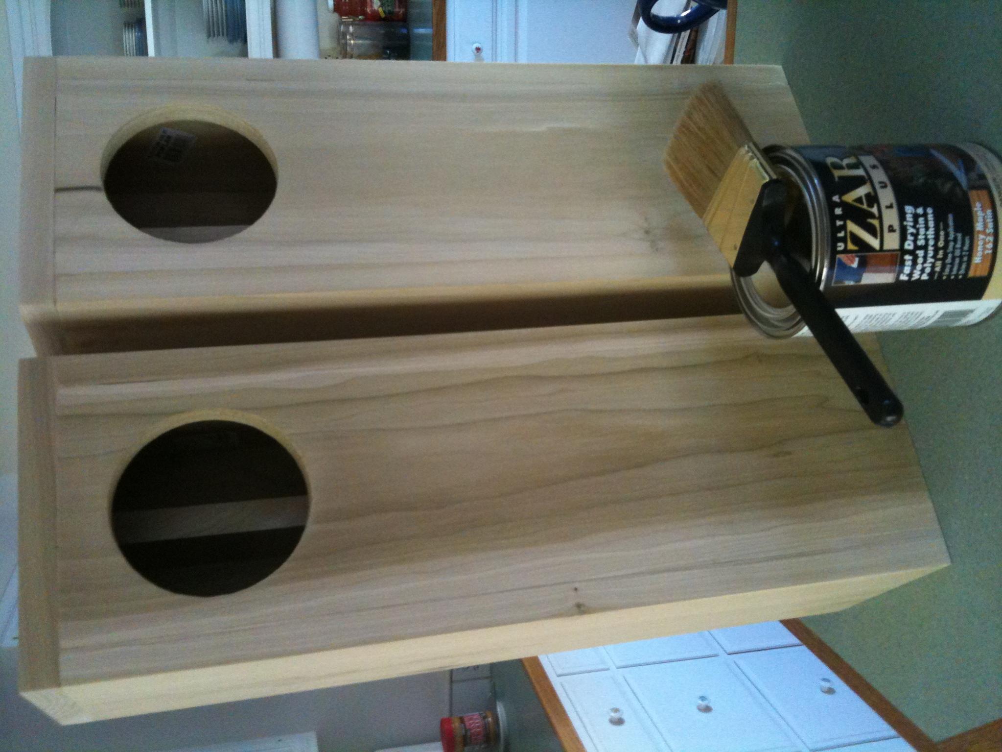

I originally was planning on going with a "shabby chic" painted finish, but they looked so good after sanding I switched to an all-in-one honey maple finish, 3 coats.
Some leftover accoustic padding went on each side of the driver brace and the remainder of my wife's polyfill pillow stuffing went inside.
A wire was led up through a hole in the bottom for the speakers with banana plugs on the other end.
Commercial feet were used (Peavey 3/4" x 5/8"). Make sure they are at least 1/2" high so you don't obstruct the vent on the bottom.
A commercial 1.5" x 4" flared plastic vent went in, the drivers were soldered to the wire and mounted on the speaker, and it was time to listen to music.

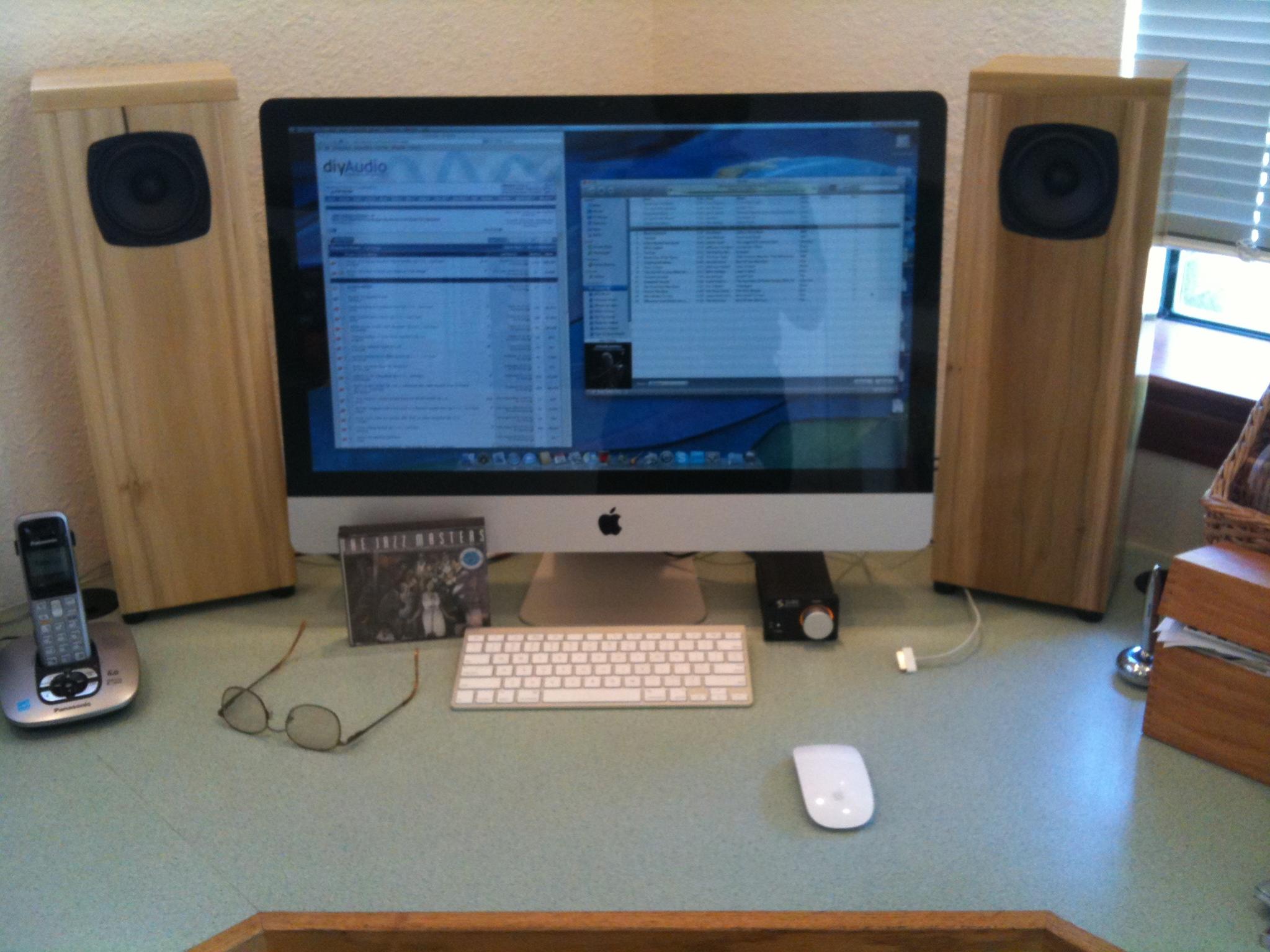

They are sounding better the longer they run. They however are a bit overmatched to filling a whole room. As soon as the Sure Electronics amp arrives from China they will be moved to my computer corner, on each side of my 27" iMac, with the drivers bore-sighted on my ears. I hope near-field monitor suits them.
These were not meant to be the "best" speakers, but rather a cheap and cheerful build that rewards the (minimal) time and effort put into them.

My Sure Electronics TA2024 amp arrived today so the Tiny Towers have been moved to the computer corner.
I think I'm going to like the Sure amp. Small and very classy looking. I bought it through eBay. It arrived from Hong Kong in under two weeks.
