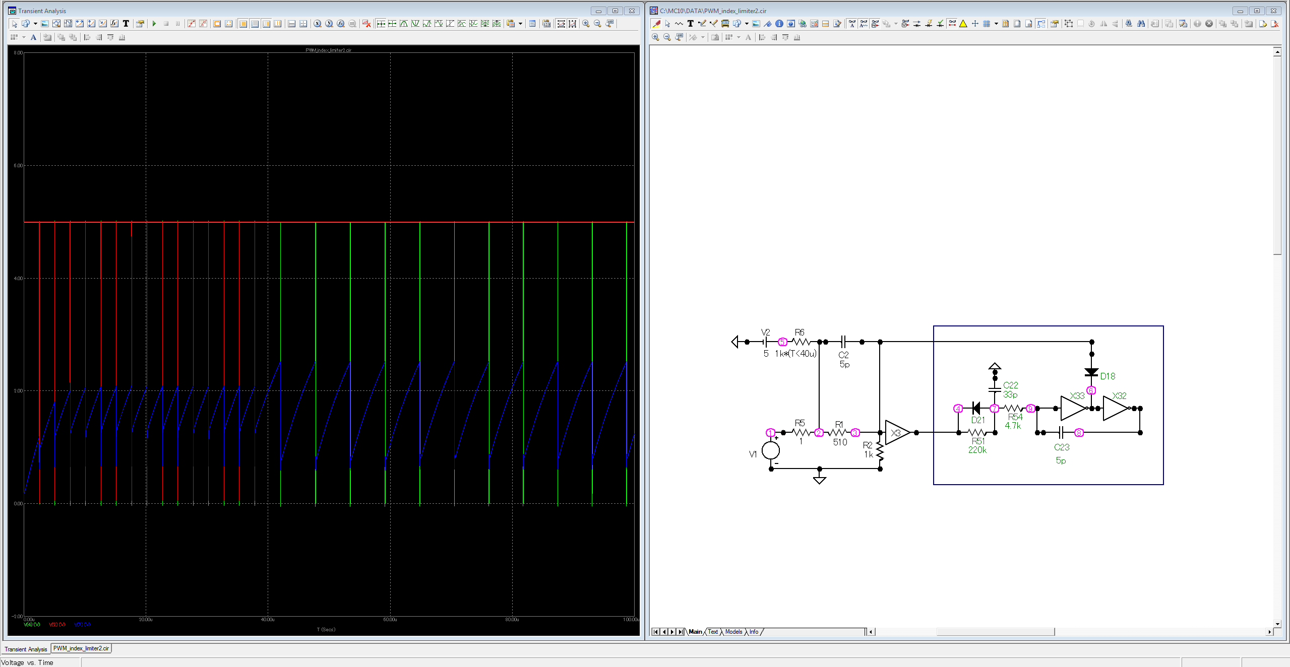

what is true DIY? ;) I keep working on the PWM modulation index limiter, actually, I can limit that index in the TAS5558 but in that case, amp loses about 25W. It is pretty strange but the bootstrap 100nF caps discharges surprisedly quick if switching is stopped, around 20uS or so, that creates loud crack sounds.

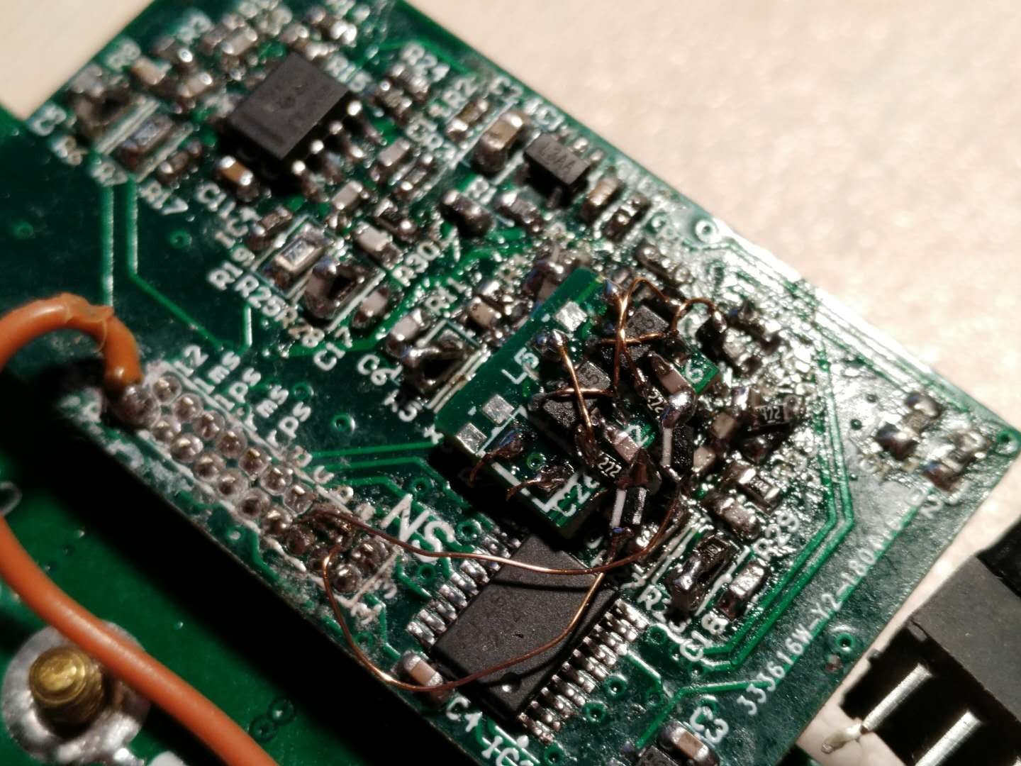

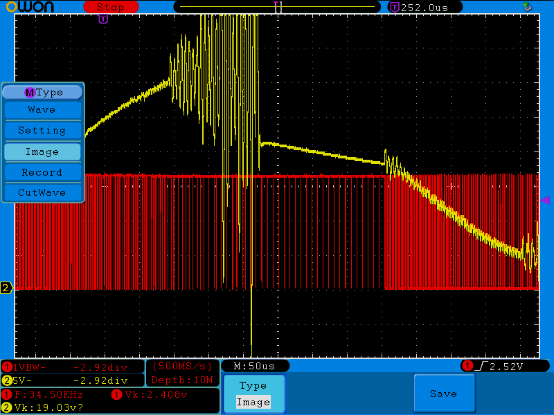

It seems the problem is OCP, which actually shows undocumented behavior. It's really looked like a bootstrap UVP issue and only happens on the high side. As I understand the TAS5342 should work in a current limiter mode 1mS and next latch until external reset. In my case 5342 does Off the high side for 200uS, after 100uS of intensive ringing due to current limit action. I gonna try to add 2 SMA diodes per each half-bridge output to clamp ringing to GND and to VCC.

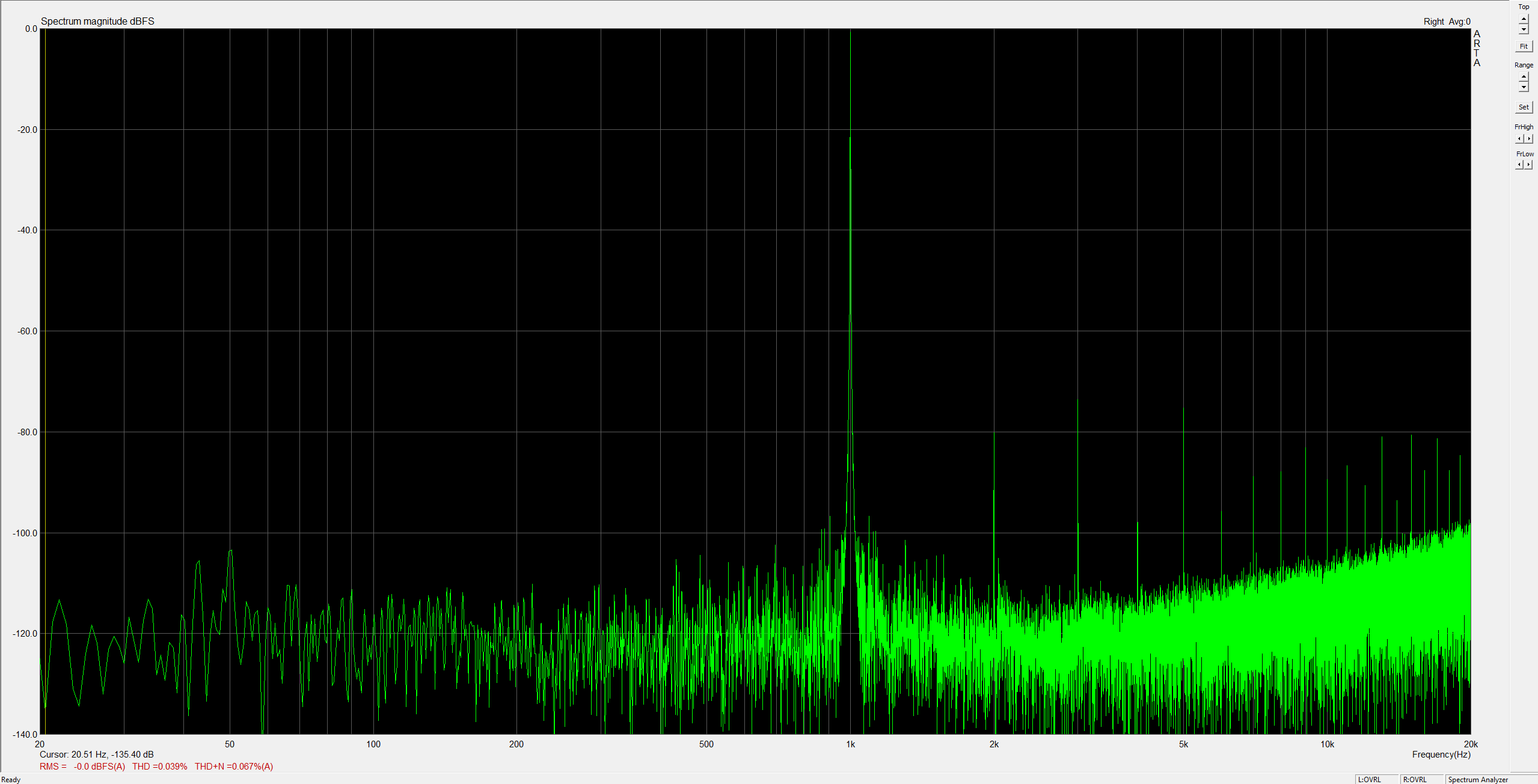

Haha, I was right, 4xES1DW helps. Now max power in the closed loop (noise-shaper On) mode 95.6W@4ohm (THD+N = 1% 100W in open loop mode), however 1% of the THD is unreachable only .039%(THD+N = .067%), and next +.1db makes THD 20%. So I gonna add into the IOS/Android app controls two parameters more: Max modulation index for closed loop mode and second one for the open loop as well.
