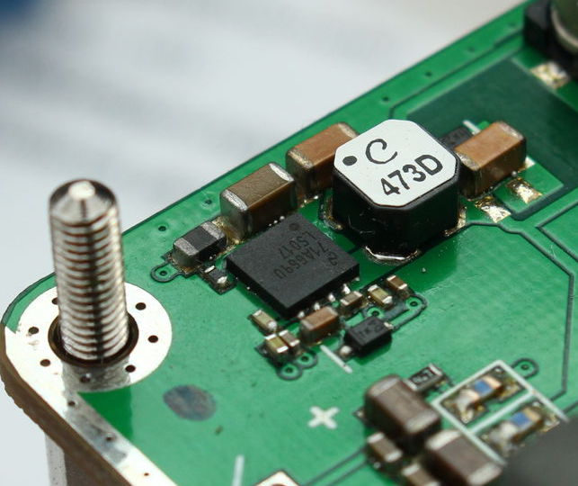

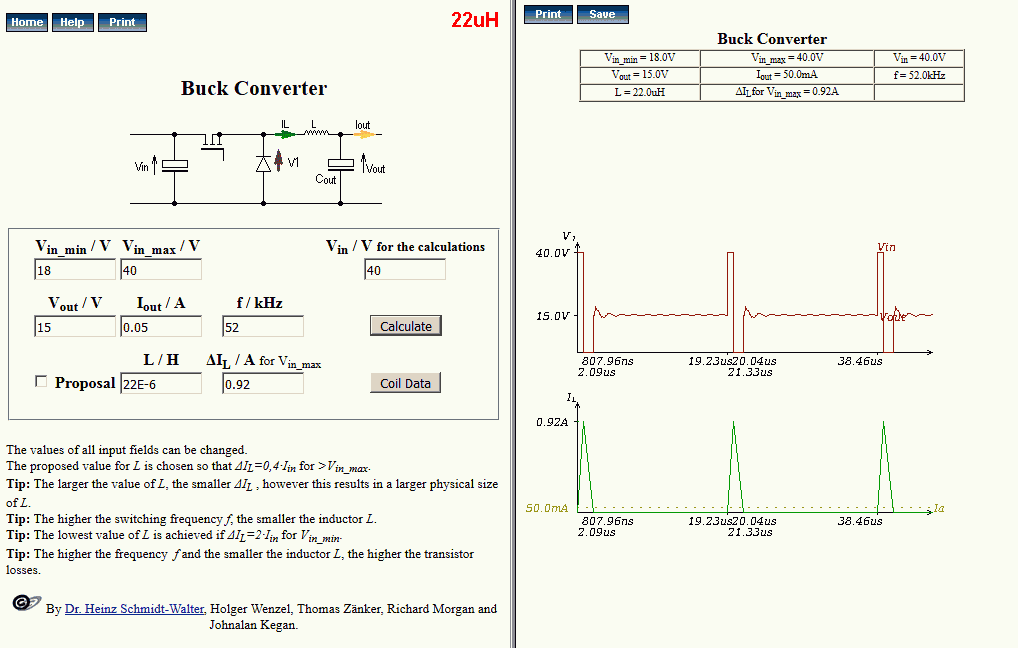

I have a couple of those. First its important to note they don't have the -HV variant of the buck regulator. So 40V is about as high as you can take them without separating the buck input from the TPA3255 output power rail.
Secondly, the inductor value is wrong at 22uH. I reckon from the DS for the regulator it should be 2.2mH. And the output caps chosen aren't in accord with the DS recommendations.

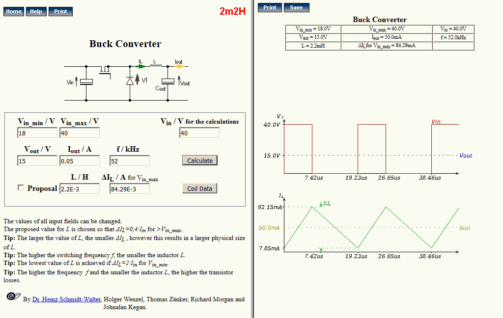

Yes, it might be of interest how a 10mH inductor will do as it highly reduces ripple current. With 22uH in place the converter is running in DCM, so smoothing highly depends on output caps.
Buck Converter
will help you out, i showed with 50mA average current.

== With 22uH in place the converter is running in DCM, so smoothing highly depends on output caps. ===
- Please, Is that mean, that it's NO matter to haver about 22microHenry, if use "Good enough, Big enough" Cap on output???? How Big for this place- for Your opinion are???

Most likely yes, due to low load current. The 15V are then passed into an LDO for 12V so any ripple is attentuated. I.e. when using the LM2940, like on the EVM, the ripple rejection at 52KHz is better than 65dB.
(Btw. DCM provides better efficiency at light loads than CCM)

Great you posted those helpful pages showing the ripple. Now if you did an FFT of the two cases (small inductor vs big) you'd get many more higher order harmonics from the small inductor instance due to the slopes being much steeper. Hence PSRR @ 52kHz doesn't help much in determining what'll come out of the LM2940.
I don't get your point. You may want to show your FFT results and maybe your measurements for this particular case? The LM2940s output isn't directly connected to any sensitive part. And what about those higher harmonics, do they get down-modulated) at some point into the audible range? (Having k2 at 104kHz which fits nicely into ESR minimum of modern lowESR caps)
I have no FFT results because I don't need to, eyeballing the waveforms is sufficient to note that the waveform with the lower valued inductor is more impulsive. More impulsive implies higher levels of higher harmonics. What the LM2940 is connected to is not relevant to this analysis.
I'm not saying there is a practical problem, just pointing out that the output of LM2940 is going to have more higher frequency harmonics on it with a smaller inductor than with (say) 2.2mH. I haven't looked at its PSRR plot but they all degrade at higher frequency don't they?
Given the choice between efficiency and potential SQ issues, I'll chose slightly lower efficiency. Based on my own recent experience of feeding a buck reg into an ADC (a huge loss of subjective dynamics) I prefer to use passive (LC) filters these days rather than rely on PSRR of a reg. I didn't take any measurements in that instance so I dunno if the loss of subjective dynamics can be quantified.

Right, that's all valid in theory and might get relevant with "bad" board layout or other quirks. We actually use 1.4-2MHz buck-regulators on our 3255 boards with no further ldo or bulky elyth/polymer caps with no issues or measurable performance/SQ degradation. (Of course 52kHz isn't 1400+kHz)

It wld be really wonderful if 2Mhz Buck Regulator doesnt cause any issue; however Audeo reported that Alientek D8 did use a 2Mhz Buck Regulator, and reportedly that does generates noisy hiss, he resorted to using 15uH to get rid of it.

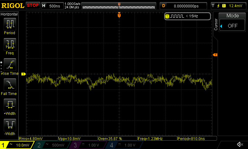

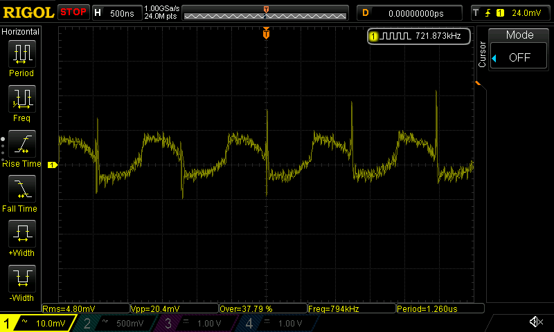

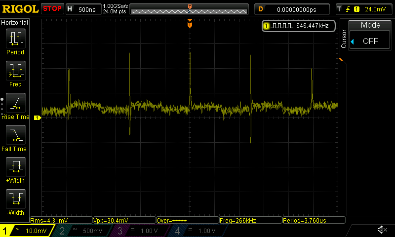

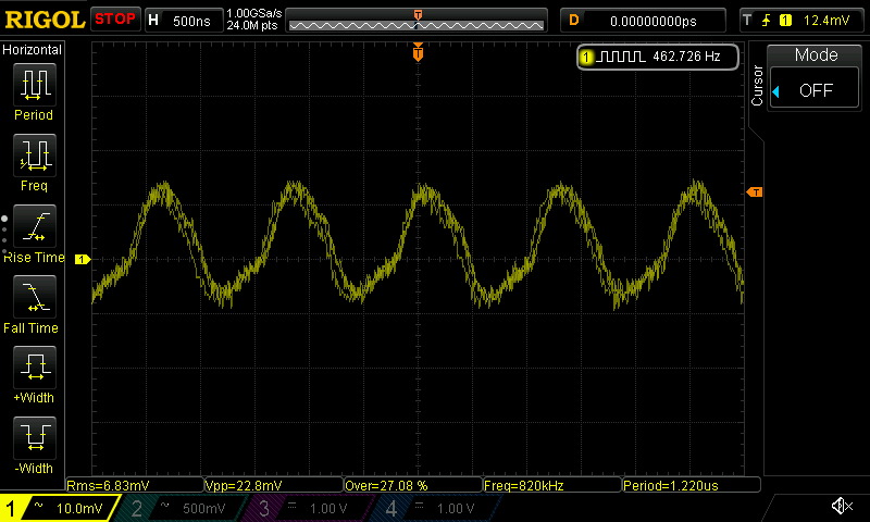

Actual implementation for 3255 with LM5017 (up to 100V) generating +/-12V in fly-bluck for AFE and input stage:
Tests where initially done at 850kHz and showed the following:
+AVCC at converters output cap:
-AVCC at converters output cap:
Using a (not necessary) small 47uF cap for the AFE module smoothens out the peaks:
+AVCC:
-AVCC:
I wouldn't cal 30mV peaks an issue with modern opamps.
