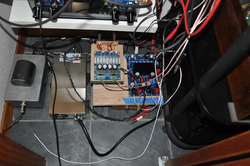

The 350 has a fan but I've never heard it run. Either it rarely turns on or it's virtually silent. I'd rather run the amp with a power supply with more current but compromised on a power supply that others claimed was silent. They were right.
It's excellent sounding with the 350, too.
And to think I've been a tube amp guy for 20 something years. These sound sweet out of the box.

Totally agree. I do not think I have heard the fan inside the 350 came on. I purposely play at loud volume for 10-15 minutes (when the wife and kid were out of the house:D) and checked on the PSU, nothing. Did not even get warm. My speakers are 87dB sensitivity, sort of average. I have a pair of panel speakers that are not easy to drive (83 dB), I am going to try it out and see what happens:p. I think the 350 is great value for money.
I'm pretty pleased with the sound of the TPA3255 and the 48v 350 watt power supply. Surprised at how nice it is.
