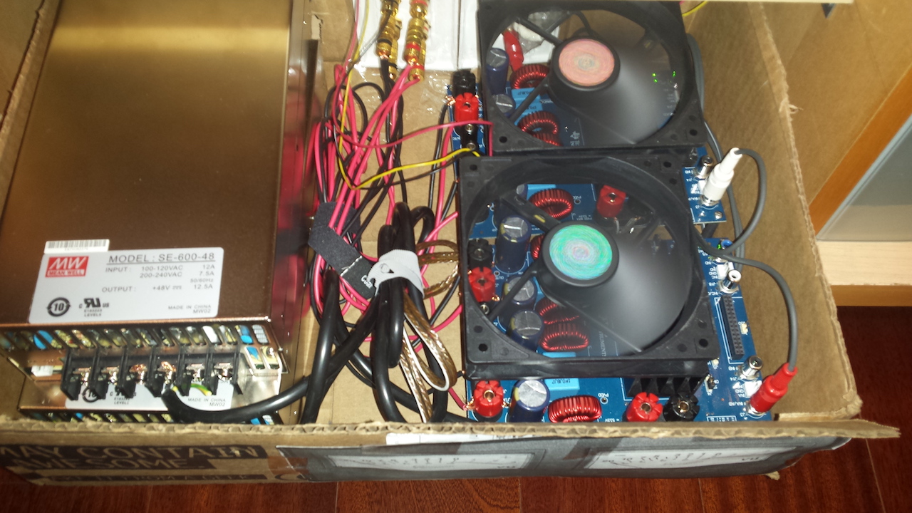

So far I am very impressed by these amps. I am using them as monoblocks (PBTL mode). Two SE-600-48 driving two of these amps. Because of space and height constraints, I have yet to find a case I can fit in everything, so I have made a makeshift case using a newegg shipping box.
I have put 2 120mm fans in the case, right now just resting on the amp. These are running of a USB 5V 1A power supply, so very low speed, but enough CFM air movement to keep the "case" cool even after hours of play. I don't turn off the "case" since the no load power usage is very low. The fans are totally silent so there is no noise coming from the amps.

I did ask the same question in an earlier thread. The answers were kinda mixed. Anyway, no harm in very low RPM fan circulating air in the case.
Without fans, the air gets kinda warm, since I have power supplies stacked on top of each other next to the amps. I have replaced fans in the power supplies to Noctura running at lowest RPM. Then I took 120mm 12V quiet case fans, stripped off the +/- connectors, took a USB cable, cut the small end, connected the fan's +/- to USB cable +/- (ignoring the datalines), used some electrician tape, since these wires are very very thin. So, that's how I made my makeshift USB fans. Connected both fans to a 2USB port power plug. Since USB is only 5V, and the amp these fans are pulling is about 0.2A or so, total wattage is less than 2W for both fans, and whisper quiet unless you put your ears in the case.

Quick question: On your first pic, the red/blue wire is connected to +V on the PSU. It appears reversed in the second picture. Can you please clarify? I am ordering the same PSU, want to be sure how to connect this properly.
Nice catch! I switched around the wires from one picture to the other because one of them was a little short to reach the power input to the board. Just connect VDC + output from the SMPS to red terminal input on the board and you will be good. Sorry for the confusion :)
