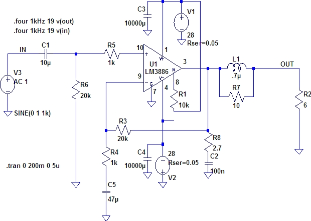

I'll work on drawing a LM3886 .asy (schemtic symbol) to go with the model, and then try to get a sim running in LTSpice. I'll post any results here.
Thanks for the heads up. I downloaded it and tried to run a sanity check in LTSpice with a basic inverting gainclone circuit, and something is broken - it produces a tiny sinusoidal signal of some nV at the output.
I'll recheck the .asy file and the pin order again. The same inverting gainclone circuit works fine with Pedja's LM1875 and Teemuk's older LM3886 model, so it's something specific to this model file that's broken in LTSpice. LTspice isn't complaining about anything in the model, though - it runs the transient analysis, but incorrectly.
Edit: MUTE behaviour is broken, i.e. inverted. It now works when I leave MUTE floating (unconnected). If I pull it down to Vee with a 10k resistor, the output shuts down - there's a 60 nV signal at the output. It's bit late here now to debug and fix, so I'll leave it to somebody else to confirm this behaviour - the fix should be fairly simple.
I have confirmed the mute behavior, when pulled down to -Vee, the output is muted. When left floating, the output is enabled.

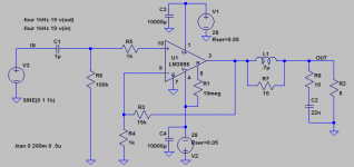

I have attached a zip with an LTSpice "asy" file which contains a schematic symbol for LTSpice, as well as an example schematic. You will need to download the pspice model from TI and put the LM3886.lib file in the same directory as the .asc and .asy files.
The distortion (refer to simulation error log) seems a little low at 0.000053%. Don't forget to turn of 1st/2nd order compression and ensure the simulation runs for an exact multiple of the input waveform period when testing distortion. The input waveform distortion is also tested; this is used to ensure that the simulation is working well enough. If the distortion of the sine source signal is not nearly zero, then your sim is broken need to tweak something.

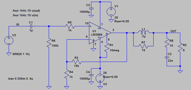

Cool - I noticed that the distortion was unreasonably optimistic. THD20 FFT showed all harmonics at -170 dB or below, for an output amplitude of 18V into 8 ohms. Probably a pure behavioural (polynomial) model, not a structural model for the output stage. AC small-signal corner frequencies seem to be sane, so it probably models the poles/zeroes correctly - it should be ok for stability/phase-margin analysis, though maybe not for distortion analysis.
MyRef Rev C and Rev E schematics seem to work in transient analysis (I use a modified LM318 model to take care of the Comp pin), though of course the THD20 numbers will be suspect.

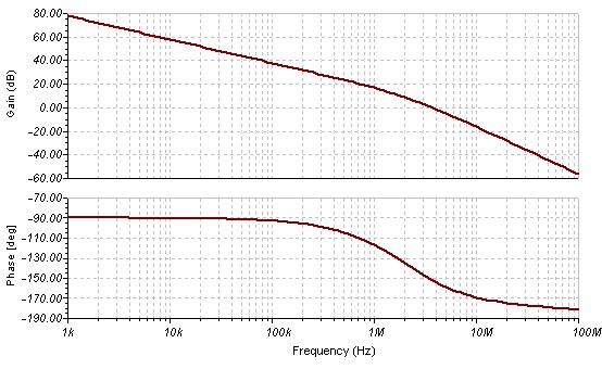

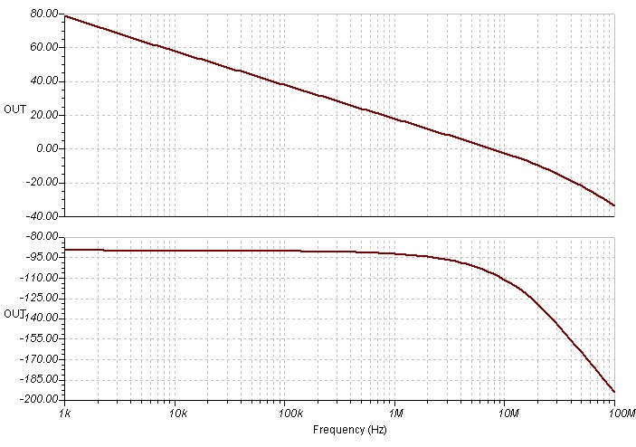

But the real bummer is elsewhere. I did a quick check and found that that the bode plot is completely off, indicating a unity stable amp and in fact it sims like this in a transient analysis (WTF!). GBWP is set to datasheet max of 8Mhz, not 4Mhz (typical for the real part). Open-loop phase hits 120deg at over 10Mhz, while in reality and datasheet this point is at below 1Mhz.
For correct AC analysis and stability checks the model seems to be useless.
EDIT: see my take on a correct bode plot estimation here.
Obviously nobody at NS/TI checked the model, otherwise the "mute bug" and the wrong gain/phase response would have been readily detected BEFORE publication.
