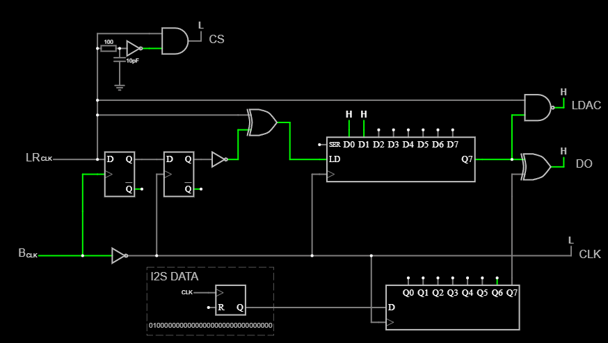

Im planning to build a DAC11001B based DAC and will share any progress here inc. measurements, aiming for uncompromised measured performance from the chips.

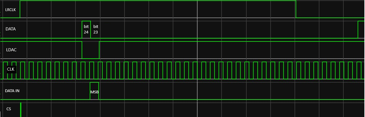

First, I wanted to see if the suggested 24bit RJ glue logic for DAC11001 could be adapted to work with a normal I2S input.

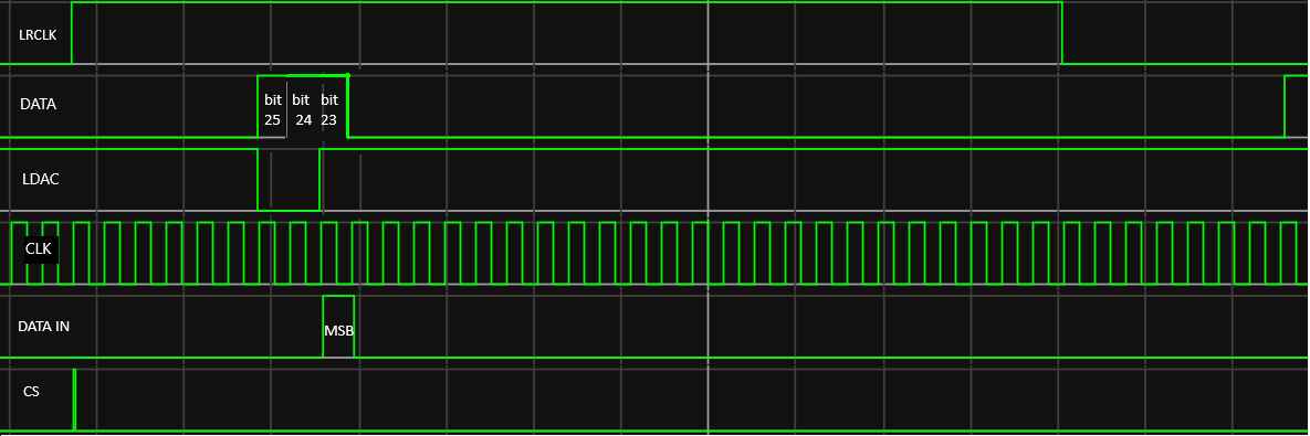

After a read of the datasheet, I attempted to simulate it (the first frame of the sim has an error):

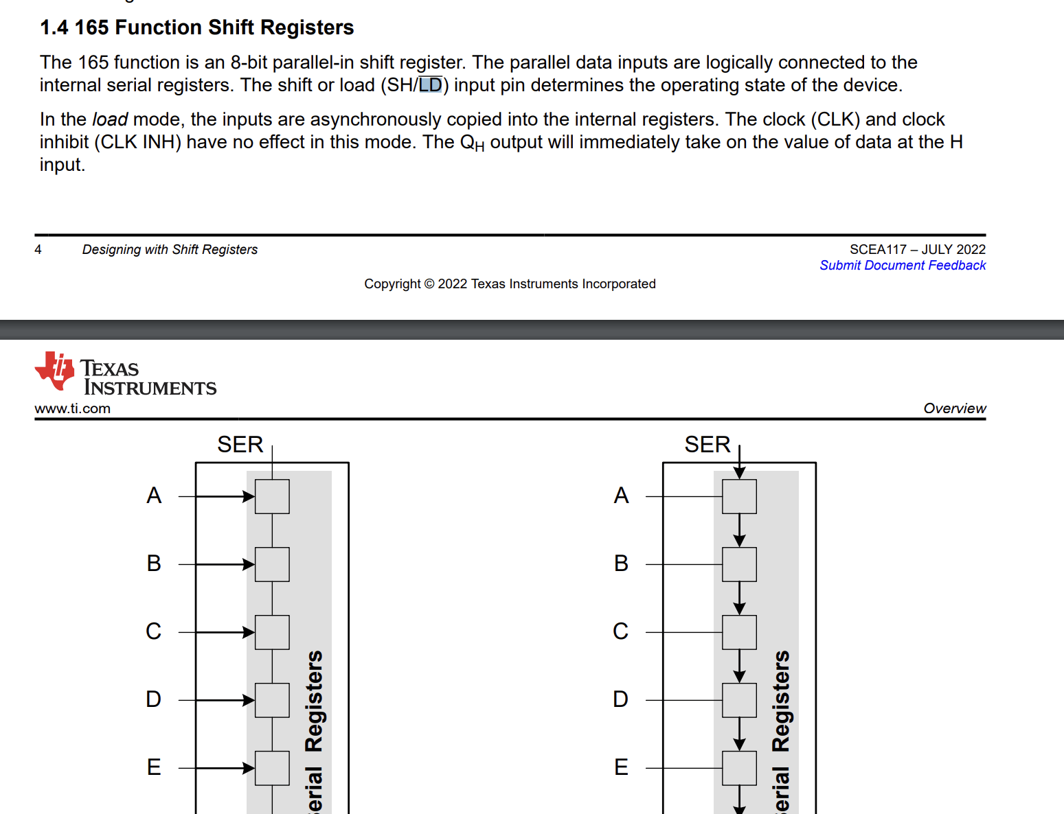

The DACx1001 wants the audio data left justified to the 23rd bit and an 8 bit shift register will shift the I2S MSB accordingly, sound about right?
Something I'm trying to understand is why the main shift register has 2 inputs held high instead of one.
I think it could be to have a longer LDAC pulse so that the LDAC minimum low time (20ns) is satisfied even at the highest clock rates,
however the shift register output also drives the XOR and it causes the audio data MSB to be inverted.
This couldnt be right, so I figured instead the shift register output may be delayed by 1 bit because of some hidden issue in the sim.
If this proposed delay is corrected the input data will no longer be effected, but this changes the register address from DAC-DATA (01h) to DAC-CLEAR-DATA (03h) and this doesn't seem right either:
Can anyone clarify this?
Few other small things I managed to figure out about the glue logic circuit that may not be obvious to everyone:
DAC will be sensitive to BCLK jitter, as the LDAC pulse is clocked out of shift register by BCLK.

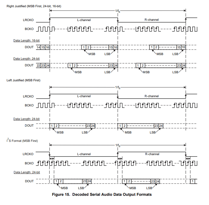

Also, when LRCK is high the the Left channel data is sent; LRCK low is the the Right channel. DACx1001 appears to be a mono dac, so you need two of them?
Seems like it would probably make sense to draw out the I2S input waveforms including their incoming justification from the source device (in one color or otherwise easy to distinguish from SPI), along with desired output SPI waveforms. From that it should be pretty clear which clock and data is which. Also, since DACx1001 appears to read data on the falling clock edge whereas I2S writes data on the rising edge, that should difference also be shown clearly.

Basically all the hard work was done by a TI rep who provided a glue logic circuit for the DACx1001 to convert a 24bit right justified input to SPI for two DACx1001s in the daisy-chain config
Then all Im trying to achieve is modifying the glue logic circuit to work with an i2s input instead of 24bit right justified input, which I may have managed already.
But regardless of the data input format, I can't understand how the glue logic works correctly from looking at the simulation.

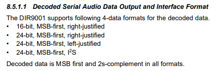

e.g From the DIR9001 datasheet, 24bit RJ and I2S outputs are both 2s-complement:

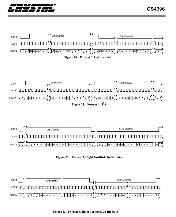

This diagram that seems to imply RJ is unsigned, since only I2S and LJ have negative bit numbers:
I2SoverUSB manual does not mention anything about two's complement, unsigned, signed etc.
Nor CS8412
Nor AK4137

For twos-compliment format, the MSB is the sign bit. If its 1 then the number is negative.
Also IIRC, 8-bit I2S may be unsigned (?). 16-bit and higher is signed.
In addition, a quote:
Data is signed, encoded as two's complement with the MSB (most significant bit) first.[1] This allows the number of bits per frame to be arbitrary, with no negotiation required between transmitter and receiver.[1]
https://en.wikipedia.org/wiki/I²S

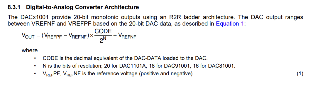

What do you mean by negative? In unsigned binary there is only positive. Two's compliment allows for negative numbers.
A negative number in two's complement, if you take its bit pattern and interpret it as unsigned, then it would be a positive number at or above half-scale (because the MSB is set).
What the equation says is that there is a reference voltage span, in parenthesis, multiplied by a ratio from 0 to 1, plus the negative offset of the negative reference. So if the ratio is zero, you get the most negative possible value. To get zero the numerator has to be zero. To get the maximum positive output voltage the ratio must be 1. That means the numerator must be the the number of bits your particular dac has.
