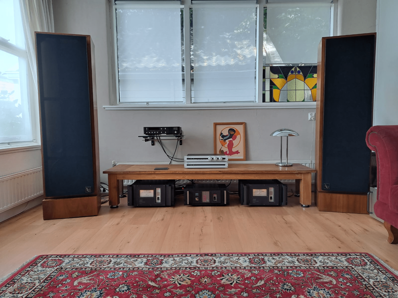

I upgraded my pair of SA/1's with four 100,000uF, 100V CDE caps per chassis.
Regarding driving the Kappa 9. In my second setup (for the wife) I run a set of Kappa 9's with a old Threshold Stasis 3 amp. My wife likes to dance with disco SPL's (not with disco music though) and the power is sufficient. I find that a incredible performance by the Stasis 3.
Reactions: 1 user
The Stasis 3 (according to the German Audio Magazine 'Hifi Exklusiv' 2 x 163Watts @8Ohms and 2 x 233 Watts@4 Ohms) did not fair so good with the Watkins woofer on my QLS. It became too hot to touch and blew a 5 amp railfuse.
Nice feature was that all the LEDS on the failing channel became stationary
The SA/1's have no problem whatsoever with the Infinity QLS's even fullrange.
Maybe the first incarnation Stasis amps (Stasis 1, 2 and 3) do not fair well with these loads?
