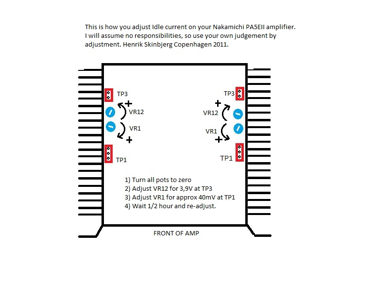

i search the service manual for the Threshold S200 or Nakamichi PA5EII. I will set the bias and the gain. Can you help me? My email: rocawear@web.de
best regards
chris
