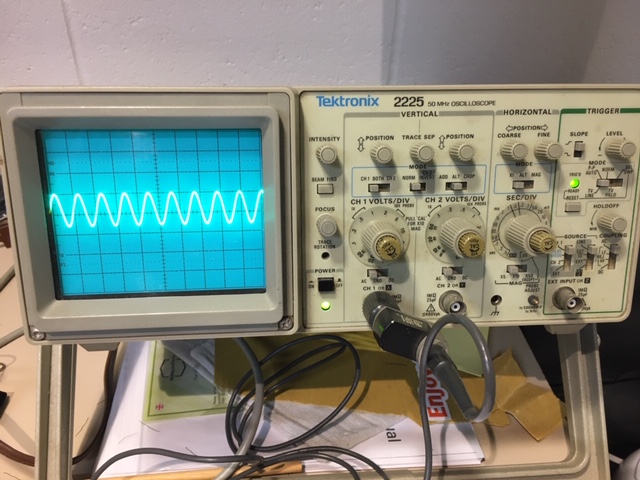

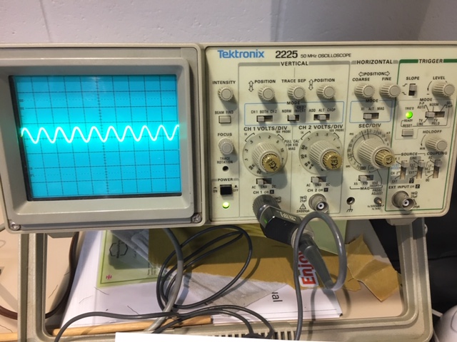

Here are pictures of the scope pattern for the output of the gain boards, two boards have lower voltage output as seen in the second picture.
The same scope pattern is on pins 19 & 20 (output), pins 15 &16 (comp 1), pins 17 & 18 (comp 2) on each gain board.

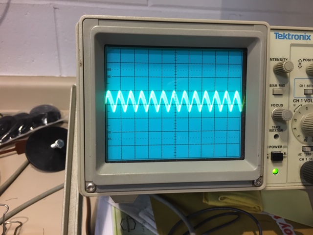

There is feedback from output to - input with the jumper set to MM. When I select MC, I get a very nice sine wave on both inputs + & - along with output. As soon as I select MM, the pattern has high freq on the - input to the gain stages. Here is a picture of the - input with the jumper on MM and two gain stages removed.

It is not power supply issue, I have a steady +18vdc and -17.9vdc on both rails and to each of the four gain boards.
rayma - I have a pair of x10 probes which give the same scope pattern for the output, with only a 4mV input, the x1 probe works best tracing the input signal.
I ordered new polystyrene capacitors, since I suspect the .001uF (C102), because I'm going to replace caps, I'm also replacing C103, C104, C105,C106. All of these are SEC polystyrene capacitors.
