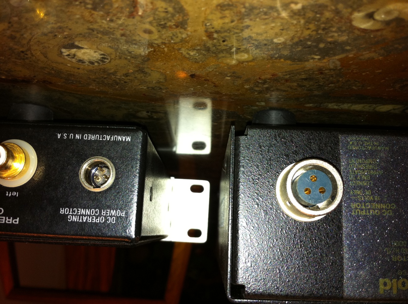

I recently picked up a Threshold FET-10/hl preamp and I'm in the process of restoring it. It doesn't need much work other than replacing the old electrolytics and bypassing the output coupling caps.
I'm considering building a heftier power supply for it and I'm trying to determine what type of plug is used on the cable that plugs into the preamp. It's terminated in a small size 3 pin female connector. The diameter of the connector is ~ 0.32 inches or close to 5/16" or 8mm. The pin to pin spacing measures ~ 0.13 inches or close to 1/8" or 3.3mm. Of course all of these measurements are subject to error since I just pulled out a ruler and measured these . I've attached a picture, which may be more useful.
Anyone recognize the connector type and know where I can get another one?
Thanks,
---Gary
Joined 2002
Looks like a Tini Q-G, mini xlr. Switchcraft, among others, makes them.
Thanks Bill - I appreciate the help.
After posting the picture, it occurred to it looked like a miniature XLR, so I searched on that and found the same thing. It's amazing what you can find with Google once you stumble across the right search term. The parts are available at Mouser if anyone else needs some.

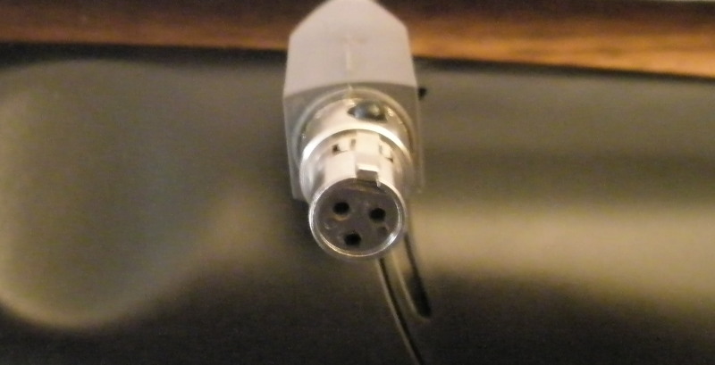

I'm pretty new to the hifi hobby and recently found a set of FET 10/HL + SA1 monoblocks form my dad's warehouse. :D
However, the cable between the power supply the FET 10 is missing, and can you guys confirm the standard mini XLR works? I would also like to DIY one with a much longer length... do you know where can i find the parts?
thanks in advance!
Joined 2002
On my FET 10/hl, the cable was hard wired to the power supply and had a 3 pin female connector to plug into the preamp. When I built a new power supply, I used a Switchcraft TA3FLX connector and it worked perfectly. I picked it up at Mouser.
The equivalent male connector, which you probably need to hook up on the power supply side, is the Switchcraft TA3MLX.
---Gary
