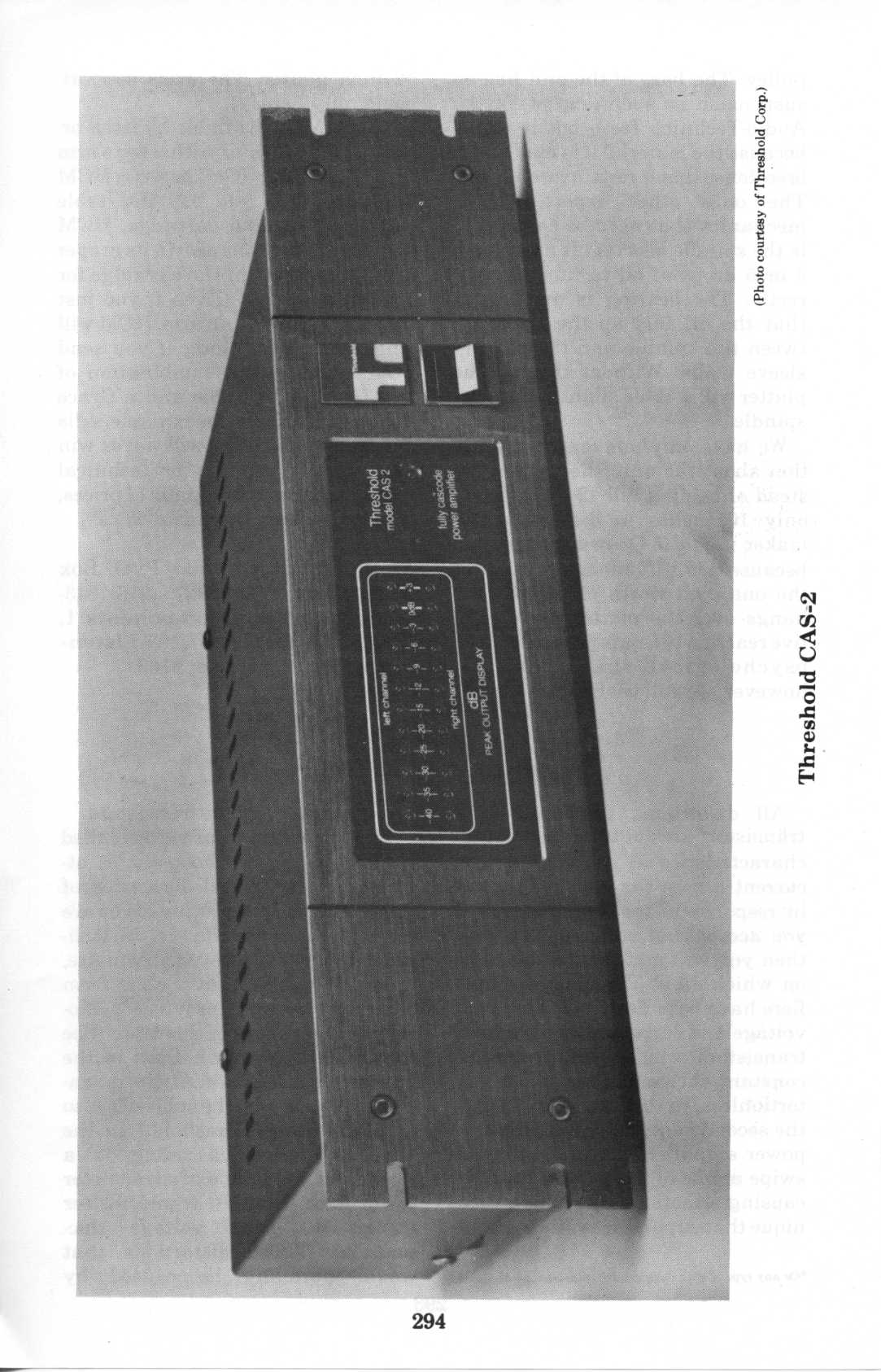

Here's a review.
Scratchy volume control usually means there's DC on the volume control.
I would look for DC there first.
