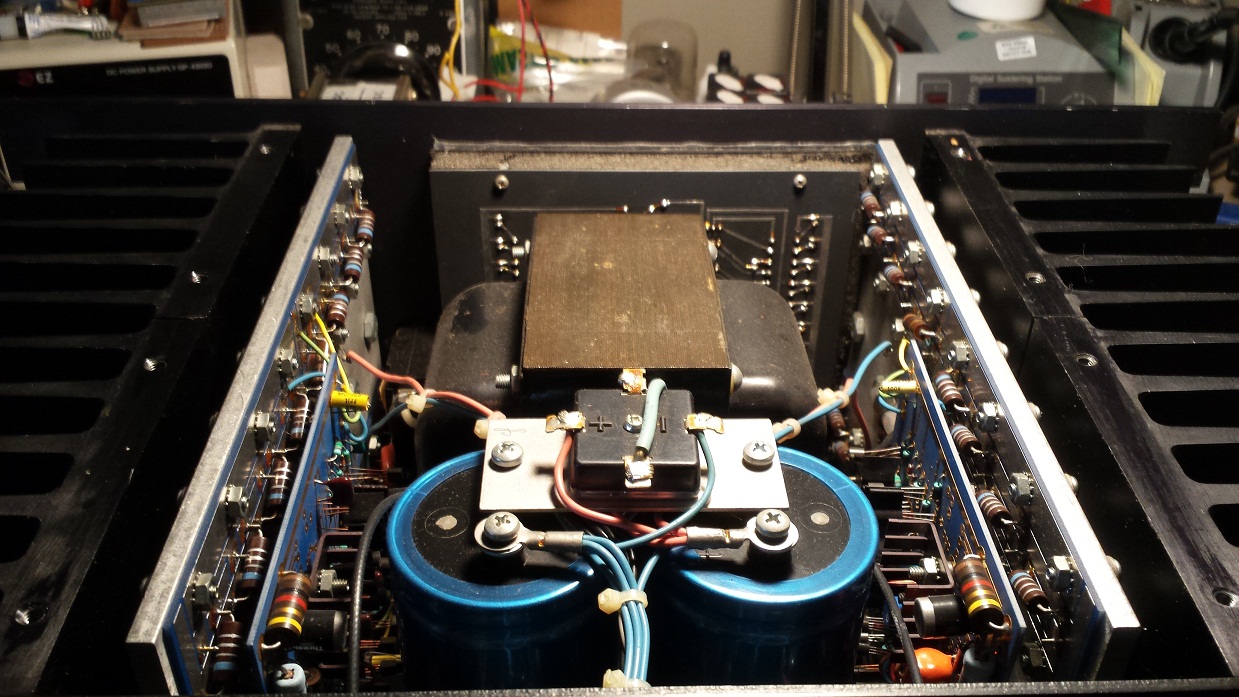

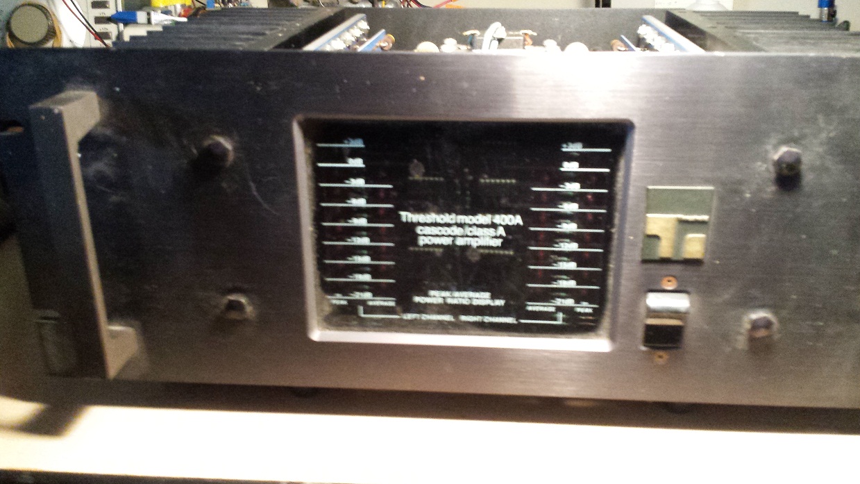

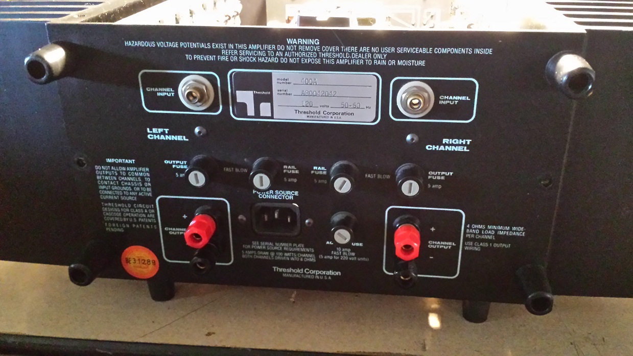

Need some advise. I was given a Threshold 400A Cascode from my buddy, to keep. The problem, it blows the rail fuses as soon as you turn it on. I popped the top off and just visually looked around. Looked very clean, no sign of any blown or distressed parts. I've built a few solid state and tube power amps, power supply's and such, pretty basic stuff, but am not a savvy bench tech. I own a variac, dim bulb tester and a scope, (with limited knowledge on it). I assume there's no "do this and there's your problem" answer but I hate to just let it sit there. I want to use it! What do you think?

I'm always going with PSU check first (shorties , blown diodes,shorted caps) , then output side (one channel , then other) - checking outputs for shorts then conduction (diode test)
that would need dismantling either emiter/base resistors or transistors itself from circuit
then front end - first for shorties then , if needed , dismantling each semiconductor from pcb and checking it with diode/megaohm test and functionality test (if needed)
so , see things are simple ....... even if I didn't mention setting/testing procedure afterwards
:clown:
Ok ZM, I took your advise. Got some salt, went outside...... probably easier to work on the amp instead:cheerful: I'll start with the PSU. And nec3, thanks for the tips. Question, would it be ok to desolder the four wires for the VU meters so I could take the front off for easier access?

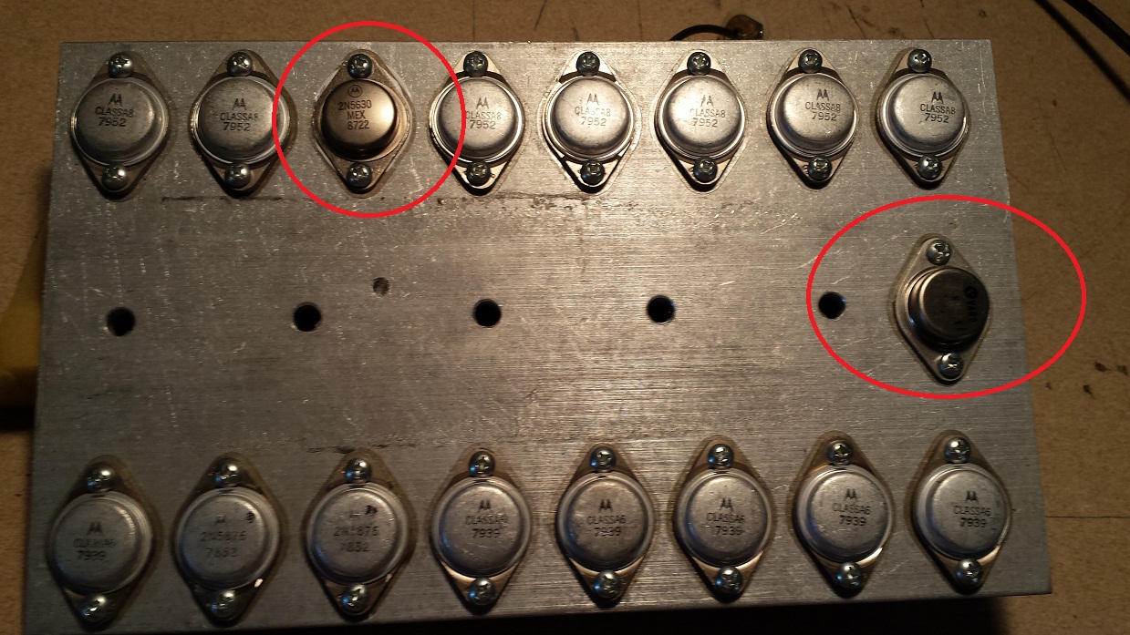

Ok, so I decided to start taking it apart and yes, I have taken a ton of pictures so far. Anyway, here is what I have found so far.
1. One of the output transistors has been replaced so it has been worked on before. ( I circled a second one on the right because I'm not sure if it's original or not.)

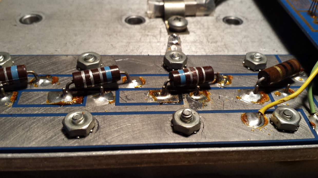

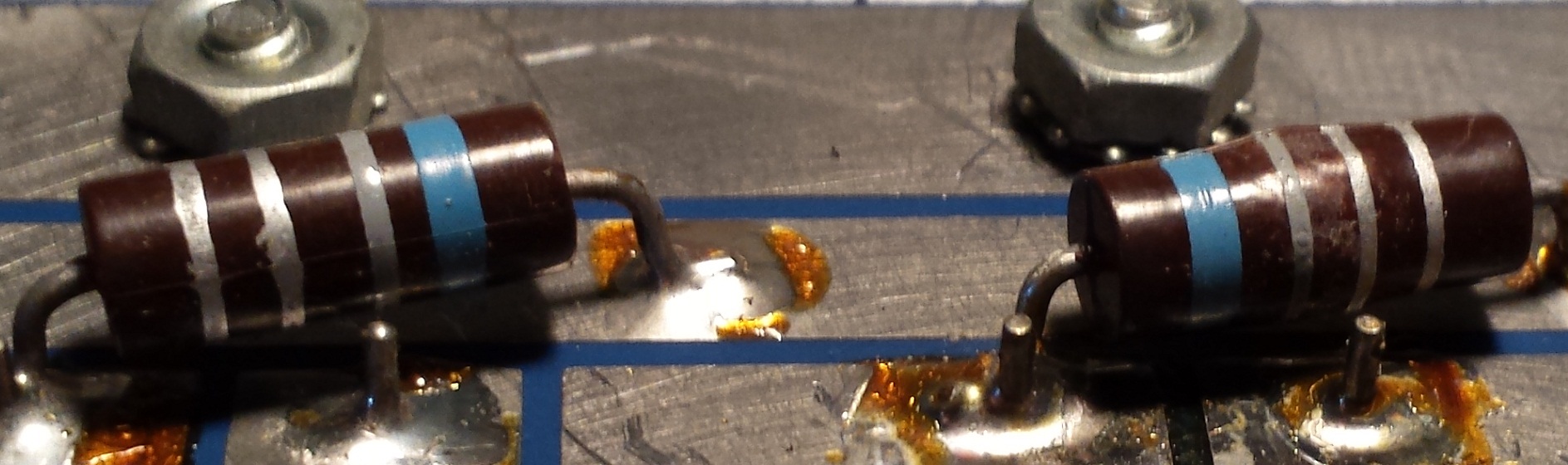

2. One of the 0R68 emitter resistors looks puffy
Posting pictures so you can have a look.

To recap, I need to replace all output transistors with matched N's and matched P's, replace all electrolytics and 0R68 resistors and reflow all solder joints. Yikes. Ok, not saying I can't do that but will have to think on it for a bit. Thanks you guys for all the advice.

The single one inn the middle with the V is a diode. They never break.
No, you probably don't have to replace them all, and they don't have to
be matched. At the factory, we tested them to ensure that they all had
decent current gain (back then, the populations from Motorola had a
good percentage of very low gain devices).
Even the poor current gain transistors worked, we just got a more consistent
product with selecting.
The original parts were house marked 2N5878 and 2N5876, which were
4 Mhz Ft.
:cool:

Just as an aside, the emitter resistors used look like the old TRW/IRC BWH series, which uses a fiberglass core resistive element like the "cement box" power resistors, but with a molded phenolic surround rather than a ceramic tub filled with cement. When they are overstressed, the phenolic wrap on the BWH resistors tends to puff up like shown in the photo. This likely indicates the output device(s) that bought the farm. I'd be tempted by this amp, but I already have enough wounded amps in need of repair (I spend most of my time on new designs).
Would you use same kind of resistors today or replace them with the type used in ACA and other FirstWatt amps? …..I think they are metal film power resistors (not wire wound).
