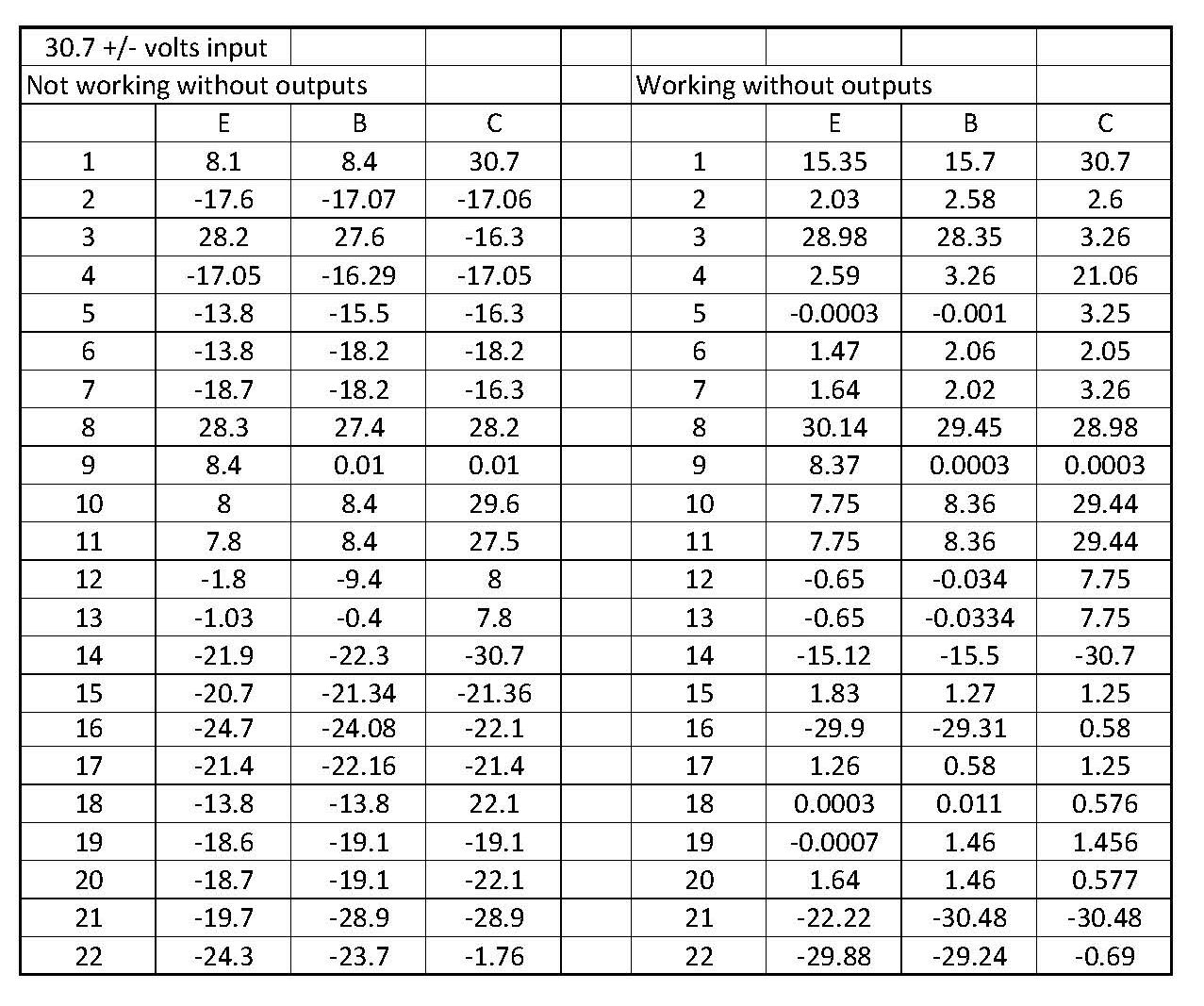

Here are readings at 30.7+/- volts. I think I may need to hook the outputs back up to the broken side before it is of real help.
Volts30 with working
Voltage on base of Q22 (and Q16) should be 2 diode drops higher than voltage at collector of Q21, i.e.
2 x 0.7v above -28.9v = -27.5v
Your measurements show -24.3 or 4.6v across the two diodes.
Conclusion: One (or both) of the two 1N914 diodes connected between base of Q22 and collector of Q21 is open.
Suppose to have ~2 ma thru Q22 and ~6 mA thru Q16. Measurements show ~15 mA thru Q22 and ~42 mA thru Q16.
I feel very unobservant. I checked these two diodes on the board when I had the resisters and transistors out for testing. Never noted one was backward. Voltages have changed for the better and draws less current. I think something is still amiss. See voltage chart at post one.
