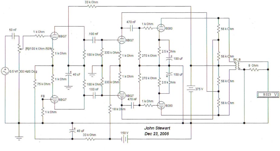

A while back I used what is left of my math skills to come up with a solution to the +ve FB question. All attached here. Actual measurements showed it to be never more than 1.5 to 2 db.
I tried OPTs with both 20% & 43%. For the 6AS7/6080 version the 43% solution was needed. The 20% worked but not nearly as well. The 20% solution would be OK for a pair of the 2A3 family.

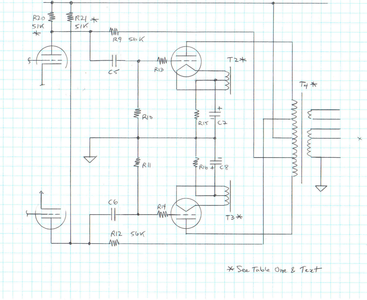

The next version I built avoided the UL OPT entirely. See attached the original hand drawn version setup for 2A3s. And another easier to visualize done with Electronic Workbench software & a 6BQ7 diff amp front end. This one wastes more of the output power in the bootstrapping connexion.
When dealing with the 6AS7/6080 one needs to be careful with the biasing. Each grid needs to be biased separately by cathode biasing. Otherwise thermal runaway is a sure thing. I found out the hard way. Otherwise a bias servo for each grid.
The THD result on the previous post had a pair of 6080’s as the OP. Running thru a special wound Hammond 1600 Series of 2150 ohms. I used a Pico Technology ADC-100 to get that result.

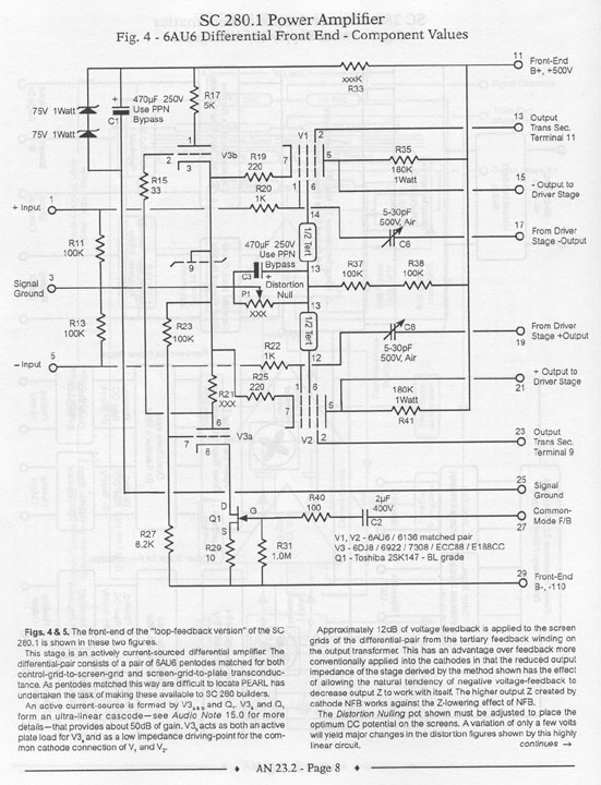

I also have a very similar amp design under construction using pentodes. The cross coupled local feedback goes to the driver tube screens. The cathode followers driving the output tubes are replaced with mosfets. Output tubes are TV sweep tubes.....not decided on which ones yet....or just which grids are being driven.
Pearl in Calgary did some of those NFB to input screens back about 20 years ago. See attachment. His stuff was top of the line. Same guy that marketed the tube coolers. The Cascode front end I posted is easily converted to a pair of pentodes. But would have to take into screen loading of the NFB network, both AC & DC. The cascode avoids that.

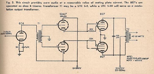

Class B Zero Bias, Screen driven pentodes were common with amateurs as modulators. 807s were plentiful. A few tried direct coupling. That lifts the grids off ground so there is less distortion. But the added B+ current was not popular for mobile work.
