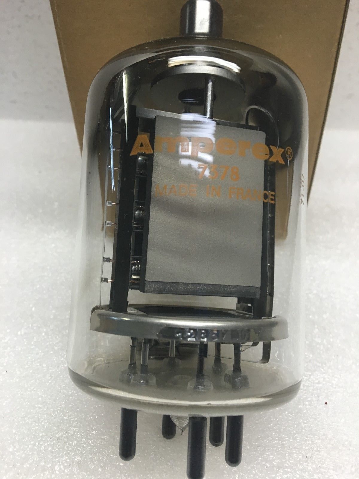

That QE08-200 looks better than the 7094 for sure, but looks like there is only one left on the planet for $90. Looks like it is internally built from 3 tube sections in parallel.
Might as well buy 3 x 36LW6, ..MC6, ..LR6, or ... other sweep tubes for 1/3 to 1/2 total price.
