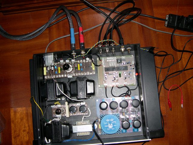

Audible hum on Kuei output stage
I have built the "ultimate" tube output stage suggested by Kuei Yang Wang. It has the following characteristics:
Tube: NOS Mullard E88CC
Anode load: 140H choke with 1400 ohm DCR
Anode current: 12 mA
Anode-Cathode voltage: 50V
Grid-Cathode voltage: -0.22 V
Anode supply: full wave tube rectifier EZ90, 220uF+20H+220uF filter.
Heather supply: 6.1 AC V RMS for both E88CC and EZ90 (they share the same transformer secondary).
At first listening test, the dac sounds good, but it has an AUDIBLE HUM.
I have tried several grounding schemes but did not succeed in eliminating that hum.
Have you any ideas to solve this problem?
Best regards.
Paul

Thanks Jeroen,
I am going to try DC supply for the heathers.
The filter is the anti-sinc proposed by Kuei Yang Wang in this same thread.
The choke (140H, 1400 ohm DCR) is model Z37 from "Elettronica Novarria" (www.elettronicanovarria.com) , here in Italy. It looks good and is cheap, but not so small...
Regards.
Paul

Hello Andrea,
I'll follow your suggestions, starting with DC heather supply because there is no spare space for an other transformer.
Do you have shields between supply, analog stage and digital stage? Do you think shields would carry any benefit?
The supply circuit has a 390 ohm resistor in series after the rectifier. "PSU Designer" simulation looks good. Do you think that 220uF is still too much for the first capacitor?
Ciao.
Paul

Ciao Paolo,
where did you connect the filaments?
They should not be left floating.
Usuallly rectifiers have heater tied to the cathode (but this is critical only with higher voltages), but in this case I think you should reference heaters to gnd (if they use the same supply - but I'd separate them).
If the series resistor prevents the tube from exceeding its maximum peak current (PSU designer gives a warning if it happens) you are OK.
I don't use shields whatsoever ;-) but a copper board with a hole for the socket and some slots to separate copper areas for the supplies (I use solid-state soft rectifiers and multiple C-R-C stages for each tube). Maybe adding a R-C cell per anode will help in your setup.
Cheers
Andrea

Thanks.
I have tied heathers to ground, but no effect on hum.
I am going to modify the anode supply this way:
1) No series resistor after the rectifier.
2) Lower value for the first capacitor (22 or 47 uF)
3) An RC net after the second capacitor, one for each anode (Andrea's suggestion).
Separate supply for the two heathers is a better solution but in the box there is no space for one more transformer. My plan is to feed the EZ90 heather with AC, and connect the same sec. to a bridge rectifier and a capacitor to feed E88CC heather. Is that a worthy solution?
Regards.
Paul

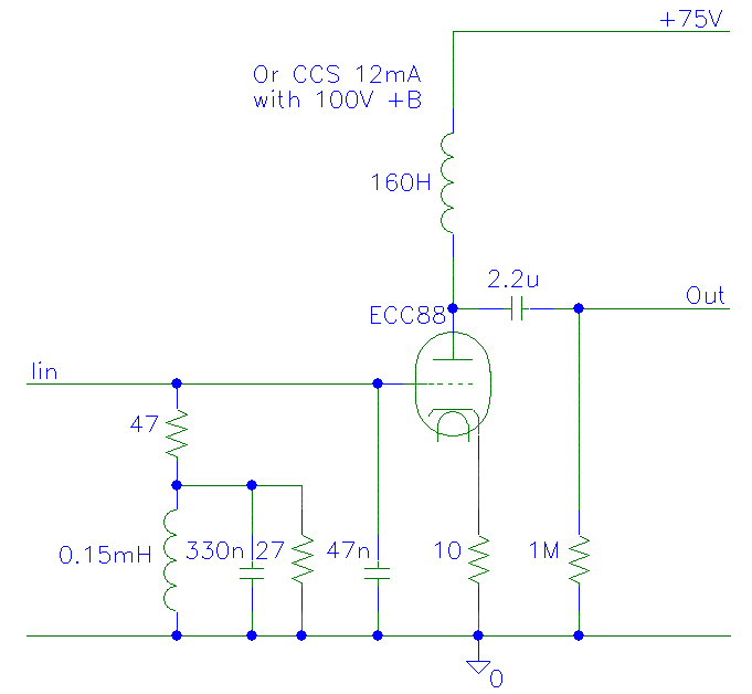

Thanks Carsten,
the circuit is the output stage proposed by Kuei Yang Wang in this same thread. Its input has a low-pass filter for frequencies above 20KHz, so HF signals are not supposed to enter the grid. Input impedance is very low, about 50 ohm. Moreover the grid never goes positive. Is a grid stopper still necessary?
Regards.
Paul

Re: Re: Audible hum on Kuei output stage
I have used a separate DC supply for the E88CC heater. Hum is still there.
The grid stoppers have not solved the problem.
What else can I try?
Best regards.
Paul

Hello,
here is a picture of the DAC I have built.
The analog section is on the left. From top to bottom:
- The KYW output stage with the E88CC. That yellow/blue wire connects to an external heater DC supply.
- The two anode load chokes (140H, 1400 ohm DCR)
- The anode PSU with the EZ90
- The transformer (90+90V and a single 6.3V) and the PSU choke (20H)
The digital section is on the right. From top to bottom:
- The digital board (CS8412 + TDA1541A)
- The PSU (regulated +-18V).
That floating wires are for experimental grounding.
It sounds good but has an audible hum and nothing seems to work to
solve this problem.
Help!!!
Thanks.
Paul

Hi Sándor,
I recommend the following:
1.) Disconnect the DAC from the tubes. If the hum is still there, it is in the tube stage. If not, there is a ground loop with the DAC.
2.) One end of the filament should be grounded.
3.) Inter-stage shielded wire is not always a good idea. Try twisted wire from UTP Ethernet cable.
4.) I would not put the AC socket so dangerously close to the analog stage.
5.) A good test is to disconnect the AC power from the three transformers one-by-one with a temporary switch (with caution, shock hazard!) for a few seconds, and see if the hum ceases.
do you have access to a scope?
If so give a look at the hum waveform and see if it is related to the PSU ripple.
The P2P assembly is way too big imho, and since we are dealing with mV levels at the tube's grids the AC inlet seems too close.
Try moving the I/V pcb outside the case.
It also seems that you used 2 shielded wires from DAC to I/V, how are the gnds connected?
If you only connect a single channel output does the hum stop?
Cheers
Andrea
PS You live in Milan or in the surroundings?
Cheers
Andrea
