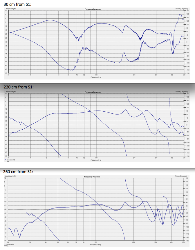

Internal measurements on the Thorn F1
I do would like to be able to set the crossover at about 150 Hz. Unfortunately there is a valley in the SPL-response there. I was thinking that if I can find the pressure minimum at 150 Hz that would be the place to put some damping in the pipe. Where the pressure is lowest the speed is highest why that theoretically would be a good place to start to work with the damping.
Let’s drill some holes and do some measuring.
My microphone i 8 mm in diameter and thus I bought a bach of wooden dowels in the same size.
I sealed evry hole with filler and not glue in case I needed to redo some measurements. Then I have to pull them out again and glue them propperly if am going to keep this box.
The measurement rig.
Closing up on the mouth of the horn.
All measurements done
The first SPL-curve at position 10 cm from S1 (beginning of the horn).
All measurements in a pdf-document.
/Forsman

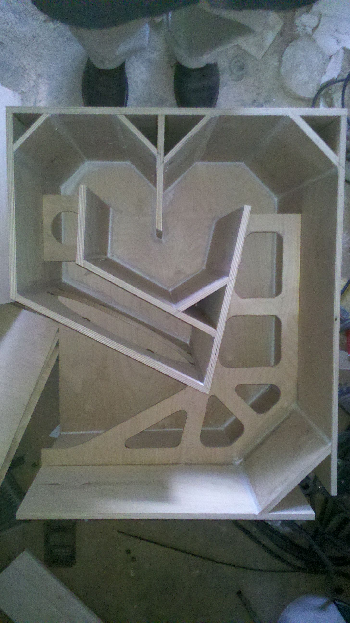

Here are some pitctures from the building of the Thorn F1. First som cutting of particle board in my back yard.
I found it pretty useful to do a 1:1 drawing of the horn on one of the horn sides. That made the rest of the build much easier when it comes to fit pieces and drill holes at the correct places.
Cutting the hole for the driver.
Starting off with the internal structure.
When you have drawn where all the pieces are going to be, it is very easy to pre drill holes for the screws. I don’t think it is necessary to use screws when you glue it together but the assembly gets a lot easier and doesn’t require as many clamps.
Some bracing and “baffle” in place
A simple and easy way (Q&D) to fasten the driver. I don’t think I would recommend this sulotion for permanent use. At least not without proper washer’s…
More bracing.
Time to put the last side on.
I used Polyutherane based glue which I think is excellent for this kind of wood working. It expands and creates nice foam that seals any cracks or bad fitting between the panels. One should be very careful with getting it on the skin because I stains the skin and is impossible to get rid of.
/Forsman
My blogg: DIY Open Source HiFi

Forsman,
What a great measurement idea!
So interesting to see the progression of amplitude, phase, and frequency response in your TH.
By half way through the horn, looks like things don't change much other than in the upper out of band frequencies, other than inverse distance amplitude reduction.
Seeing that the throat SPL is some 25 dB above the mouth pressures gives some real insight to the problems encountered with cones not strong enough for the task.
155 dB is also enough to get in to levels of air non-linearity.
Was the microphone flush with the cabinet wall, or some distance in towards the center of the horn?
If flush, the throat SPL may be be even higher.
It would be interesting to see a measurement with the mic directly at the cone center.
Did both the 10 cm and 20 cm measurements get lost?
What was the approximate SPL of the "0 dB" line on the graphs?
Thanks,
Art

Thanks Brian and weltersys!
This kind of fold also enables you to make L45 a bit longer if dezired. In my case I like that because I think it helps filling out the 150 Hz dip a bit and extends the bass response a few Hz.
The Dog Food Duct is interesting. I have tried something similar but not with the same great result as you have. I will get back to that experiment soon.
The microphone wasent flush. I have inserted it about 7 cm.
I shall see if I can get the measurements from pos. 10 and 20 Cm from S1. Do You want me to take a measure at the cone center position too?
I am not sure what the "0 db" level is unfortenutley.
