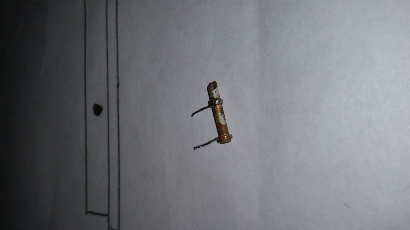

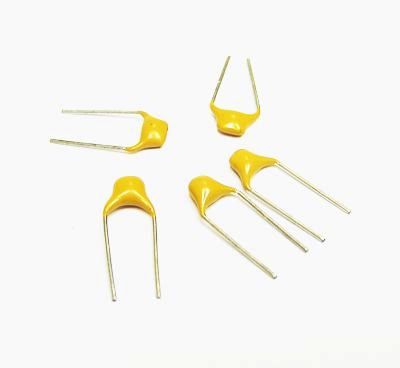

Could I replace C7 with the ceramic capacitor?
For the static DC tests we are doing now you can remove C7 altogether.
That's good then, it sounds like C7 really was faulty. Now whether anything else is faulty remains to be seen.
Do you have any small caps like the 100pf C7 ? Its value isn't super critical and I would think anything around 68pf to perhaps 470pf would work OK. We could see how it all works without even fitting C7 if you haven't got one.

Could I replace it with 100pf like in the photo?
Perfect.
