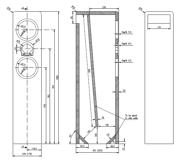

Just to tie up a loose end, Planet10, I used the published SEAS Thor data:
Thor
In other words not the OP's cabinet. And as Joe's measurements inadvertently show, the original Thor cabinet is really only good for a single midbass.

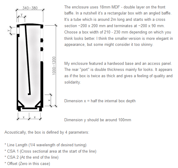

Only in that you must have missed the Clairty on the SEAS Thor thread.
Joe blew the TL in the original Thor design, SEAS measuring it down to 100 Hz, and Joe, when he measured it, effectively measuring it with a single driver to confirm its performance.
In the afore mentioned thread 3 new TLs were developed to fix the problem... this enclosure is, i believe, one of those 3.
dave

My assumption is its the original design, that only only suits
one Seas driver well, a mistake, but that doesn't matter as
the Dayton MTM will suit the cabinet better anyway.
Based on what evidence ?
Because i am pretty sure they are these FAT Thors.
http://www.diyaudio.com/forums/swap-meet/221396-fs-seas-thor-fat-cabinets-100-litres-1500-obo.html
The OP can confirm
dave
And here is the guy who ended up with the drivers & XO
http://www.diyaudio.com/forums/multi-way/64799-clarity-seas-thor-kit-110.html#post3238108
dave

The 60L SEAS Thor Cabinet was designed for a driver around Qts=0.32. It works, very nicely. Joe knew what he was doing.
The W18E001 is a late substitution, for reasons I really don't understand. That needs 100L as any fool can work out.
My own suggestion, the ER18RNX happens to work perfectly in 60L too. Am I good or am I good?
